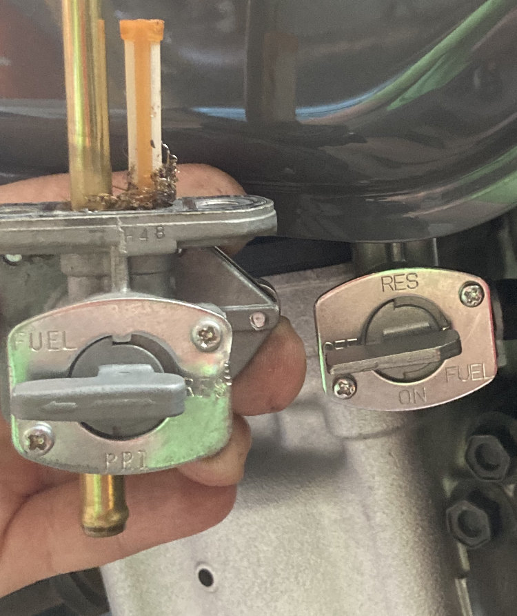

    Yes, i deleted the auto feature of the vacuum operated petcock.
    as you’ll see, the old one on the left has “on” “reserve” and “prime”
    prime is used only for draining of the tank, OR if you need to prime the carb after emptying it to clean it, install a jet kit, or after rebuilding the carb.
    otherwise, it functioned on the “on” position until you needed to use reserve, which means its time to get fuel.
    Now, my new one will only have on, reserve, and off. It will live in the off position unless the bike is running, and when I have to use reserve, I will need to get fuel immediately because the range was greatly diminished since the reserve tube is much closer to the regular pick up tube now. No big deal, i can always tip the bike over to the left side and put all the fuel in that side of the tank, and then beat feet to the gas station or back to my gas can

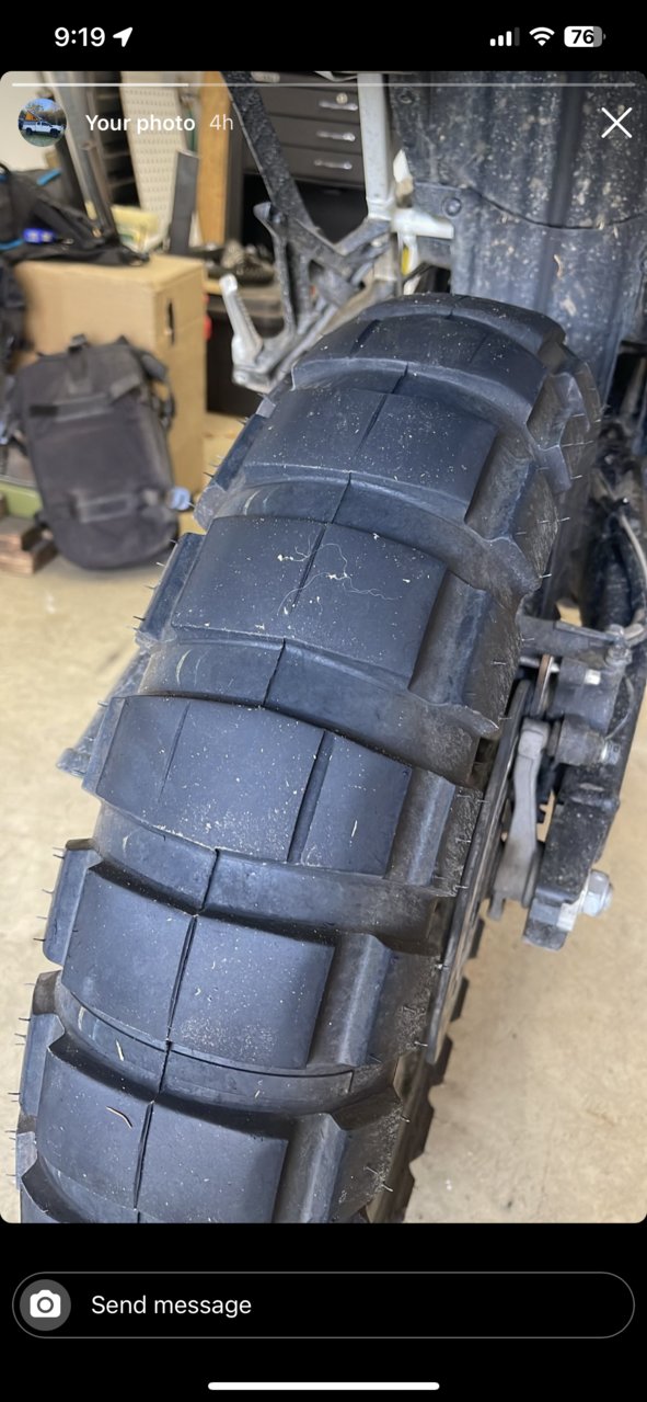

    I need to rebuild the rear brake system.
    Rear caliper and rear master rebuild kits. Maybe a new rear tire. And an oil change. Then i should be able to throw down again…might just burn down the rear tire I have first….
