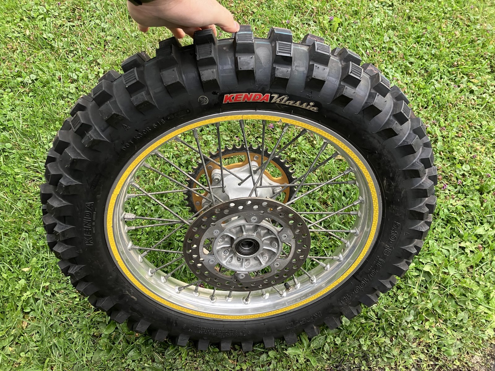

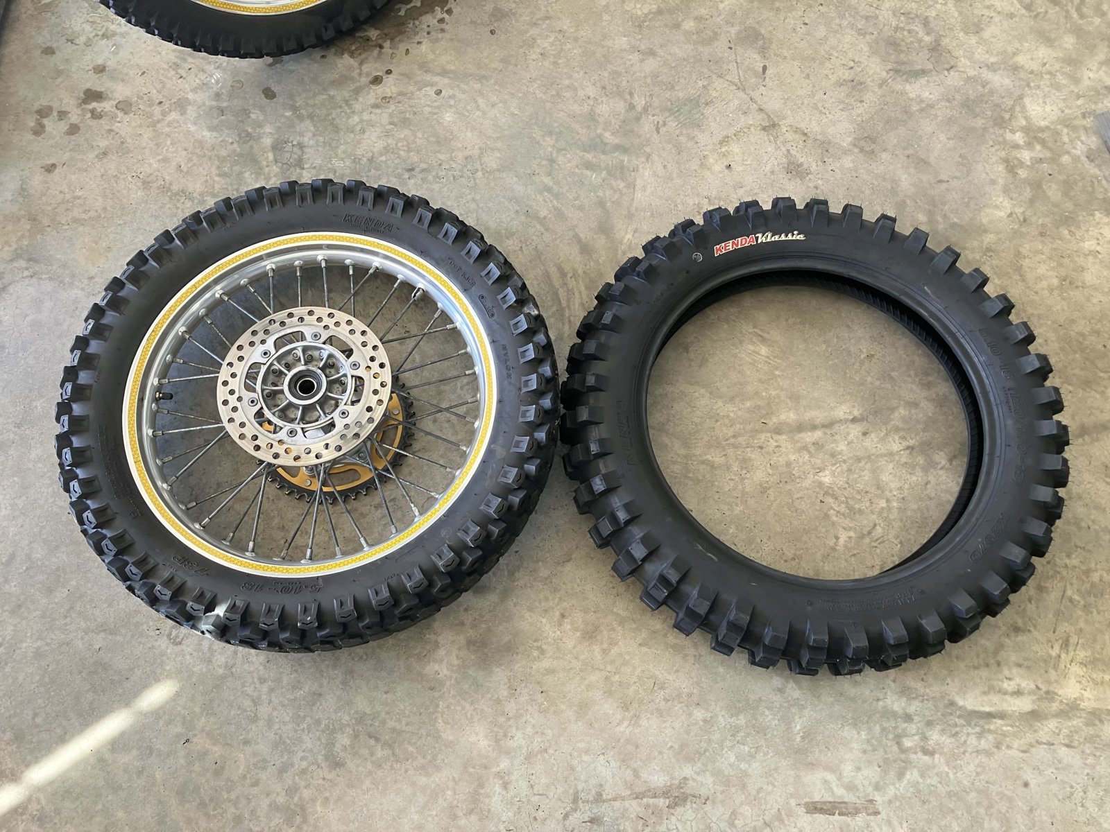

    After about 109 miles this past weekend, i have come to realize my rear brake is gone. The piston froze in the master. So, i’m soaking it in an attempt to clean the bore out and install a new piston with new seals. I’ll flush the rest of the rear brake and see if that fixes it, if not, i’m ordering a whole new rear caliper and master.
    Also, smoked the rear tire again, so a new one is about to be installed and balanced:

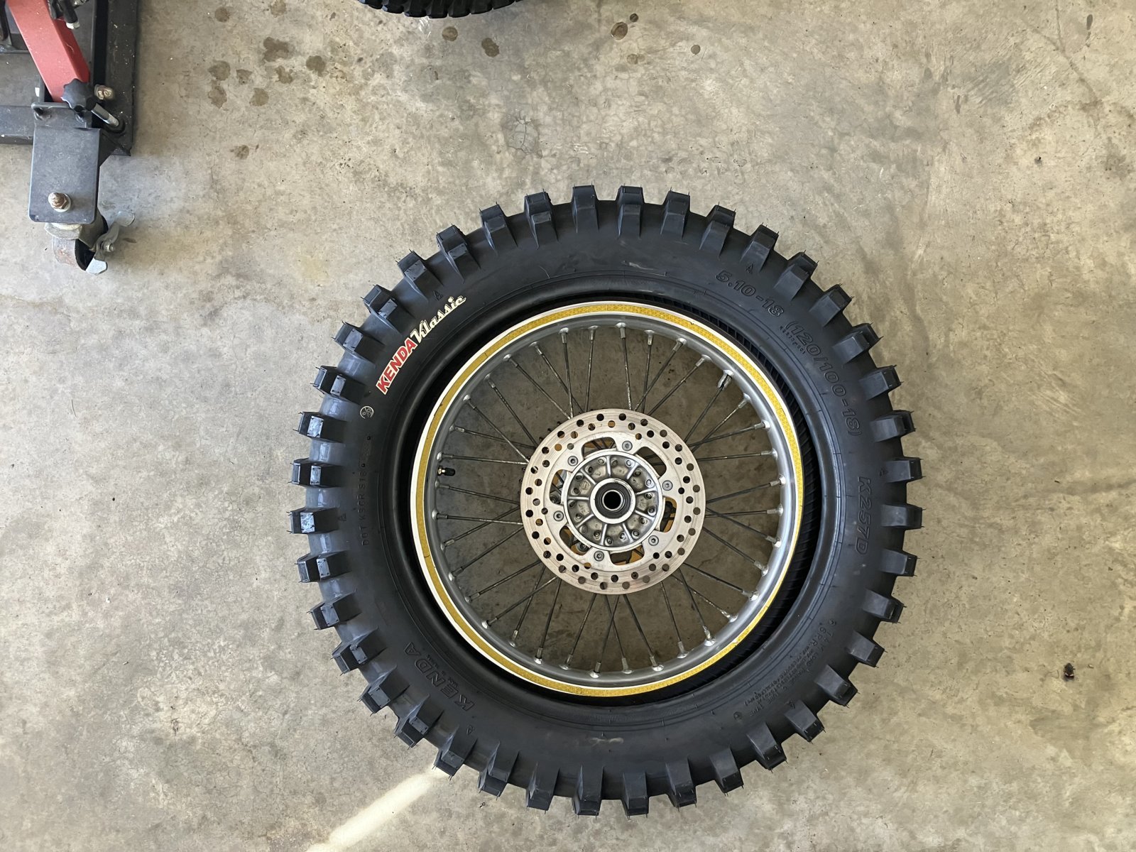

    Rear is on and the rear master is rebuilt. Hallelujah I have full brakes and safety equipment again!!!
    It does look kinda dorky with an 80/20 on the rear and a 50/50 on the front :rofl:

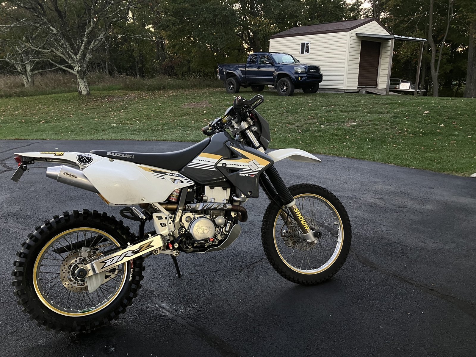

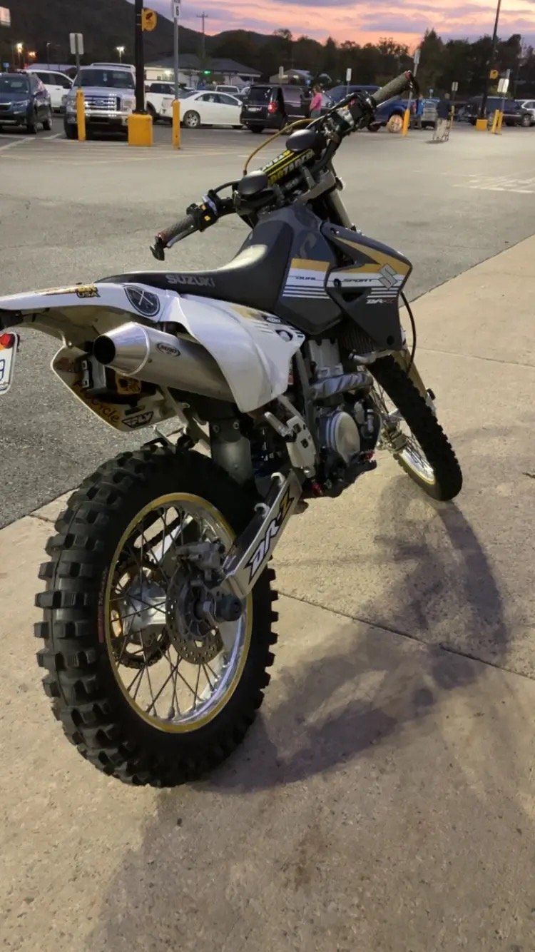

    Rode another 70ish miles last night, brakes working GREAT:
