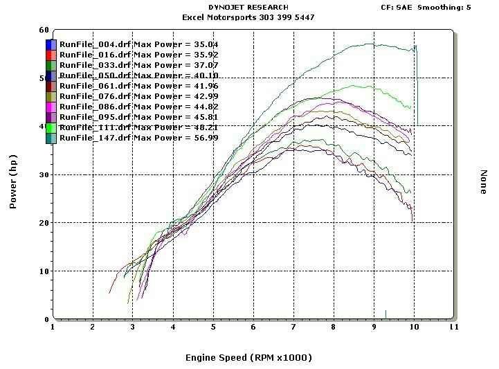

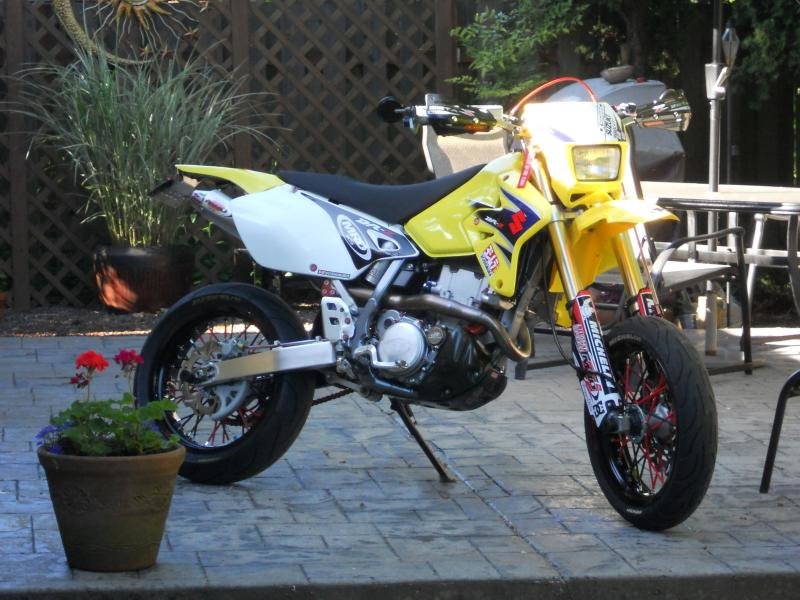

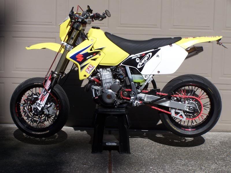

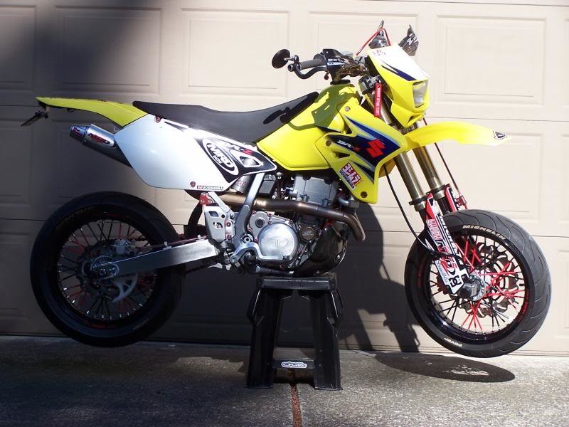

    DRZ with the MRD,39FCR, big bore and hot cams will do 48+ hp to the rear wheel. mine dyno'd 48.83 to the rear wheel and was loads of fun. MRD is loud even with the insert and is ear bleeding loud without. LOL I miss mine just got rid of it. To many crazy people on the road anymore.
    Make sure you go to Thumper Talk and do all the lock tight fixes you will thank me later. I have done about everything to a drz, so if you want names people or ideas PM me have a list of vendors and friends still into DRZ's

    Looks good Dan. Did you split your base gasket to up compression? Thumper Talk is your friend, Eddie Sinerceros (sp) is the DRZ God. He built my head when I upgraded mine. I've ridden all sorts of bikes on and off road and this is prolly the most fun of all them. I still like to blast the woods, but have a different mount for that purpose.

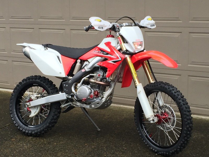

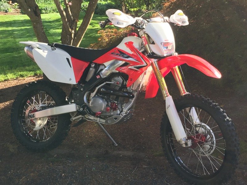

    split base gasket like on the real E's. Yes sir no more road riding but I have a blast in the woods with this one:
    I just can stay away from bikes.

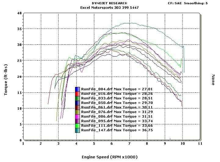

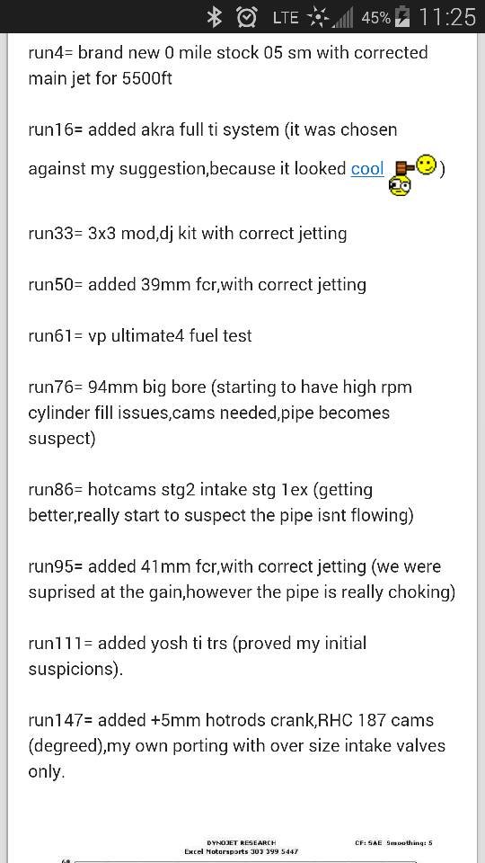

    Nah pipe and carb are needed for 40. Heres some dynos from eddie himself. The stroker build is sick!
    the drz is a great machine, does everything well and near bulletproof even if it isnt the greatest at one thing. :cheers:
    Nice! I bet that power was fun! Keep posting the info, ive read a lot and been giving him info as well but more is always better
