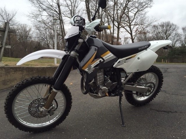

    Nice Bike....Looks familiar...........Here's mine.

    Settled for the $170.00 DG slip on with my own jetting changes.

    My approach on this bike was "budget build" focusing on dropping weight wherever possible. I'm mostly off road. It'll never be a KTM, I've had plenty of those, but it works quite well if you drop some weight and play with the ergos. The pipe adds off idle snap and fatter jetting also adds to it. The headlight is a polisport halo; direct plug and play. Output is not that great but I like the look and it weighs about 3lbs less than the stocker. That's a lot of weight to pull off your handlebars which can be felt immediately. Turns signals are TST Industries which are direct replacements for the front. At $15 a set I took a chance on fitting them in the rear. Worked out fine. Topped the signals with a TST Industries flasher; again plugs right in. Whole Signal/Flasher deal cost about $50.
    Bigger tank? I've had the IMS 3.2 added to the "cart" an several occasions but keep bailing on it. It'll happen. Probably go black and change to white shrouds if you can picture that.

    Stock seat; Tusk Bars with Tusk risers
