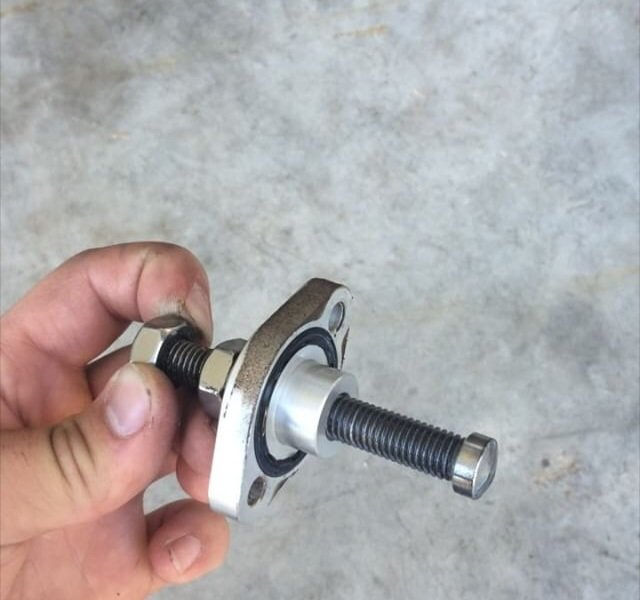

    Did some of that long awaited maintenance i posted about earlier...
    Failed mcct:
    Old MCCT vs New MCCT:

    did the seal fail? im a newb when it comes to anything with two wheels, but that part seems okay
  20. Jul 17, 2016 at 2:56 PM
    #1320
    AR15xAR10
    AR15xAR10 [OP] AR10 is 5 ARs better
    Apr 13, 2013
    #102024
    57,040
    2013 TRD Sport 4x4 V6 ACLBFTMFW
    The old MCCT (manual cam chain tensioner) had just a large o ring on the main hole. That is what failed and was causing oil vapor to leak all around it which in turn was making dirt cling to it for me to see.
    The new MCCT had an oem gasket that covers both the main hole and the two mounting bolt holes (this means no leaky). However, these oem gaskets can fail too. But i can get the gaskets for like $3....
