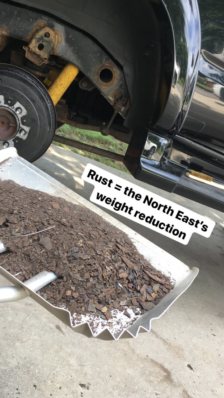

    Spent about 6 hours cuting out, scabbing and plating the frame last night. We just about have it whipped. Its a lot of work but i’m very pleased with how its tightening up.
    Next step is undeecoating. Lots of it.

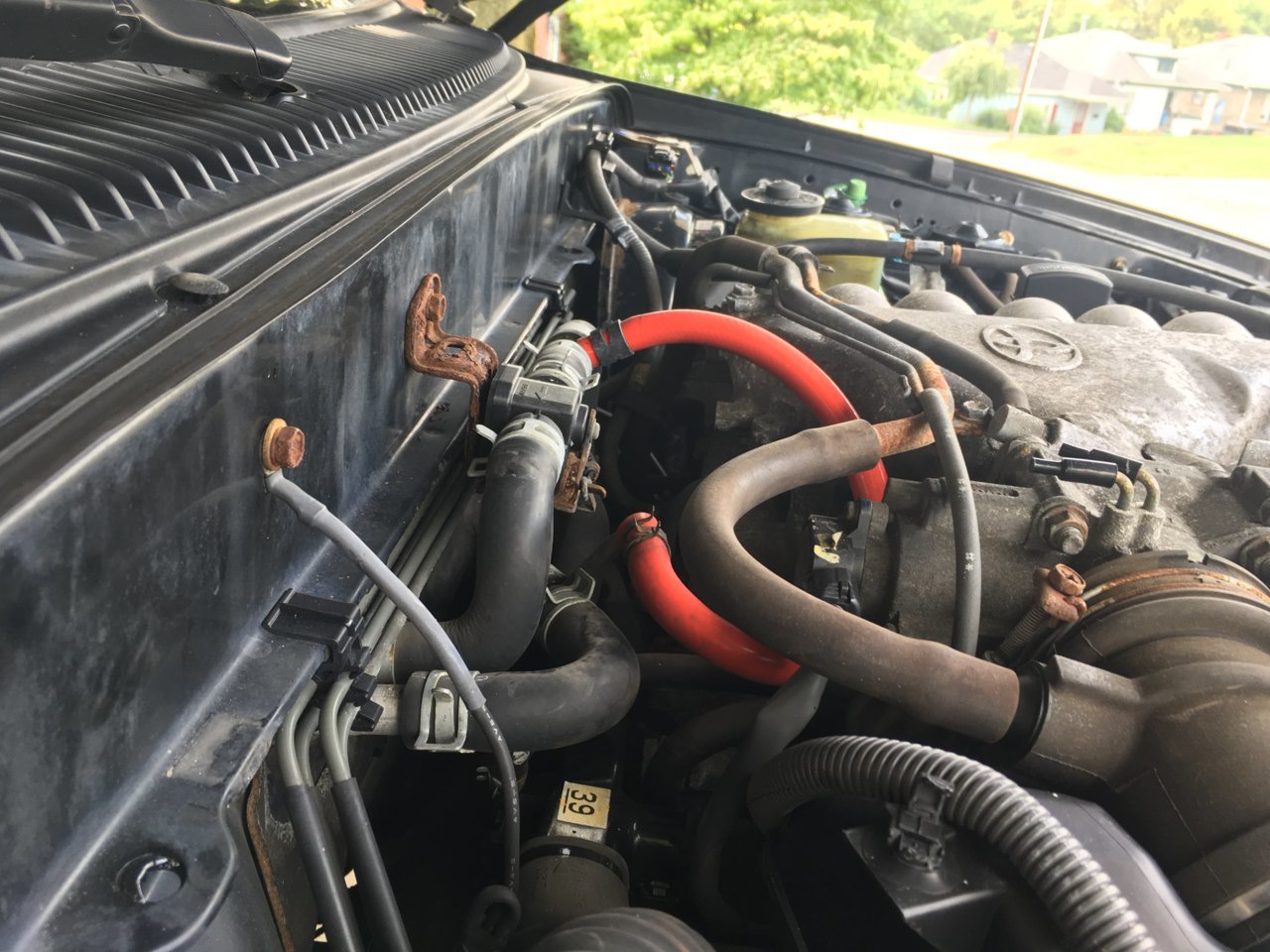

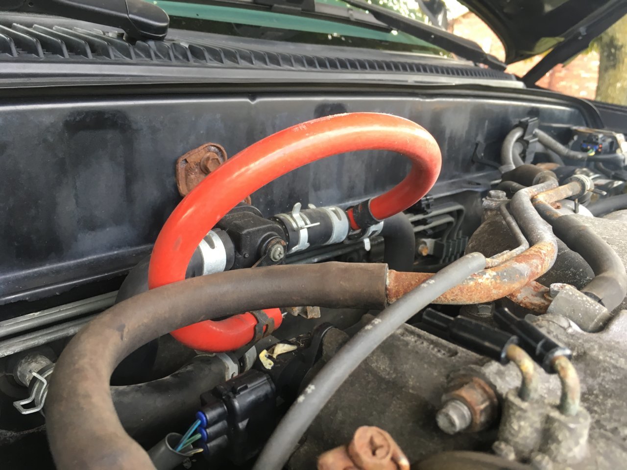

    Looped the rear heater core lines to themselves since they were leaking so bad.
    Looped the lines to themselves under the truck too. Seems to be a viable sollution for now.

    Going to start cleaning and descaling the frame tomorrow. Ordered a quart of POR 15 to coat the frame on this pig.

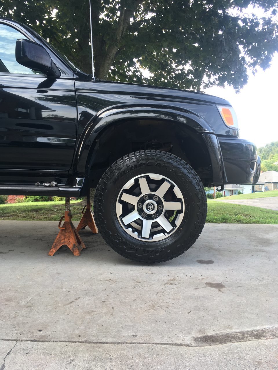

    Today i descaled the frame with wire brushes, removed the old sawed off power steering lines, fixed the fan shroud, and test fitted my mom’s wheels/tires.
