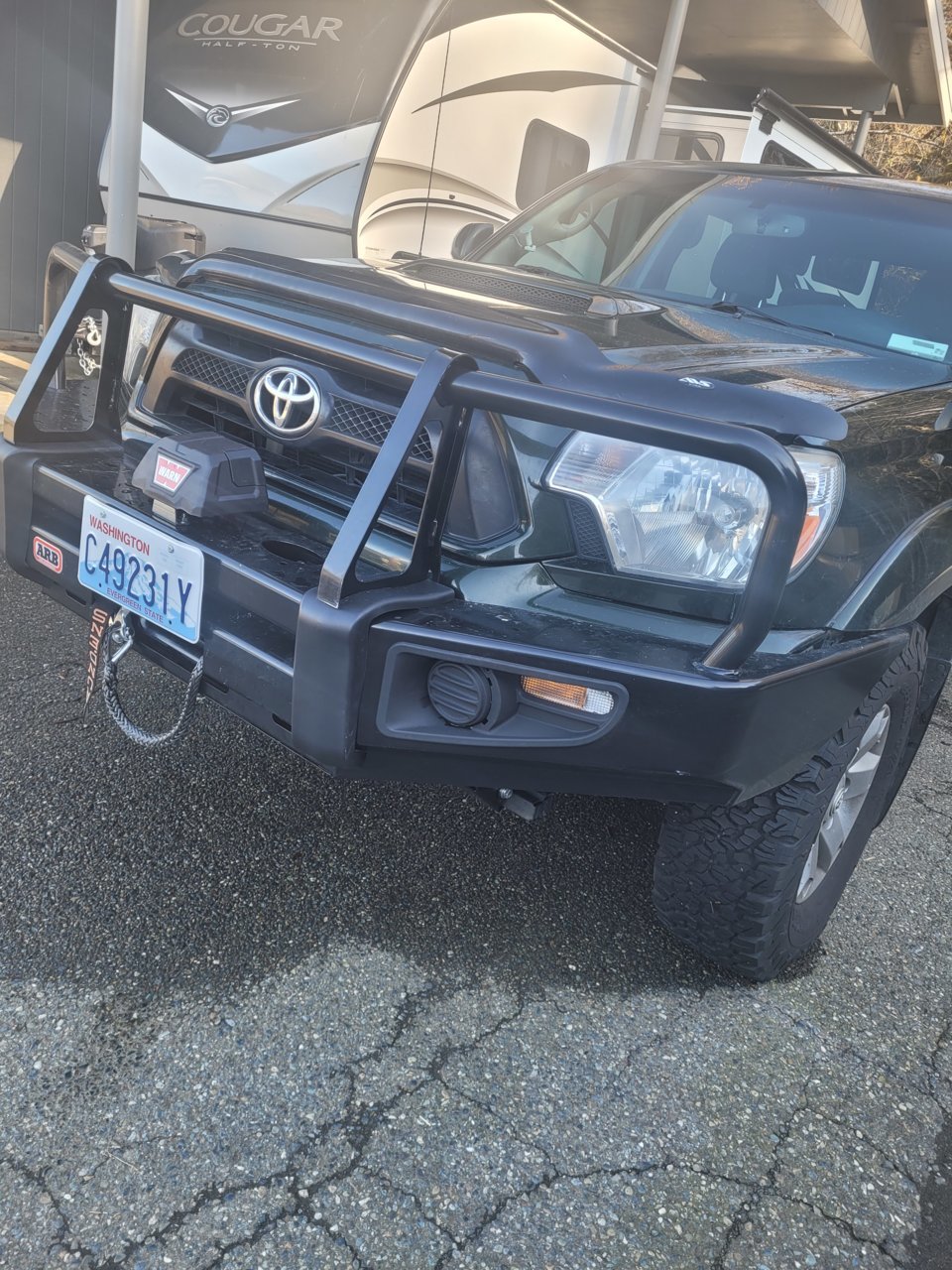

    Thanks, I believe I can make it work with an offset fairlead and maybe a spacer and by rerouting the control box. Do you know if you can clock the apex? I'm also considering the warn evo 10-s.

    20220322_162620.jpg Thanks guys. I went with the warn 10-s as well and for the most part it was pretty straight fowrard. Not a perfect fit, but it works. Was a fun couple of days between the bumper install and throwing the winch in.
