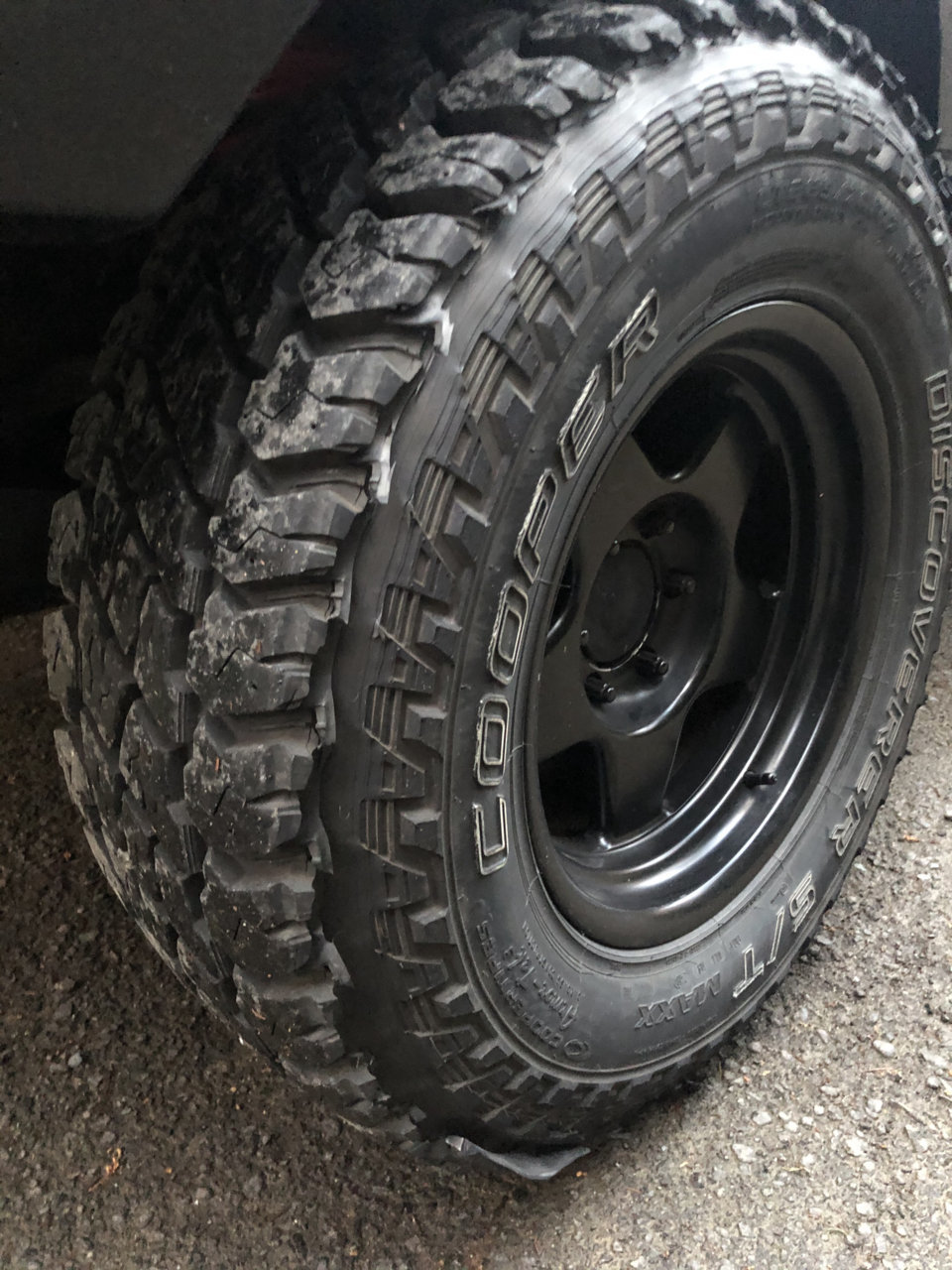

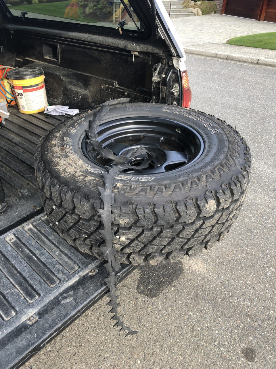

    Man I wish I would have cut my bumper the first time this happened! Apparently hit a bump too fast this morning and stuffed the tires into my ARB. It peeled a nice rubber whip and took out my driver side mirror. Luckily I had everything I need to replace the mirror!! Today started as a frustrating commute but I couldn't help but laugh every time I saw the kittens with bowties.
    I'll be cutting the bumper soon!

    auto tire groover!

    Wow, that tire was peeled purrfectly and luckily the mishap didn't end up being more catastrophic.:anonymous:

    now you have fresh new sidewall lugs right?
