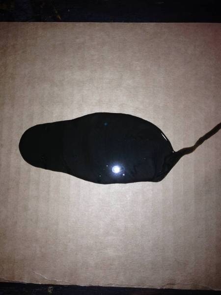

    OK, here's a pic of the oil out of the rear diff. It's on a clean piece of cardboard. It looks more black than grey today, guess its had time to settle. Anyway, I have since flushed the rear diff along with the front. I'm going to drive it a few days and check it again...keeping my fingers crossed. Note, this oil has only 2k miles on it...

    Im curious on how you did the gear install as it sounds like the gears aren't set totally right.
    1. Are they new gears? Or the old stock ones? If new, discoloration is normal. The coating gets worn off. In originals. A small amount is okay because chances are you didn't get it 100% back to where it was. A lot out of the stock gears means there could be an issue. But a little is normal because the gears have to re wear. That's why you change the oil at 1500. With new gears it's even sooner.
    2. You use a new crush sleeve for the pinion or better yet, upgraded to a solid spacer? You should reuse the stock one ever.
    3. The lockers aren't perfect matches to the stock carriers so all the backlash and pinion depths need checked and adjusted. I'm assuming you did this?
    Not to sound condescending or anything. Just asking for more info.

    My oil was not discolored when I installed... but it was a used locker on original gears. To me, your oil really doesn't look bad at all. (Maybe it's my computer screen) I would think that any freshly machined part will let some fine shavings loose. That being said, did you check your pinion depth just to be sure? (How do you know that it was correct to start with?) You can always just drive it for another 3-5K miles and dip my finger in there to check it periodically.

    It's probably just the new bearings breaking in a bit then. I bet your fine. I agree the oil doesn't look bad in the photo.
