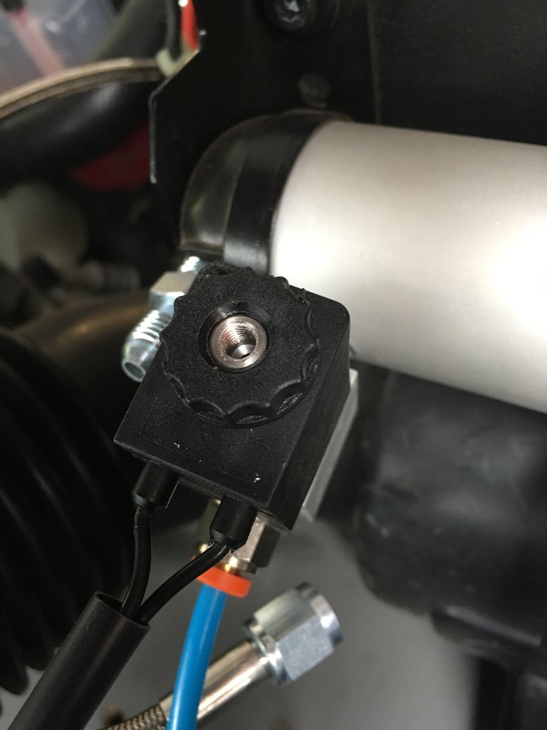

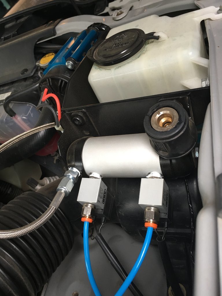

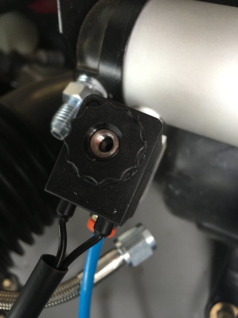

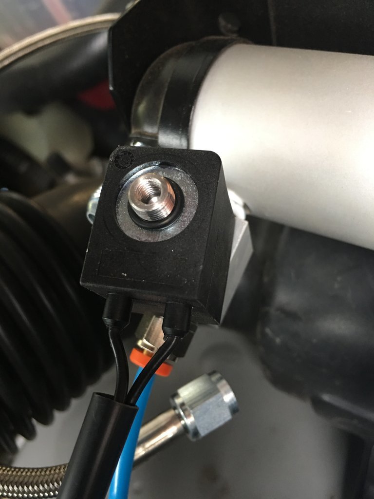

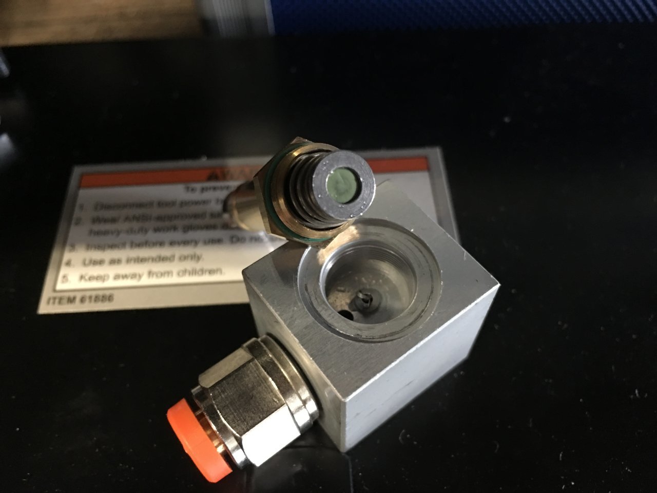

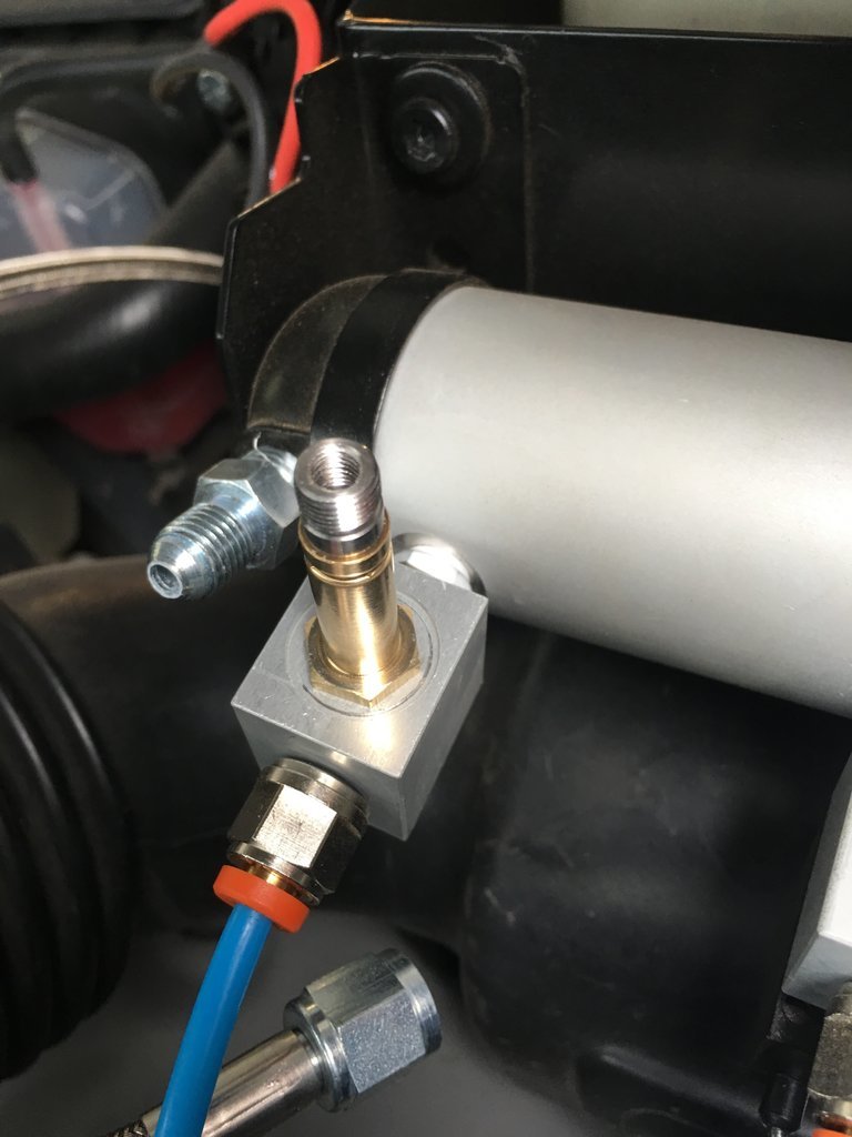

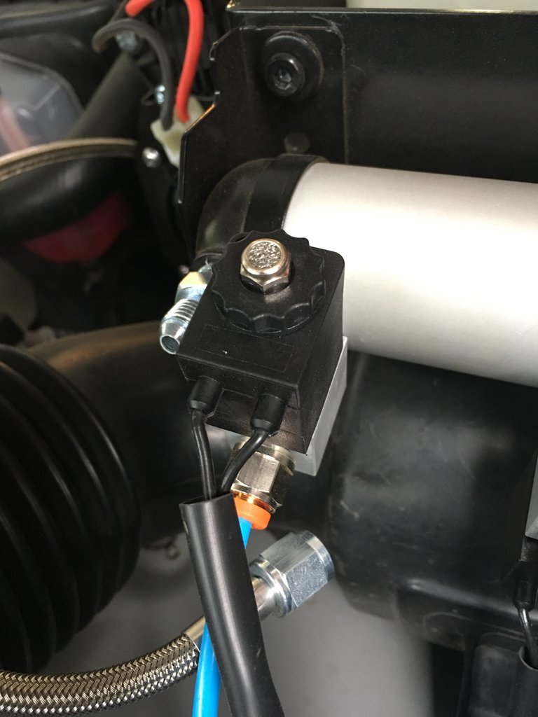

    I'm diving into the same issue with my new setup. I ended up having to troubleshoot on the first section of Signal Peak near Truckee, CA this weekend...not the best trail to have locker issues.
    My compressor started cycling every minute, then every 30 seconds....then every 5 seconds. I believe my solenoid either needs adjustment or has debris in it.
    I'll try and post some pics with my fix, I have read on many other forums of people having ARB solenoid issues...hopefully mine just needs Adjustment.
  17. Jul 4, 2017 at 9:16 AM
    #37
    mjohn617
    mjohn617 Well-Known Member
    Mar 15, 2010
    #33314
    832
    Petaluma, CA
    05 DC TRD sprt silver
    Haha...not doing it...can't make me!

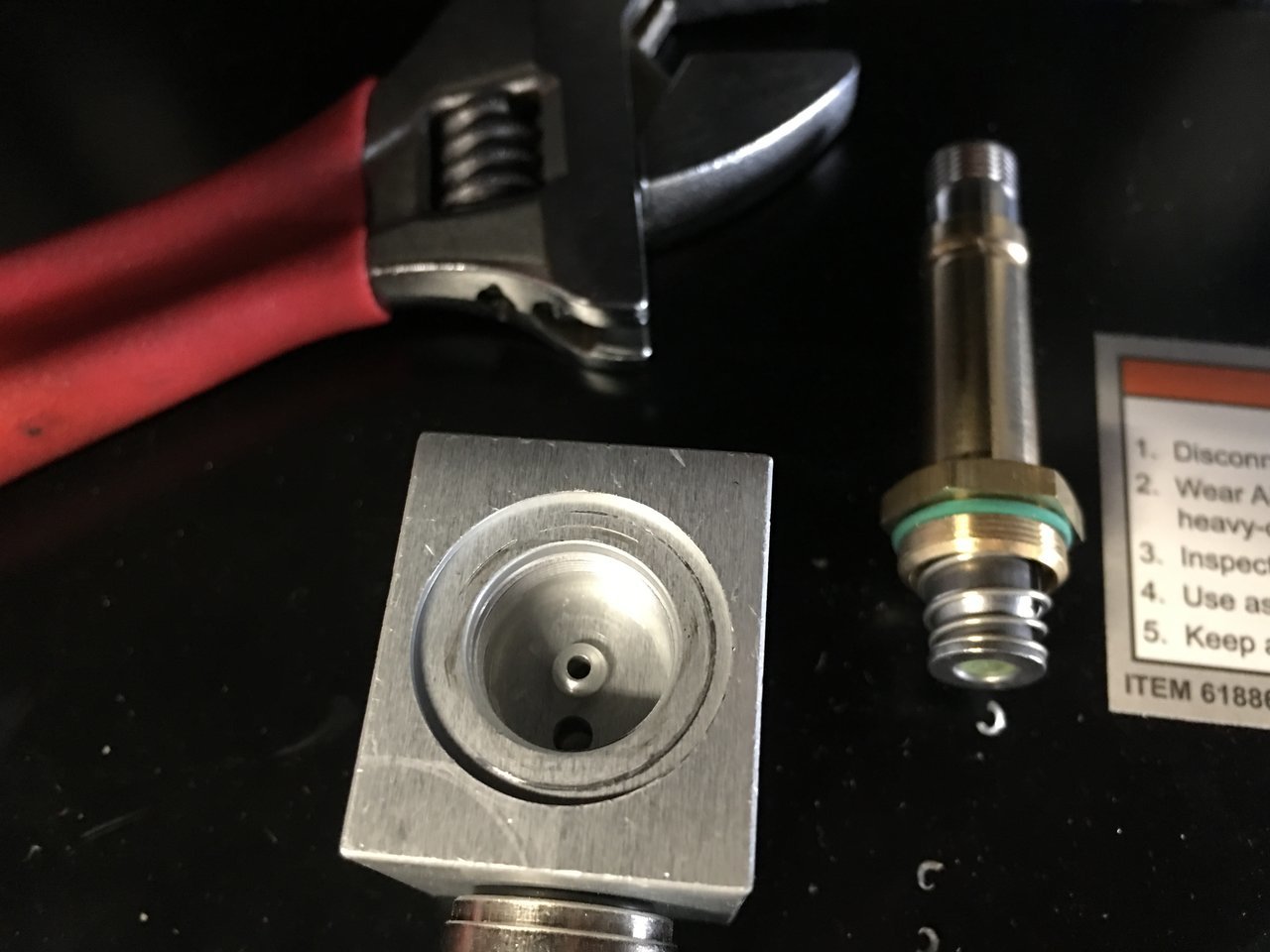

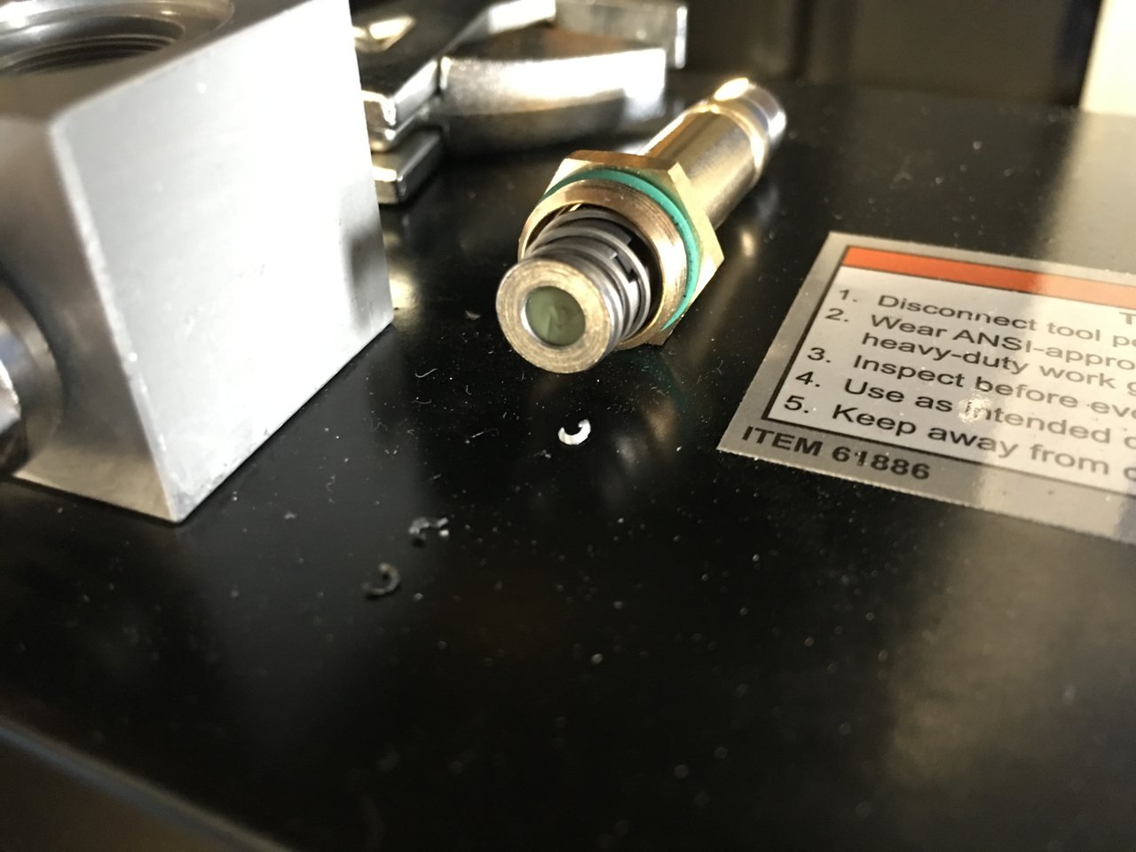

    Looks like my issue was from the machining process when the solenoid was made, not too happy to find crap like this in a system that I paid top dollar for....this is why I am willing to pay extra money for a quality product, or so I think. I posted some pics of the solenoid being disassembled for anyone in question on how to adjust and clean them.
    IMG_9082.jpg IMG_9083.jpg IMG_9084.jpg IMG_9085.jpg IMG_9086.jpg This O-ring might be a good item to keep in the toolbox.IMG_9087.jpg IMG_9088.jpg There lies the issue (ABOVE/BELOW). Looks like tailings from a CNC machine, just the right size to block the pintle from seating.
    Put everything back together, no leaks...GTG.

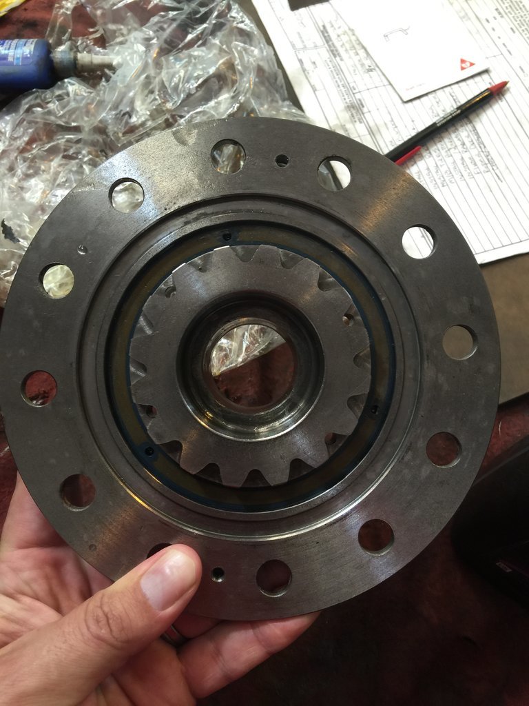

    New O rings didn't fix my problem, but I finally found the issue. There is an internal seal on the end of the locker (pic). Apparently their was some debris in the locker from where it was machined. That nicked this seal and it obviously wouldn't hold air. ARB sent a entire new end to replace it. It has worked well for over a year now.
