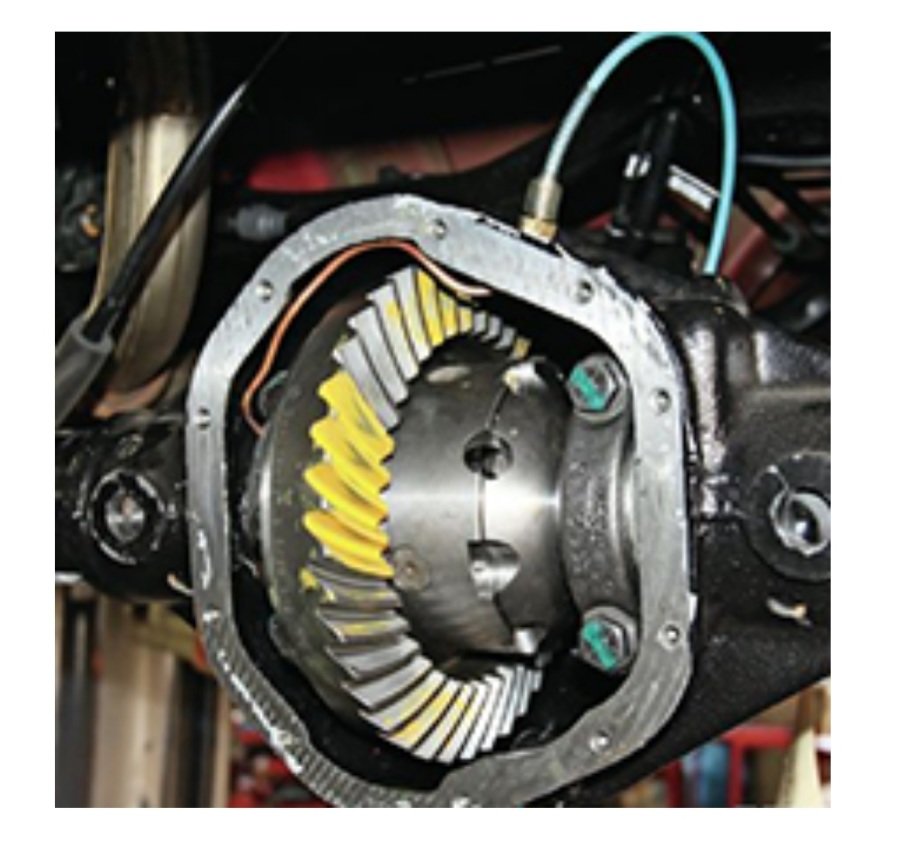

    Hello guys I’m new to this arb air locker. I went out last time for first time to try it out just got it back from the shop. I tuned on. Air compressor than air locker but the air compressor kept running. I can hear air coming out of Hose is around top of the rear diff is that hard to fix I’m going take it back to the shop Monday

    It's either leaking from a pinched copper line going to the bulkhead or by one of the seals in the seal housing. Those are really the only two places it'll leak inside.
