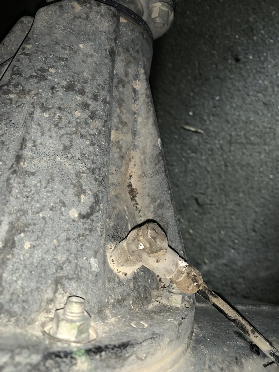

    Confirmed its my rear locker solenoid.
    Diff Breather looks fine.
    Did you ever install that turn valve?

    Here is my bulkhead/banjo bolt. Would I need a female/male valve?

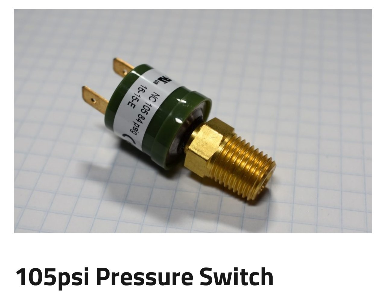

    One of the issues may be the twin arb compressor is 150psi. I'm fairly certain the o ring seals in the arb locker bulkhead cannot hold this pressure, I'm not even certain they can hold 100psi. If the o rings fail, gear oil is sent up towards the solenoid.
    It would be wise to put in a pressure switch, perhaps even a 60-75psi to see if the locker engages at lower pressure so as not the blow by the o rings. The pressure switch would go on the manifold (or tank).

    I have a single and it came with a pressure switch :notsure: I think they just made a shit product.

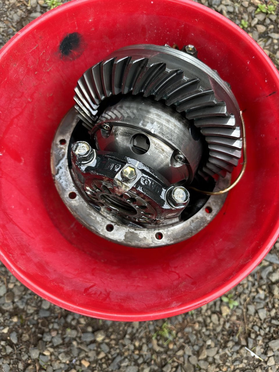

    Truck is currently on jack stands with the diff in a bucket, if that tells you anything :rofl:
