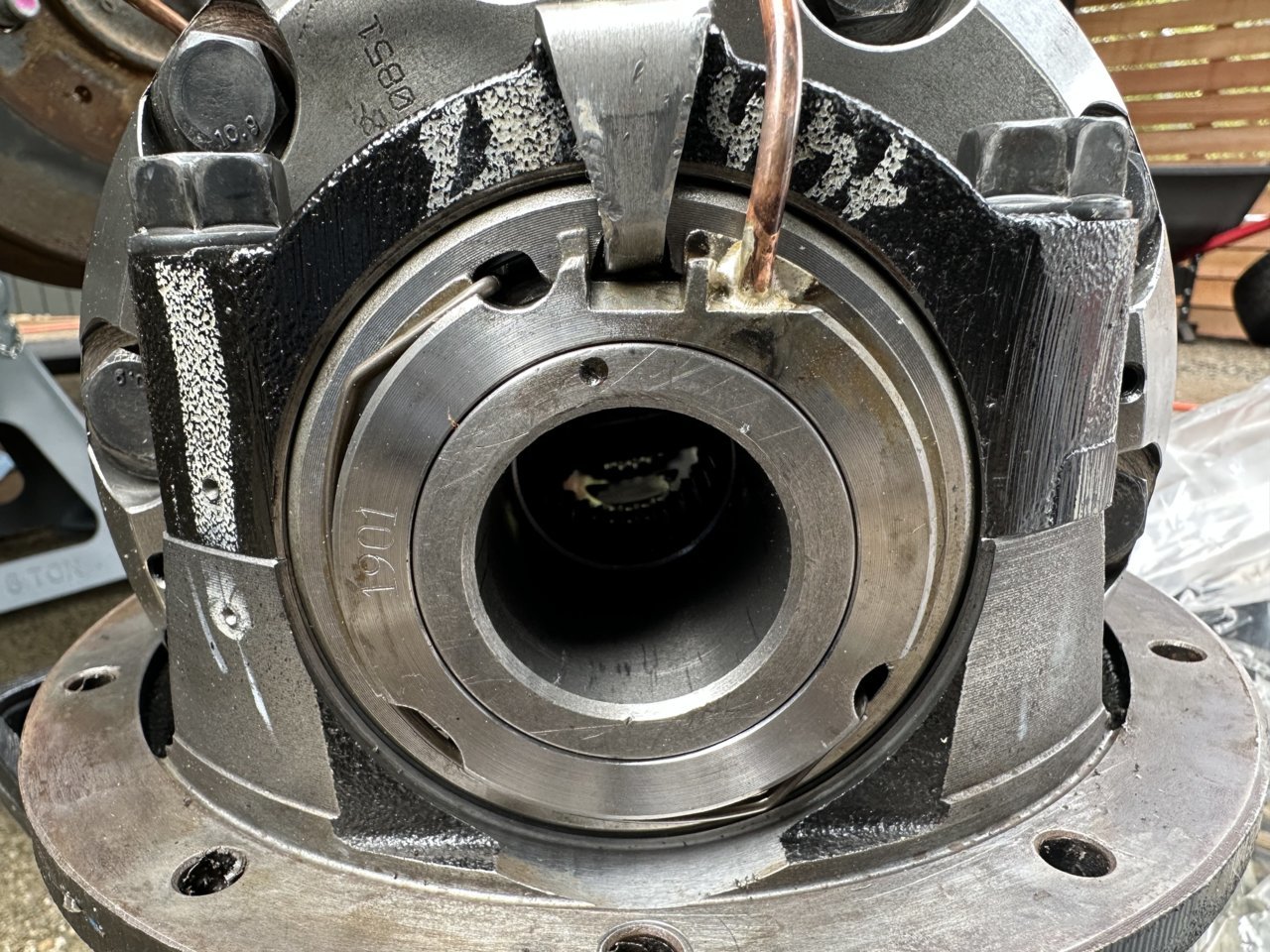

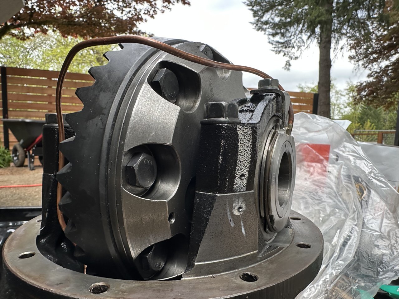

    Confirming everything ARB instructed me to check for:
    - Brand new seal housing
    - Brand new bonded seals
    - Copper hose does not contact diff
    - Copper hose is brand new w/ no holes
    - Tab does not contact the seal housing
    I’ll give it a shot without my ball valve installed. Still highly likely I’ll wake up with gear oil all over the driveway within the next month or two.
