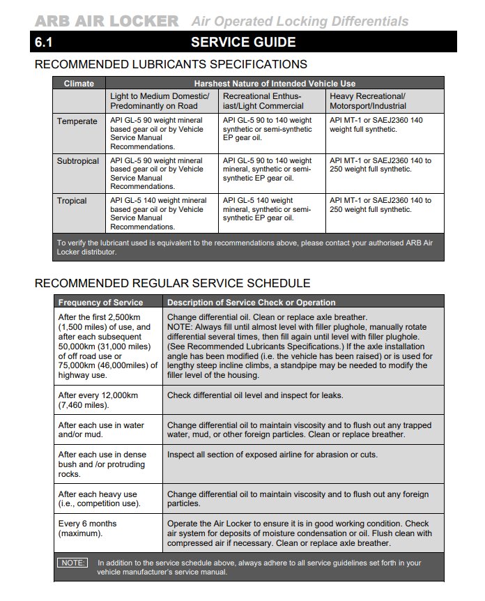

    Here's an ARB spec sheet I pulled off of google...take it with a grain of salt since we don't know what application it's based on. I think any gear oil without the LS additive will be fine.
    https://www.arb.com.au/assets/air-lockers/6-01.pdf
    I've got e-lockers and have used the fluid you posted above as well as the 85w-140 that ECGS recommends. I haven't noticed any performance or sound difference with either one. If you want better advice you could call up a gear shop like ECGS or ARB directly.
