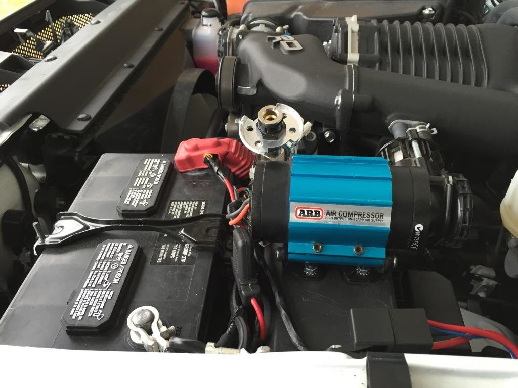

  2. Apr 21, 2015 at 6:10 AM
    Wheelspinner
    Wheelspinner Coco Customs
    Jul 6, 2013
    #107741
    4,370
    Steve
    Northern NJ
    '13 4x4x4cyl
    Driver side inner fender. Between the fuse box and the fire wall there's a nice flat area

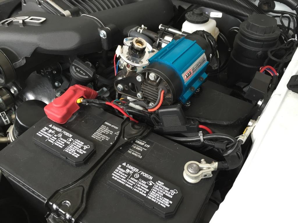

  3. Apr 21, 2015 at 11:04 AM
    Jefes Taco
    Jefes Taco Well-Known Member
    Mar 28, 2014
    #126413
    2,666
    Denver, CO
    14' DCLB TRD Sport supercharged
    On top of the fuse box. I have the SC and the intercooler coolant lines and reservoir are in the way of placing it in the above mentioned area.

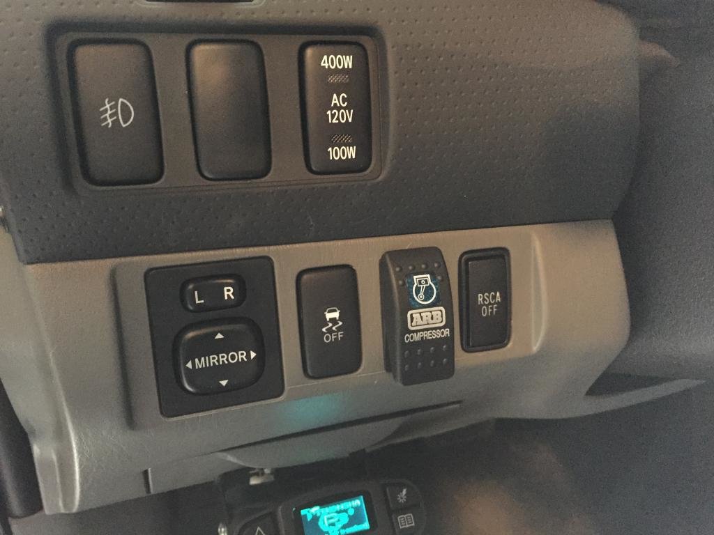

  6. Apr 21, 2015 at 6:23 PM
    Jefes Taco
    Mar 28, 2014
    #126413
    2,666
    Denver, CO
    The obligatory switch pic. :eek:
    The locker switch will go in the same blank as where a factory locker switch would be.
