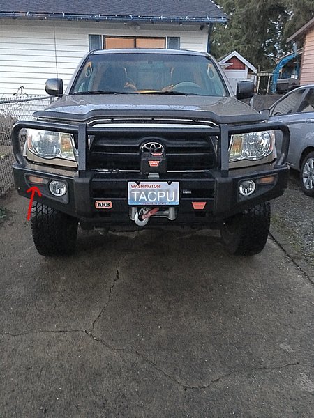

    Dear Fellow Tacoma world members.
    I recently purchased a 2008 Toyota Tacoma with an ARB bumper. The bumper has fog lights and small marker/signal lights. The fog lights work and are connected to the factory connecting and switch, but the marker lights are not connected. The guy I bought the truck from thought they were just reflectors but I see they are not. I'd like to wire them as DRL and signal. But I'm not sure how to do it.
    Thanks in advance.

    Cut the black coating off of the wires, and cut off the white connector. Follow up the two wires going to the LED blinker. I tapped those two wires to my DTRL. Its easy to tell which ones are which when you take that black plastic off the 4 wires.

    Thanks a lot guys. I'll be doing it this weekend. You guys are
