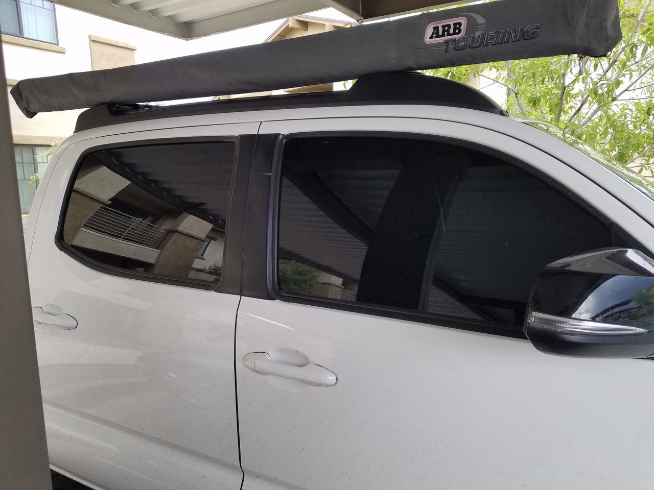

    Here is my basic idea. Using the mighty mount as the base on the rack bar and a 1/8 steel bar curved around it for support of the awning. I bought my awning used so that was the adapter that was on it.

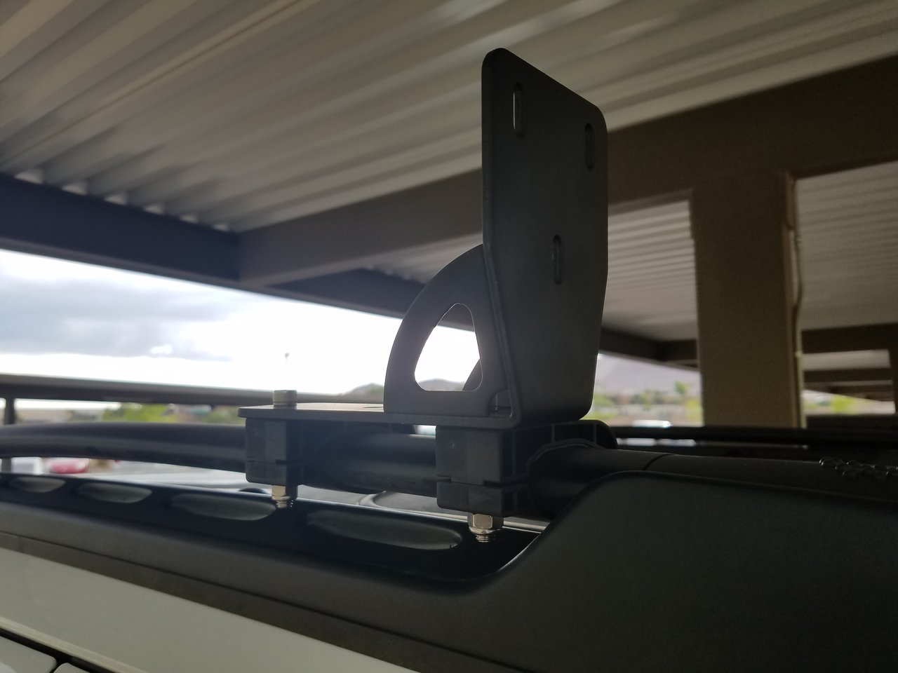

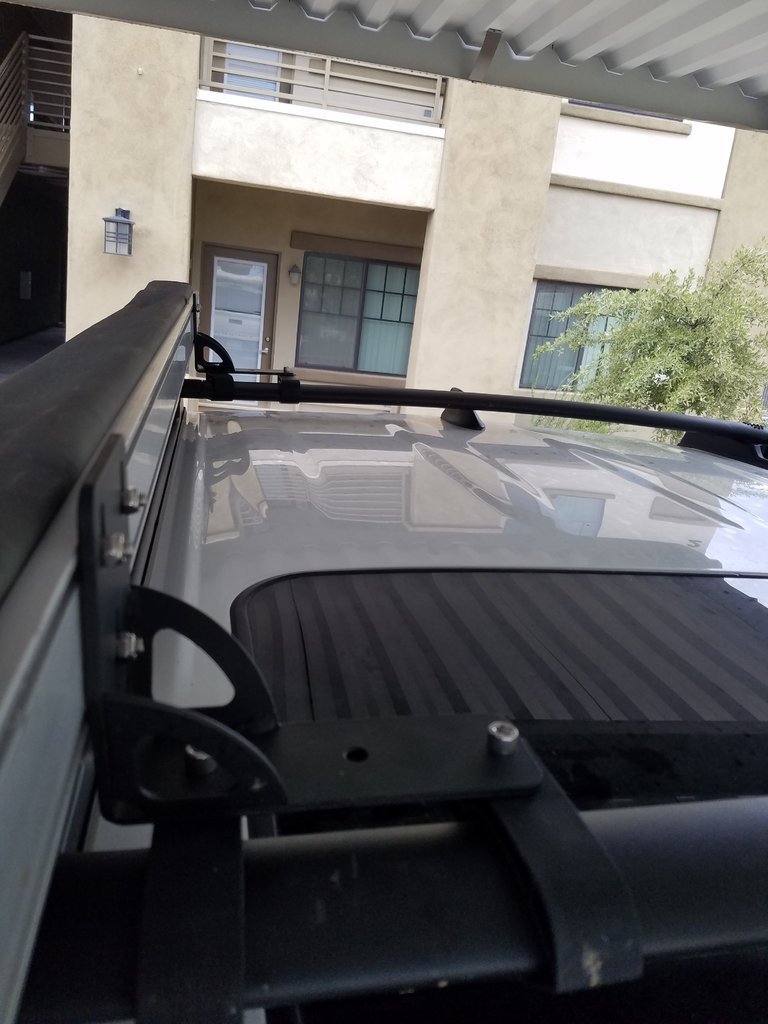

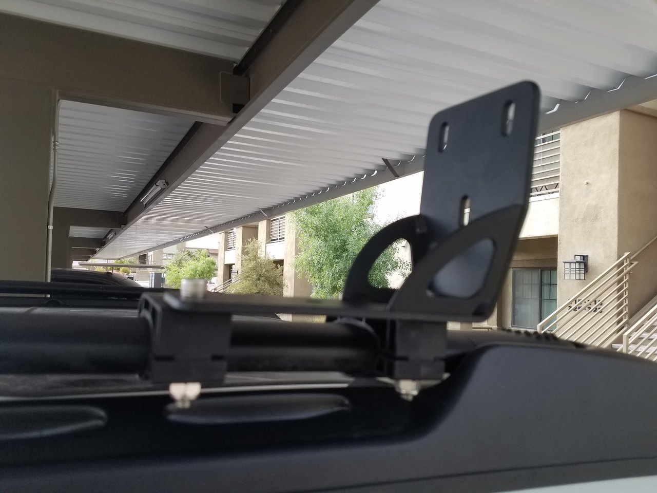

    My original plan didn't quite work so I ordered the universal arb awning mount. Should to finish up this weekend.
    I was hoping I could mount it stowed, but not sure if the rack would be happy with the weight so I'm going to have to do it on both bars.
    I used mighty mount 39H.
    I may still end up wrapping the plastic mount with some steel so it doesn't put too much pressure on the plastic might mount.

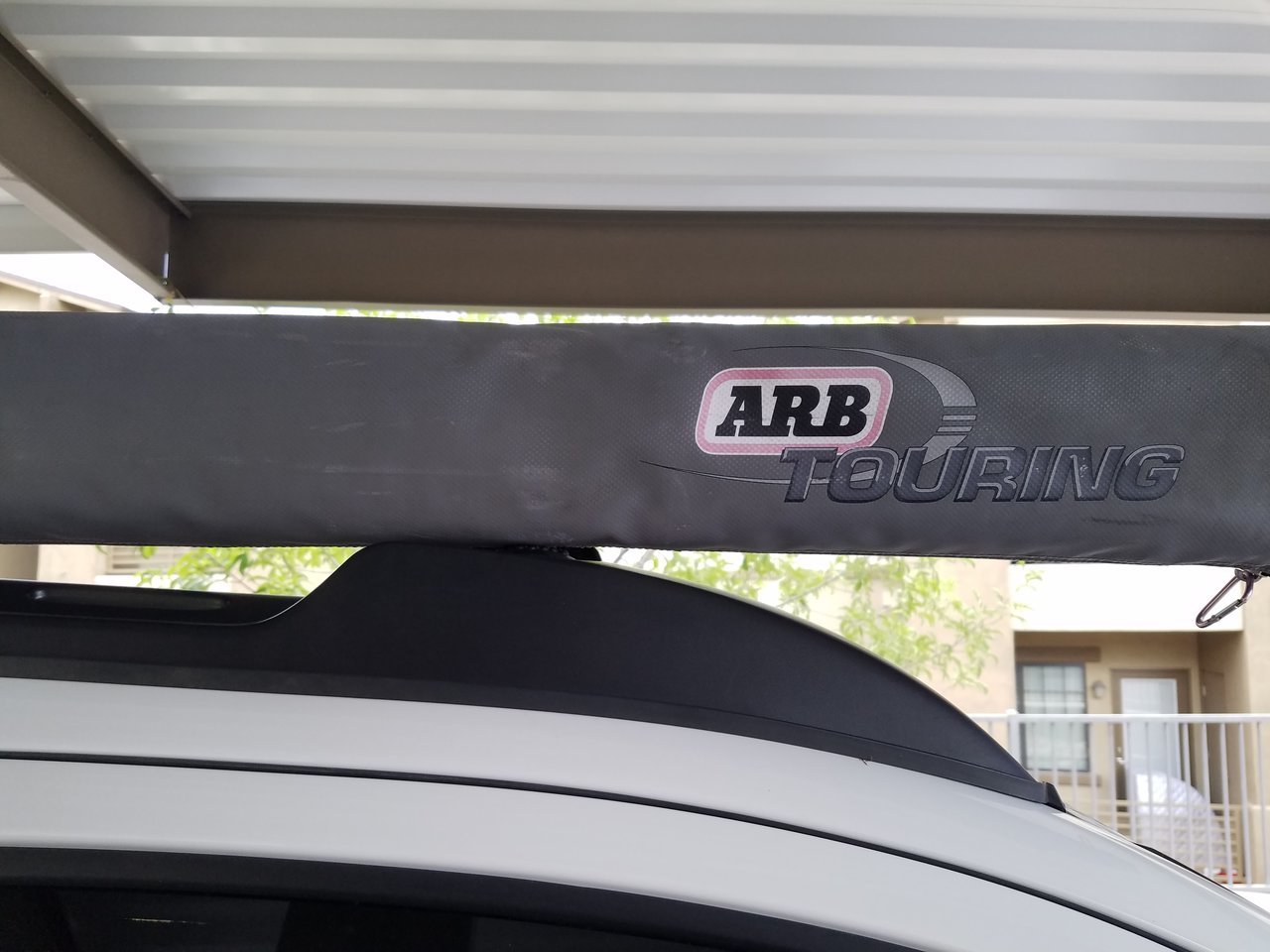

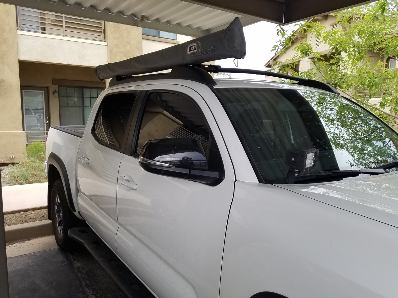

    End result.
    Mighty Mount 39H
    Arb universal awning bracket
    6mm bolt to attach awning to bracket.
    I can't remember what size bolt to attach to the bracket to the mount.

    This turned out really nice. Great job OP

    No so I ended up using the same mounting system and hardware OP used. That idea did work well though and I would say that it made the rack sturdier by having the awning connecting both crossbars

    Yeah it worked good and appears oem.

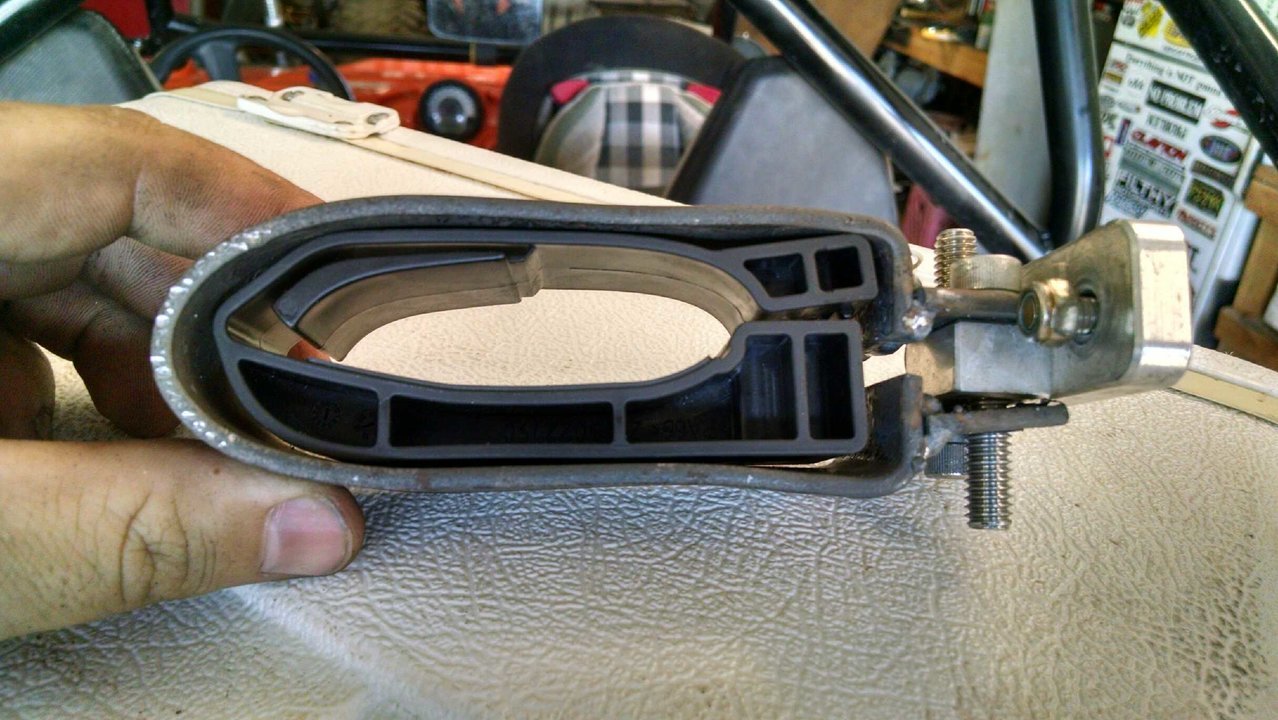

    Looks like I’ll be following in your footsteps. Any input on how thick those Mighty Mounts are so I can plan ahead for hardware?
