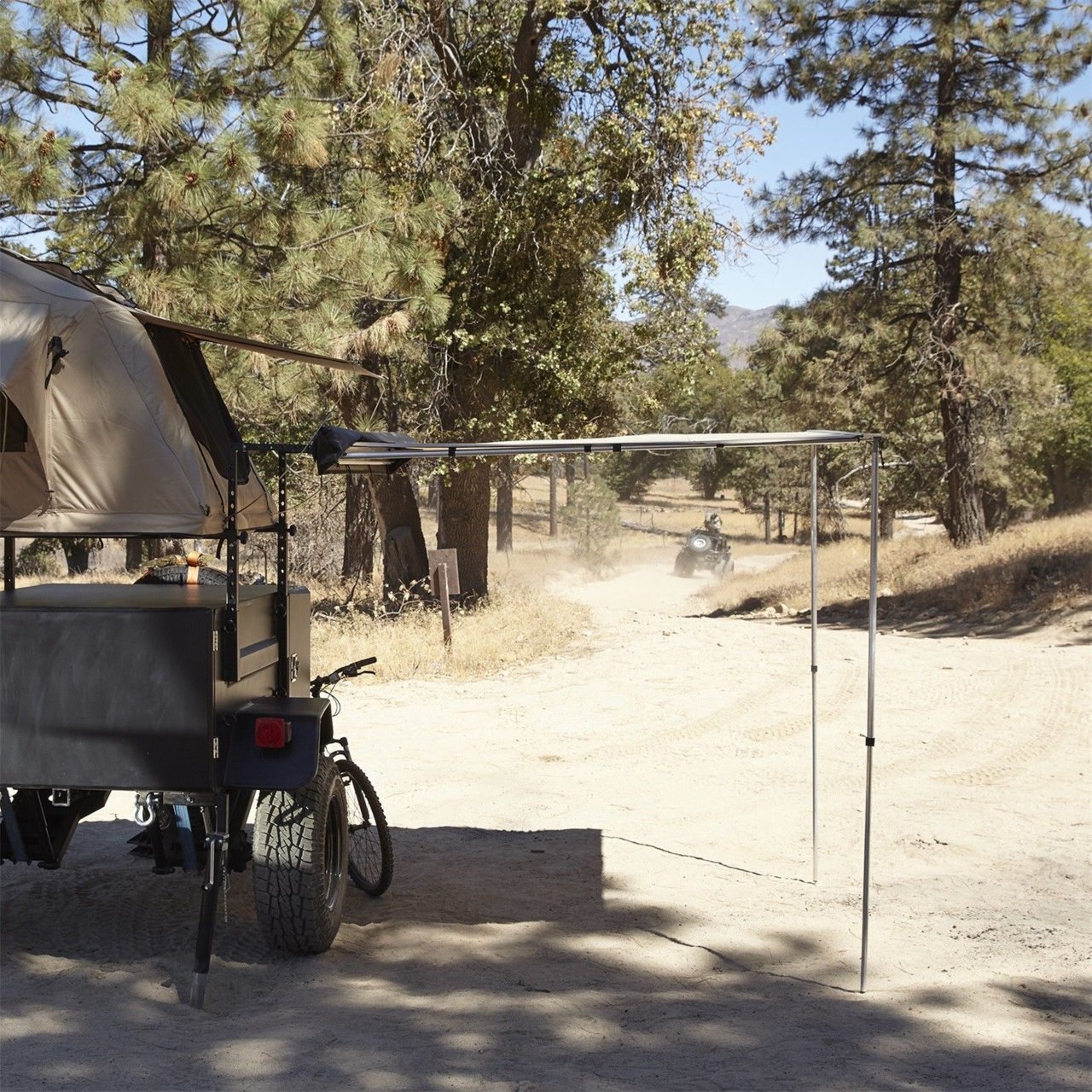

    Something to this degree would be ideal... Fabricated to fit the bed rail, stores low and then has adjustable height when extended. I would mount flush to the risers instead of having it stick out like that tho.

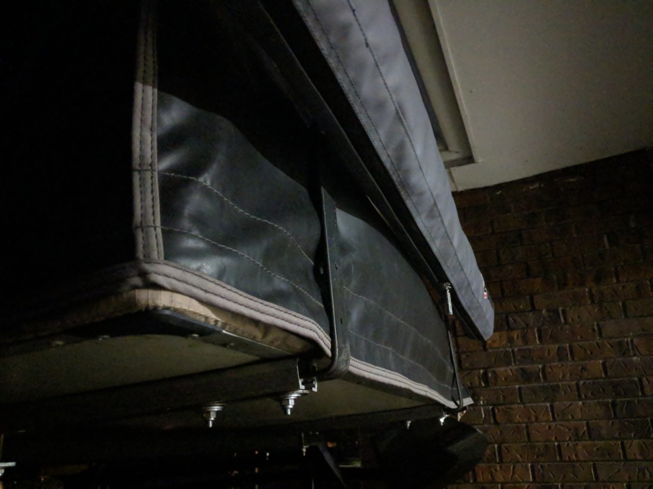

    My solution is to mount two tubular sleeves onto the backside of the awning. Now, if I want to drive away, I can insert rear posts (1/2" steel electrical conduit pipe) through the sleeves, secure them to the sleeves with linchpins, and then add guy lines to anchor the posts in place.
    Although my driveway test was successful, it was a PITA returning to the exact spot so the awning could be reattached to the rack. I need to do some more testing, but next time it will be in the dirt.
    With my first prototype, electrical conduit clamps were used to hold the tubing to the awning. I decided to replace this design with heavy duty brackets so they would not be the point of failure, in the event of a severe wind storm.

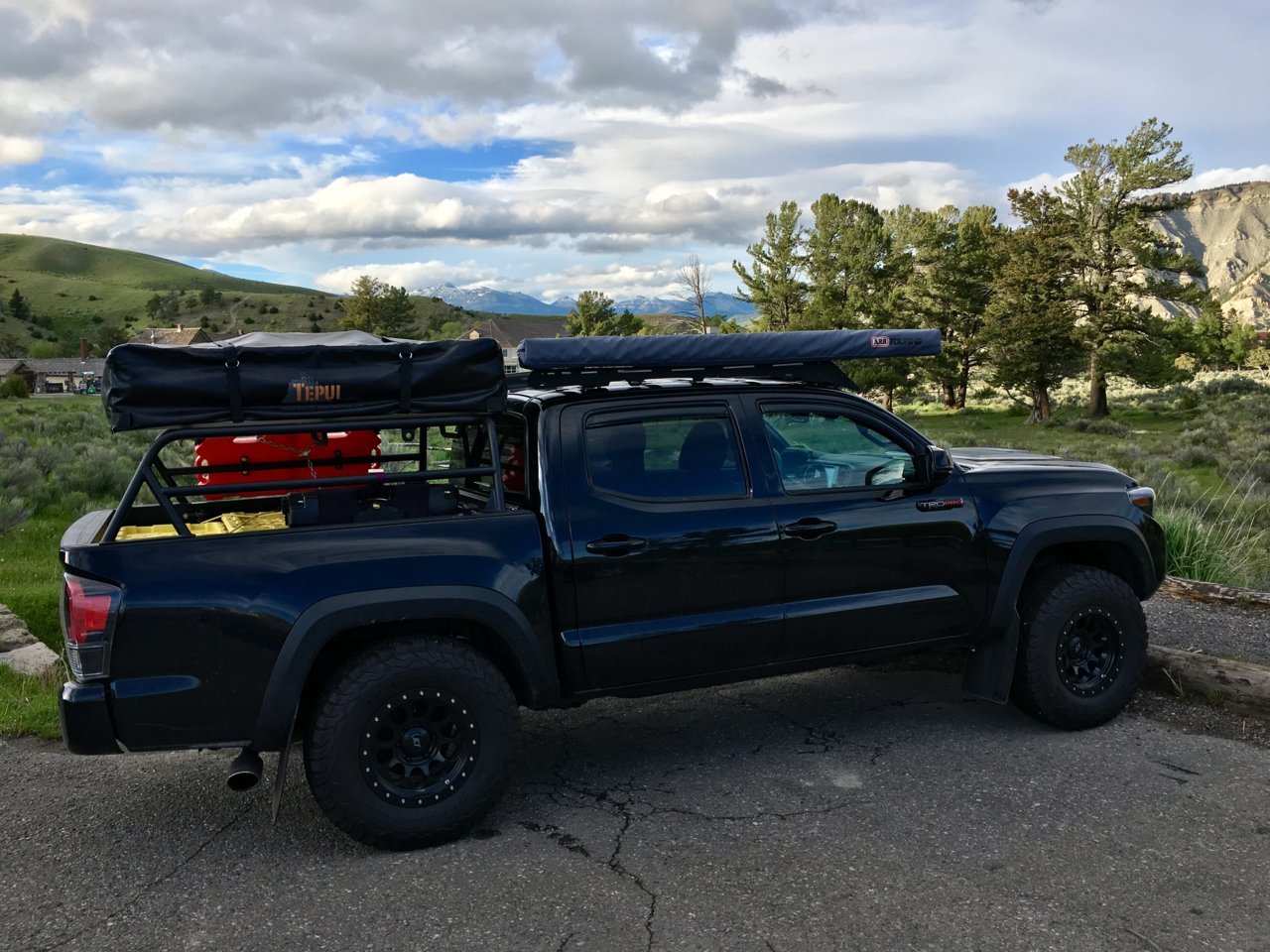

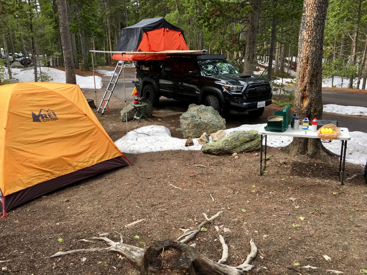

    My ARB awning has been one of the most used and needed items for camping so far!

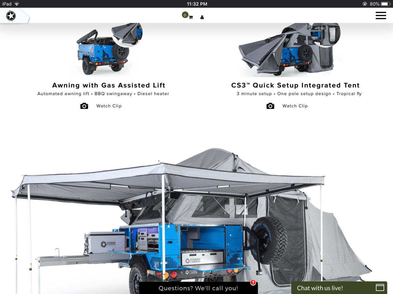

    Might be able to figure out some way to mount the lifting mount that patriot uses on their trailers.....if you can figure out what mount it is. I’ve looked around and haven’t found another like it. Might be proprietary to patriot.

    Awesome set up, 6' ARB correct? Did you use the Prinsu awning mounts?
