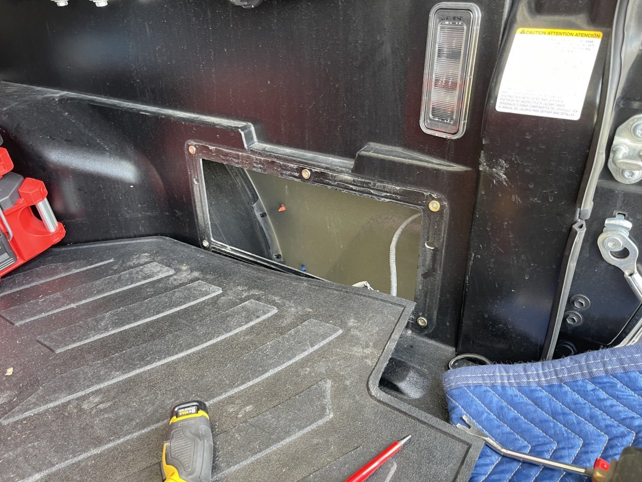

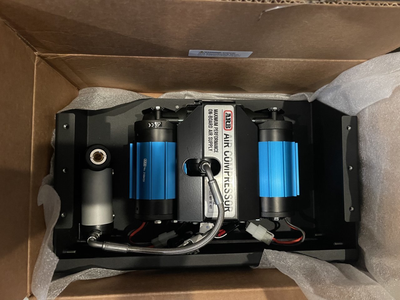

    I'm going to go with this one here their 5 1/2 deep so I'll just be able to fit a Max trac compressor in it

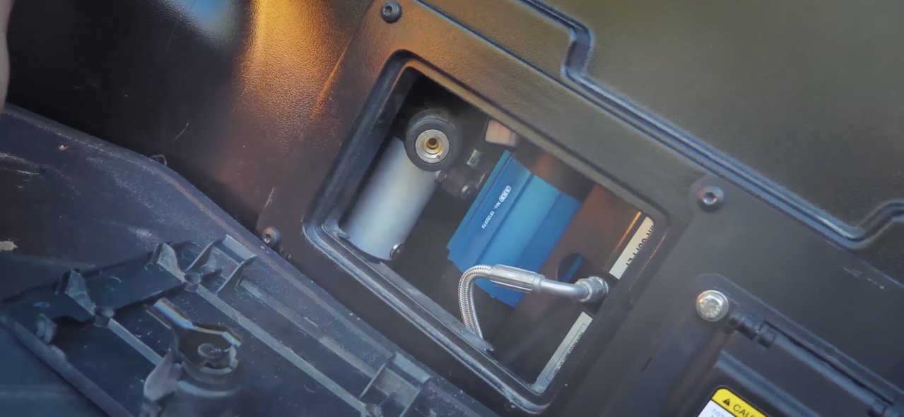

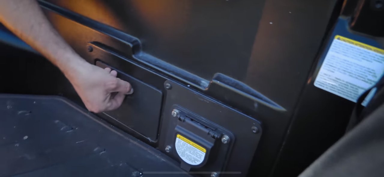

    I’m working on mine now. I have a 2020 so I have the passenger side cubby with the electrical outlet. I’m mounting mine similar to the guy from Nitro gear. The fist pic is a screenshot from his truck video. I’m also maybe going to change it up and figure out a way to use this ARB switch and port mount. I’ll post up some more pics etc when I get it done. Installing it the week of Aug 12

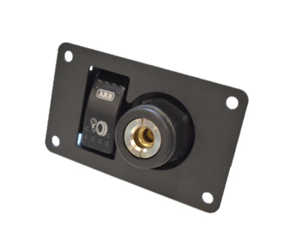

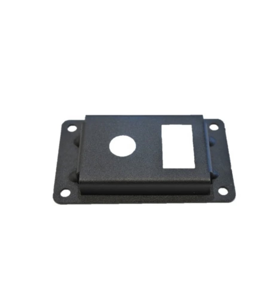

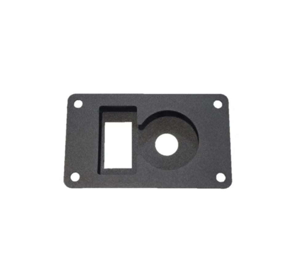

    I received the ARB mount today that allows the quick connect and the switch to be mounted. Now to find a place for it.
    I’m not sure I want to cut a hole in the bed side near the cubby.
    I don’t have to use the quick connect as like others I may leave that behind the door on the manifold.
    But I really do want the switch near the compressor in the back instead of in the cab.
    Any suggestions?
    I have a 2020 so mine cubby is passenger side with the outlet and smaller door opening.
    I thought about putting it in the bedside in that notch above the cubby but not sure about that
