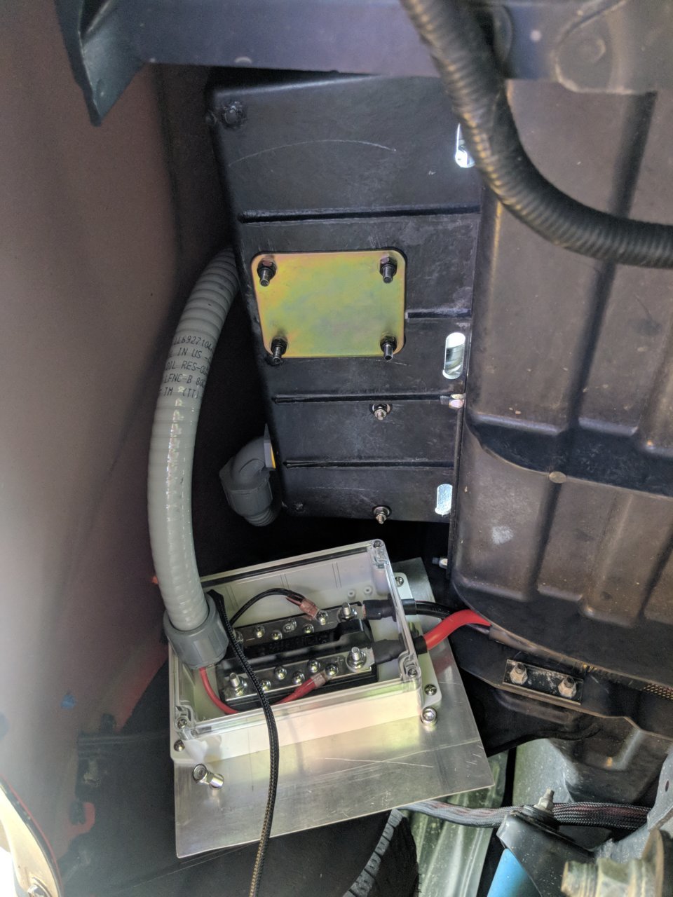

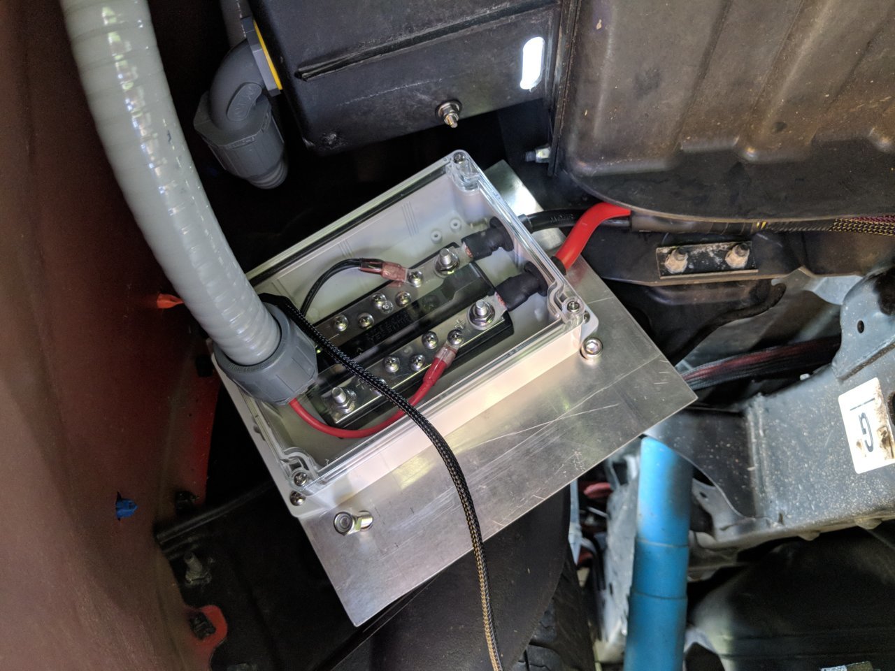

    I just finished buttoning up my install in the bed cubby this weekend and worked like a charm yesterday.
    4ga jumper cables from the battery to 60amp breaker to a distribution box behind the wheel well, then the ARB harness running from the box to the compressor, A box in the cubby that holds the relay & fuse, then 14ga cables running into the cab for the switch. A big learning experience and headaches getting it done but really happy with out it all turned out in the end. The pictures just don't show my plugged up Cubby Caps reinstalled to help keep the cubby dry.
    IMG_20180617_142438.jpg IMG_20180614_182618.jpg IMG_20180614_182605.jpg IMG_20180614_163238.jpg
    HoboDave[QUOTED] likes this.
