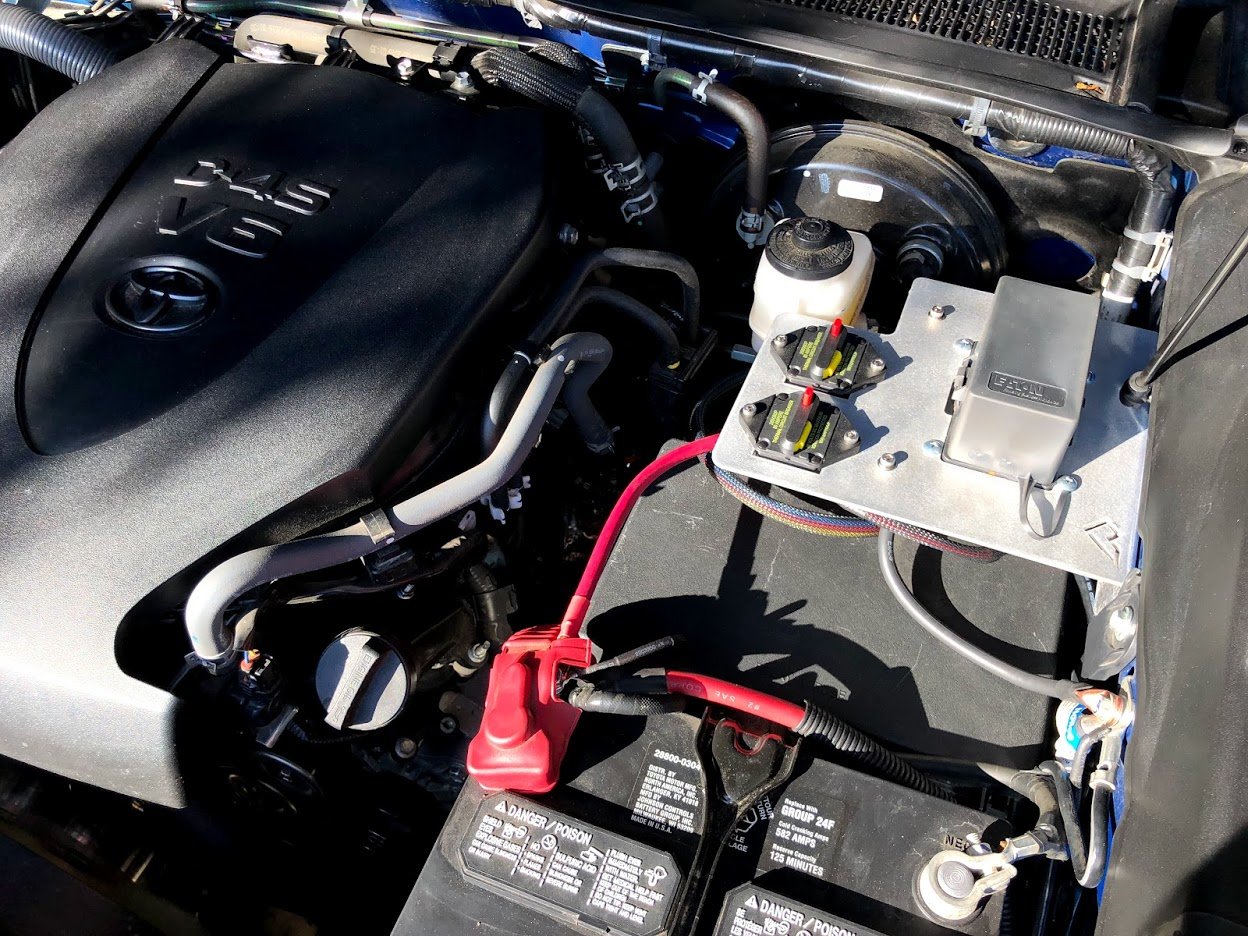

    The Metri-pack connectors are there and ready to go on the pump and are matching on the EE extended harness. The end of the harness leading to the engine bay has a Metri-pack connector with male terminals so I made another Metri-pack connector with female terminals to mate with it that I used to pin out for my RTMR panel. SgE13hEccJLhYcL1X8460RunCmIWE_UxWHfYxuHa_30cbc16ec662e17a2d2b04a2ed1a7ffc0028198f.jpg
    Routing the extended harness along the frame is not too bad until you get to the gas tank. I chose to route it over the tank which took some work but didn't take too long.
    All in all, not difficult. Just took some time and some different connectors, terminals and crimp tools.

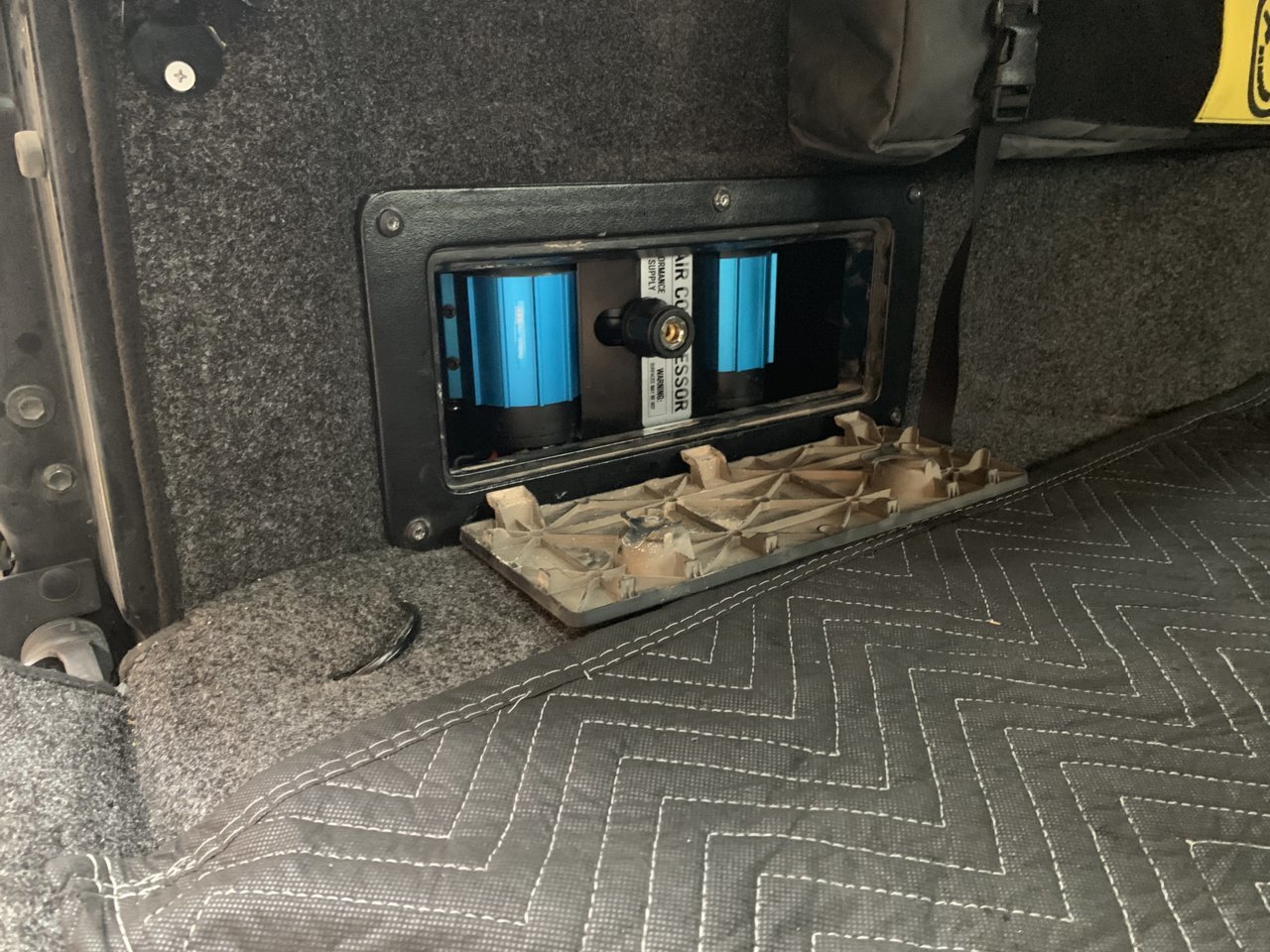

    Installed my Expedition Essentials ARB Twin Bedside kit today, very happy with it!ARB BEdside.jpg ARB Dash.jpg

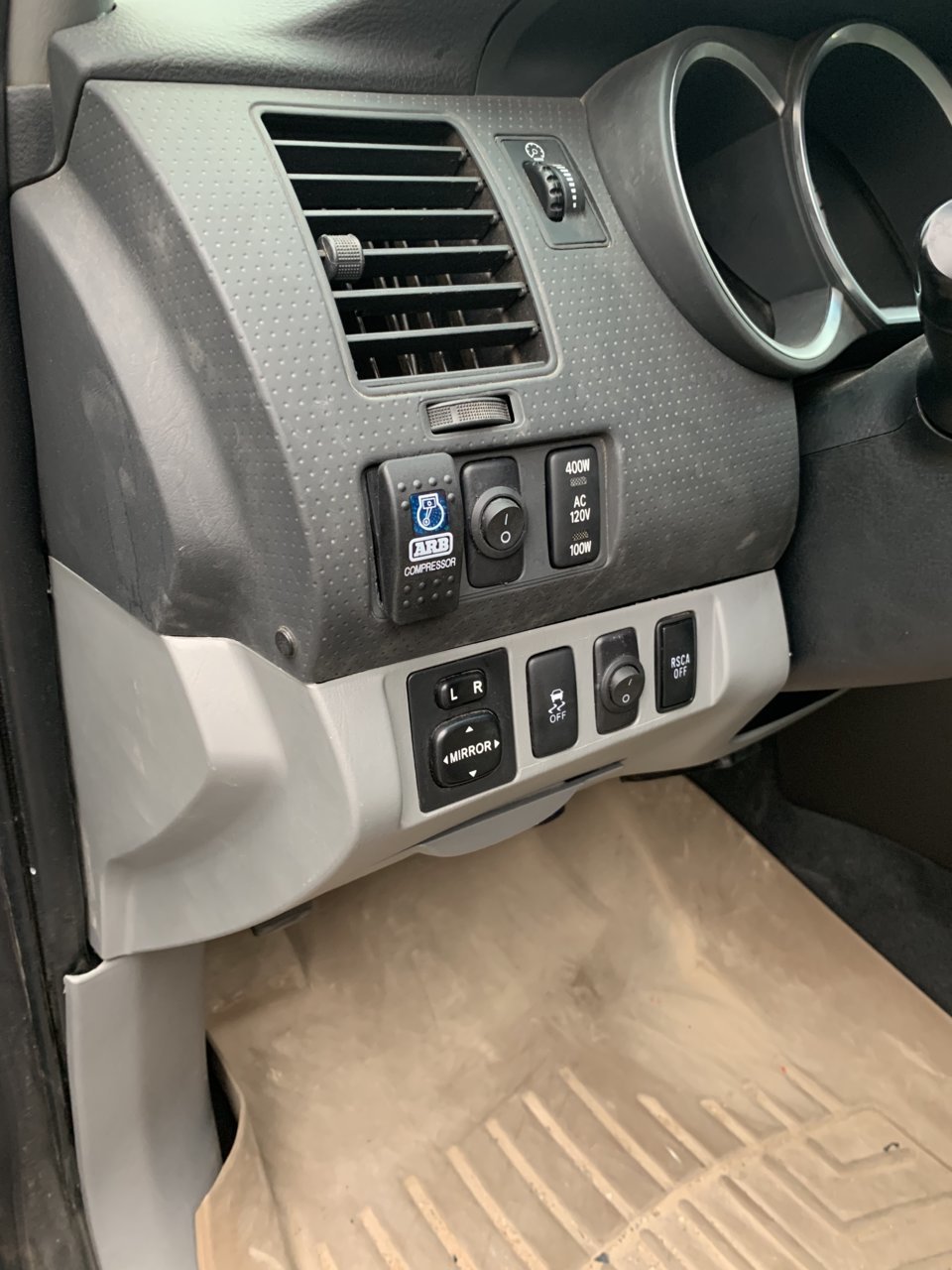

    where are people putting the ARB button in the case where there aren't any blank or non used spaces for buttons??? (PROs use all the oem button slots)

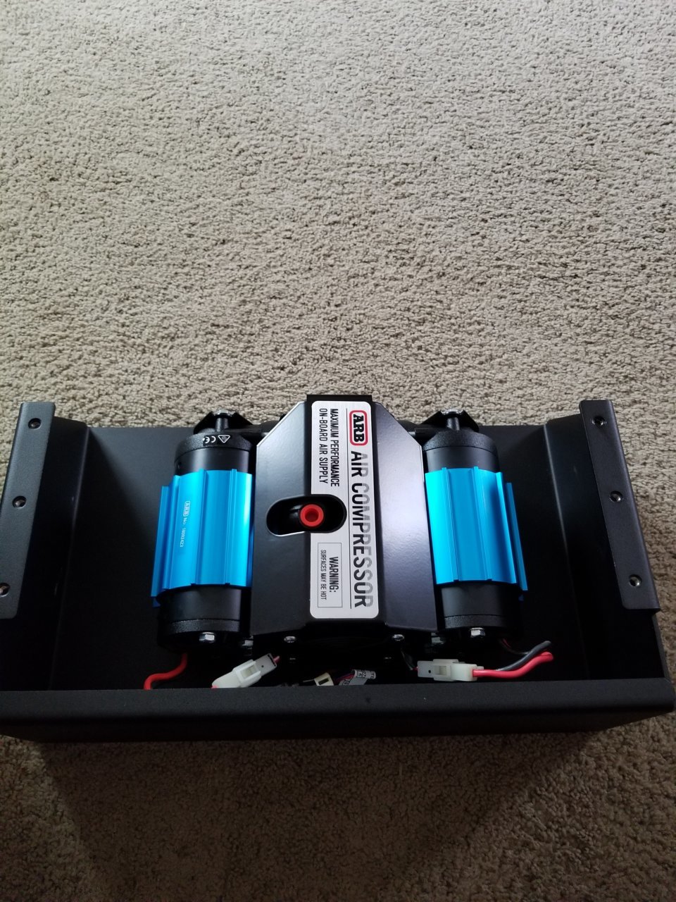

    Here's mine

    Also, I made a lid. And covered the holes with tape

    I put my dash switch where the OEM fog light switch on my 2nd gen used to be after I replaced the bumper and put the new fogs with there own switch. but that was just how I did it...

    i wonder if i can fit the button there like that but with the dual compressor, maybe there isn’t enough room though...

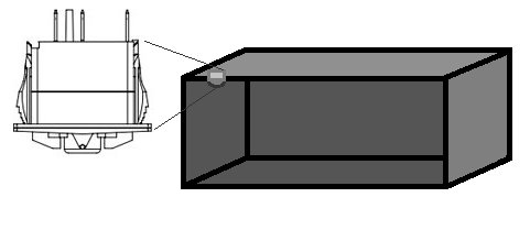

    Invert the switch bat style...

    Yes it is exposed. I had one in my 16 and it's now sitting in my storage. My 19 doesnt have the driver side bed cut out. The top would allow all the dust and dirt to sit in it. I did think the construction was very solid and the product itself seemed to be of high quality though.

    Agreed. Still made a top lid for mine.
