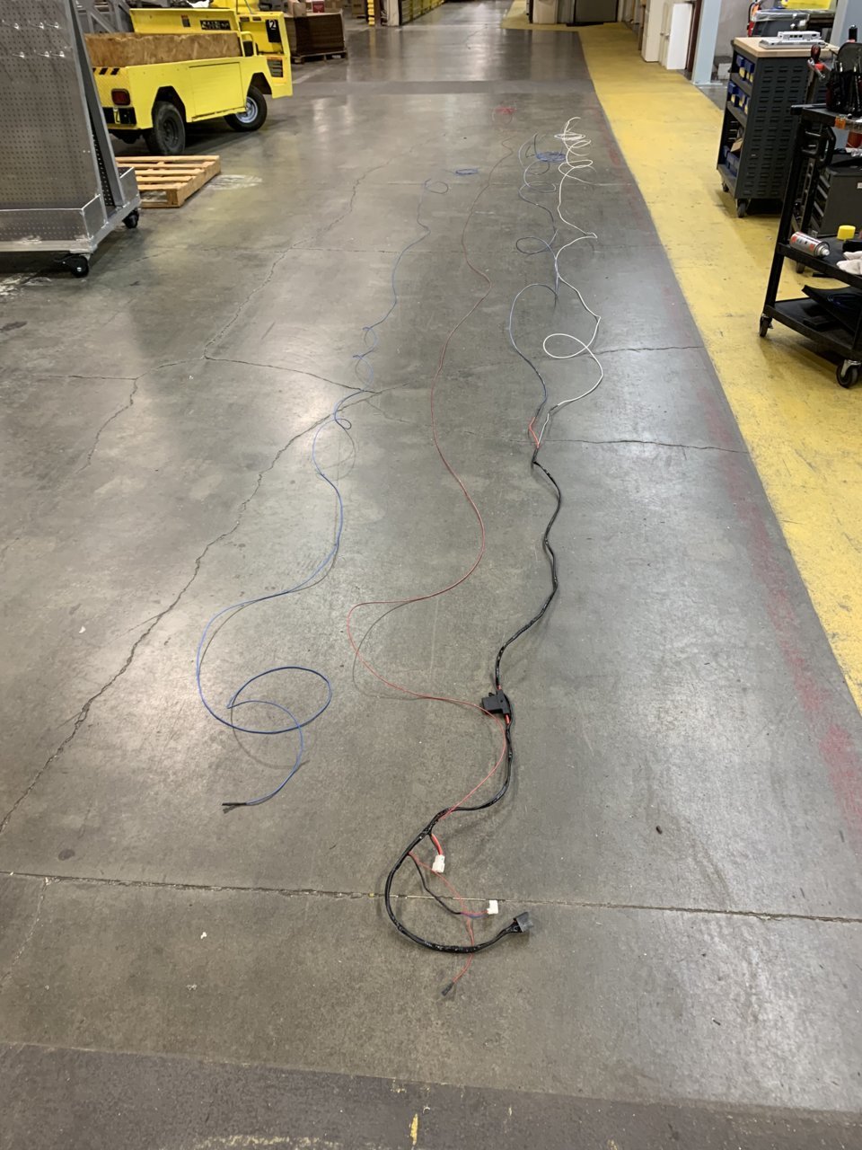

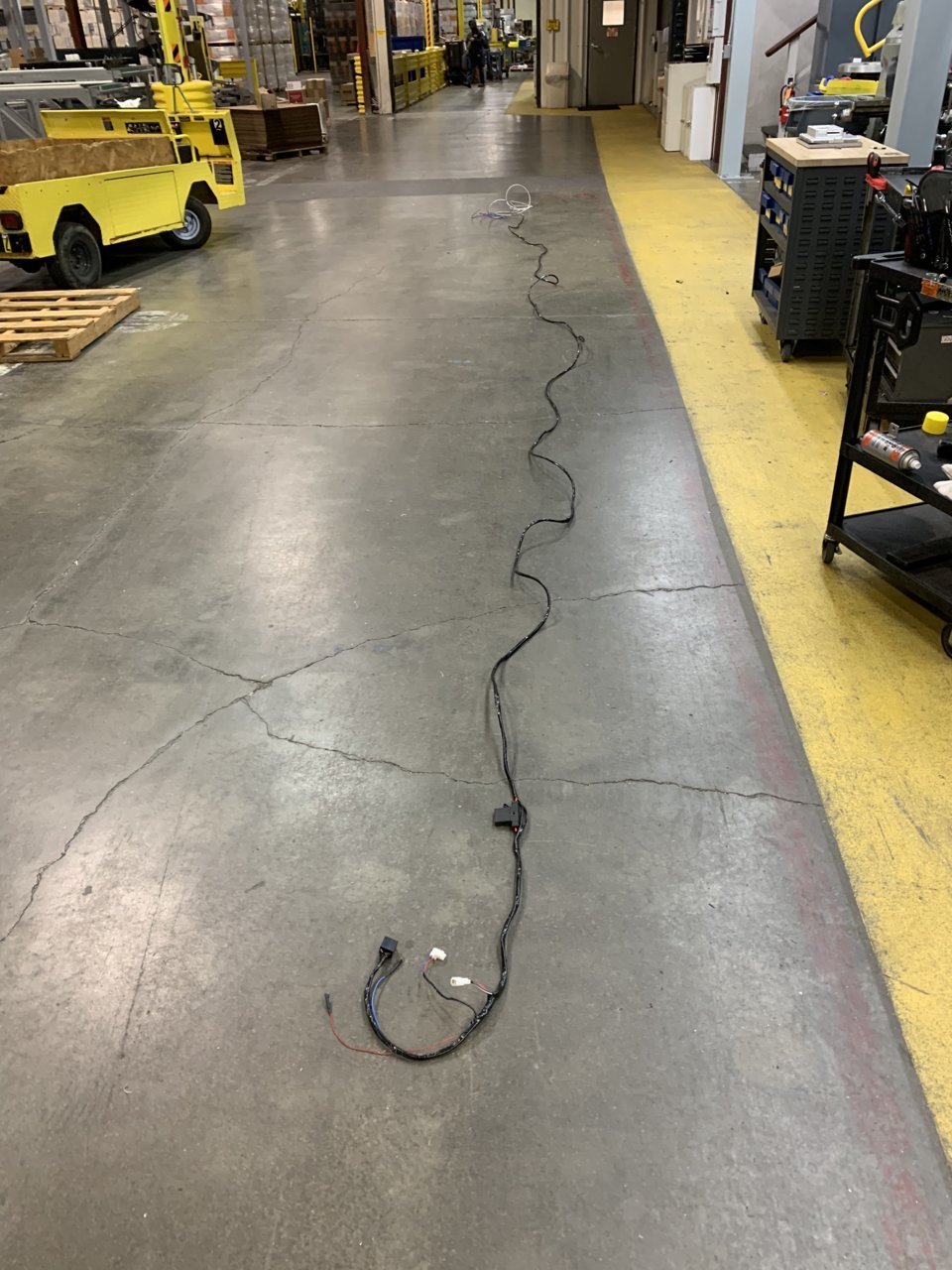

    I took out what I didn’t need and extended it myself
    96B5B95B-B9BC-4A26-9505-3785BE01F543.jpg 979D3A7D-ADA5-416B-8C4B-8504D707AFB5.jpg
    This was when I installed it. Since then I moved the fuse next to the battery where it should be.
    I only use it for air source. I don’t have air lockers

    So you did ended up buying the extended harness and removed the wires not needed?

    No. That was the regular harness for the single. I removed the stuff for the lockers and extended it

    Ah I see. Thanks brotha. Will probably go this route as well!

    Used 10 or 8 gage wire and don’t forget to move the fuse! :cheers:

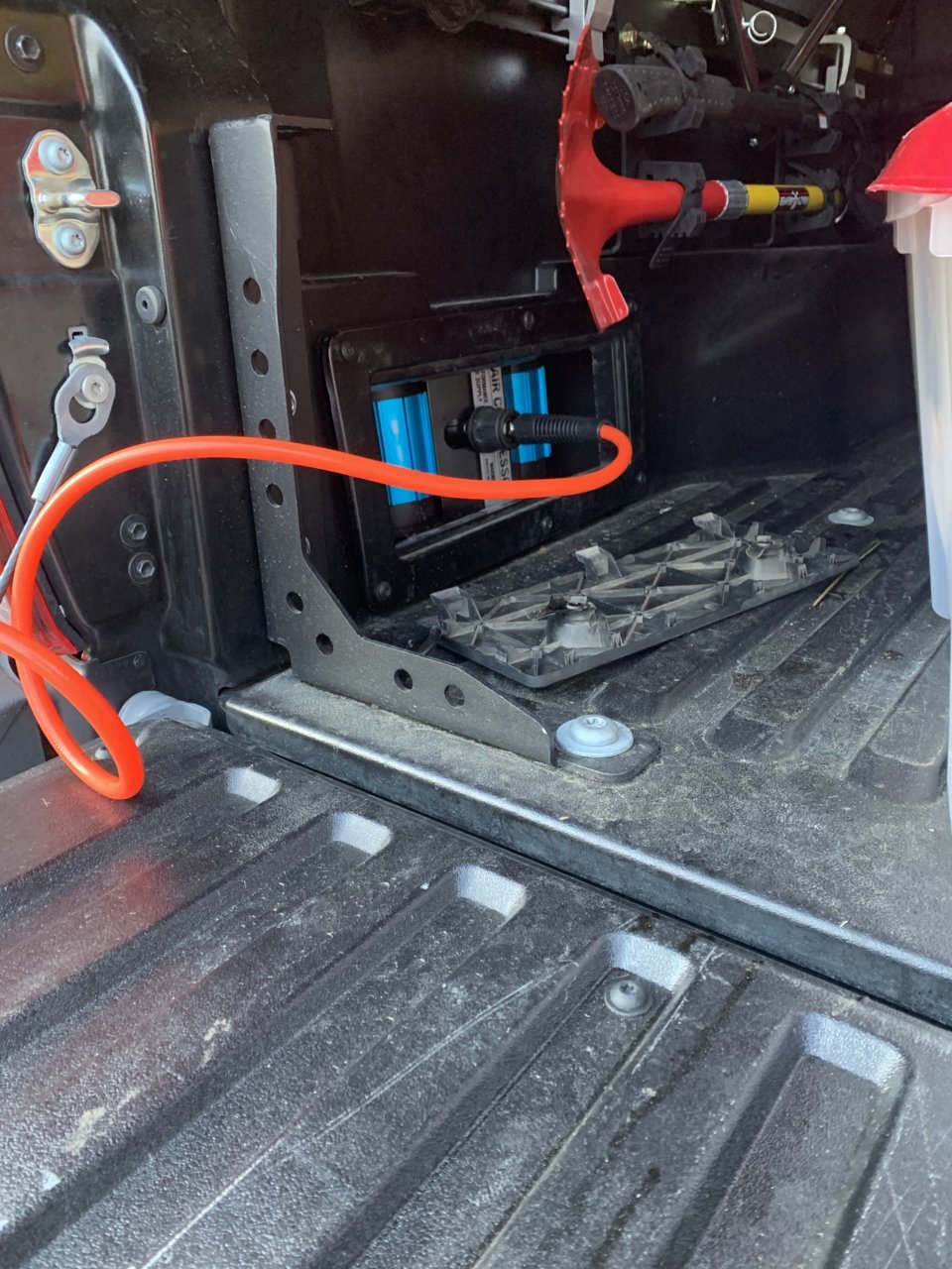

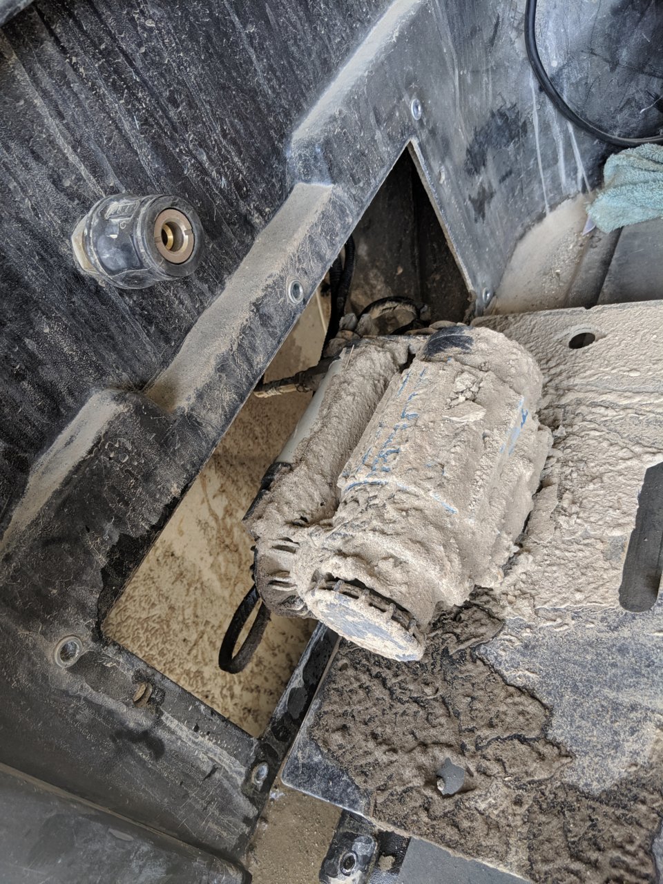

    IMG_20190616_110241.jpg Arb's bedside kit for the third gen Tacoma. This is what happens to it.
    So? Don't buy it.

    Mine has stayed relatively clean with the top covered. I just plugged the rest of the holes with tape. I also added silicone around the frame for the door for the rainy season.

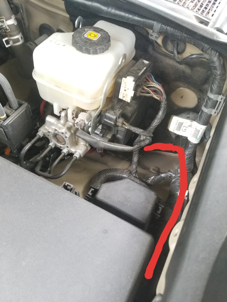

    Hey guys, don't know how active this thread is but figured I would post here instead of starting a new one.

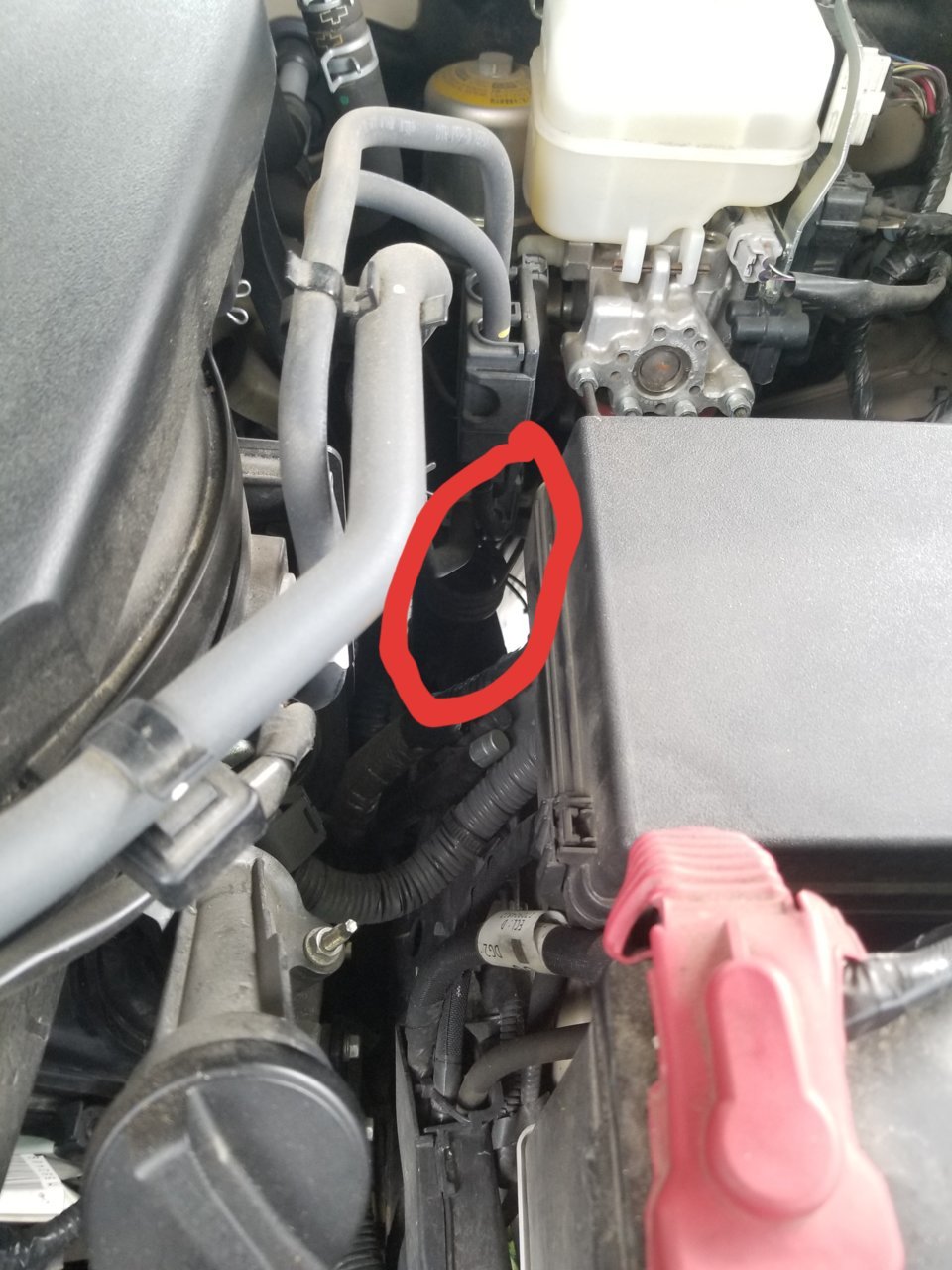

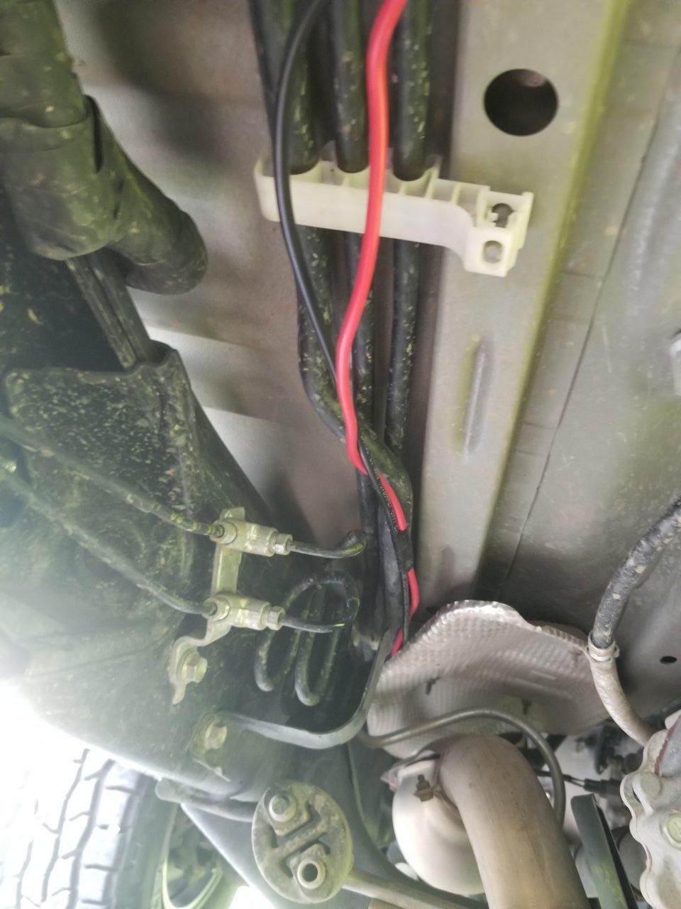

    I'm trying to figure out the best route from the battery to the frame. I think I can run behind this heat shield for the exhaust, but don't want anything to end up getting pinched in the future. Any input on the best route?
    Circled area is where I was going to run it up from under the truck, and the red line is the route I was planning to the battery.
    I was just running it without zip tying anything yet to make sure this isn't a terrible idea.
    Sounds like I should maybe move the fuse too? (This is the wiring harness from expedition essentials that they put together for the Viair 450h and their bedside mount btw)

    Thats what I pretty much did. Haven't had problems so far. Just make sure you zip tie everything and make sure you add some shielding to the wires near the heat shield. Don't want to burn that up

    Definitely not! What did you use for heat shielding and how did you attach it?

    To be honest I made my own harness from wires I got from home depot. Added some heat shrink then put some fiberglass shielding that I got from work

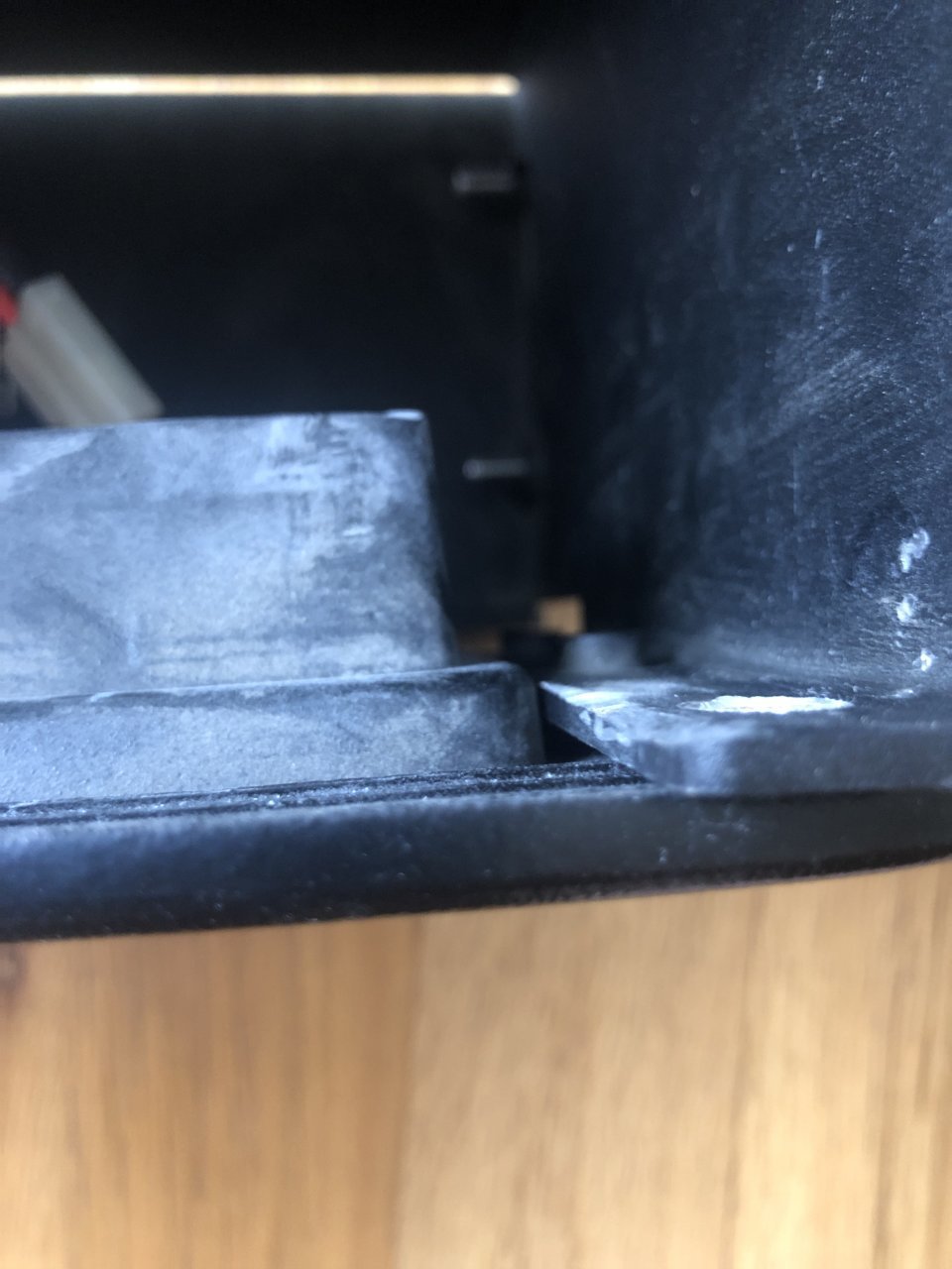

    image.jpg 097A38C5-C5C8-433B-B092-5C9C9BE60728.jpg For the door mount was the inner lip able to fit completely inside? Mine seems to be too long for their box. The spacers they provide dont fill the space completely When it’s on the truck

    That’s what I did too. Just tucked it up under the heat shield and reshaped the heat shield to keep the wires in place. I’ve had it installed for about a year now. I recently installed rear lights and ran the wires right next to the compressor wires, so I was able to inspect them. No problems!

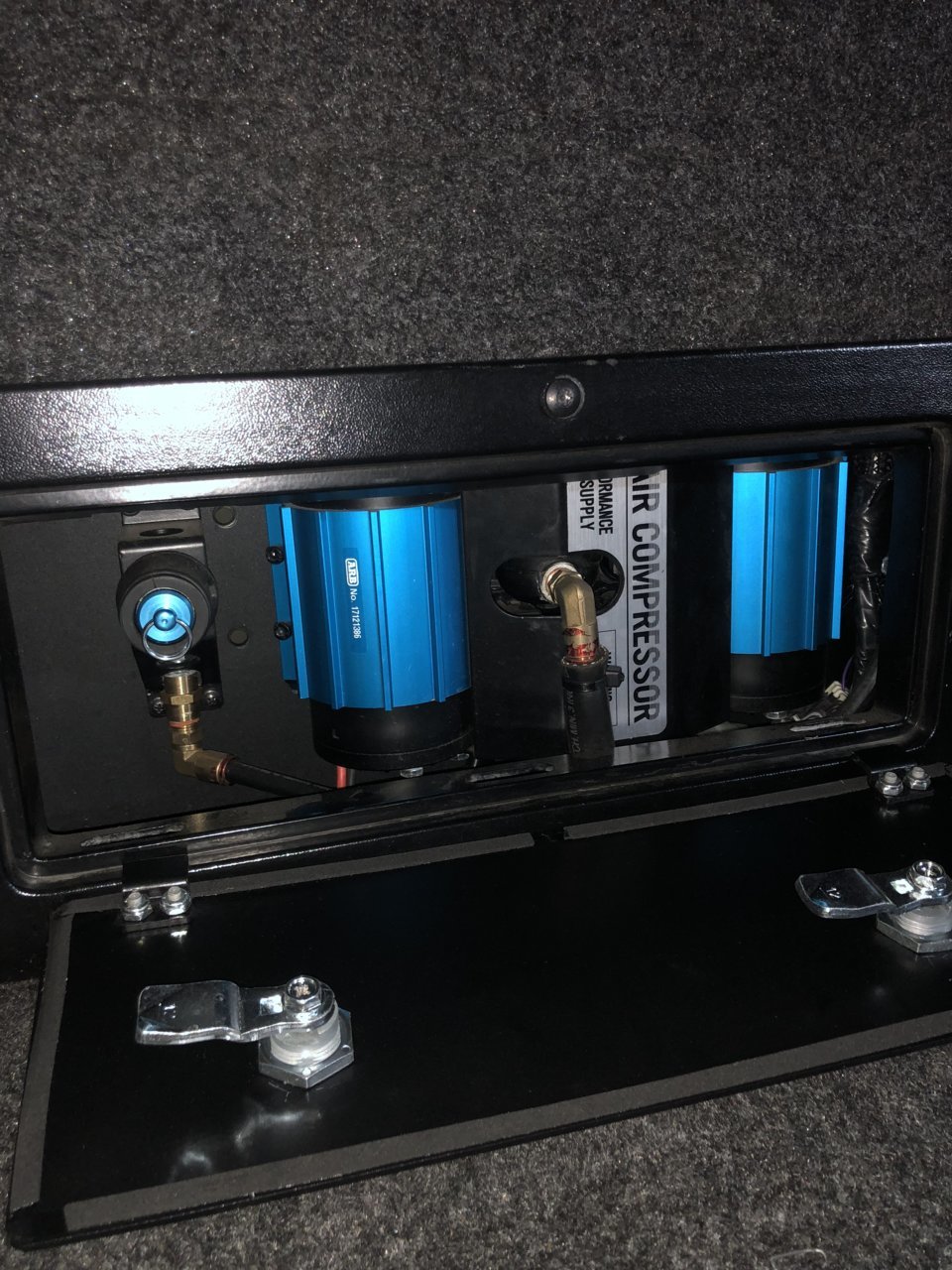

    how are the twin compressor filters accessible with this mount?
