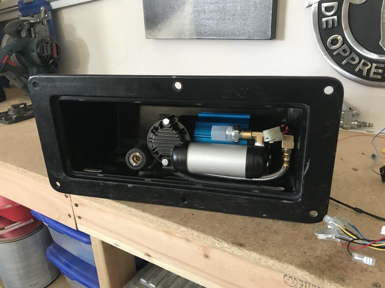

    As much as I want to get the EE bedside mount, I really wanted to see what I could get away with since I recently had a tore all the tendons in my knee and can’t move around too much. I grabbed a few components to move a few things around and made a couple of adapters to hold stuff nice and snug, I’ve got a rough draft of what I’m going to try and install. What you don’t see is that I have behind the air hose hook up. I added a “T” connector so I can not only use my air hose on its own but also air up my airbags from inside the cab while I’m driving. That way if my rear end is riding a little off with the trailer, I can air up and down with a switch while moving. I’ll get more pictures and updates as it comes along. I also really have no damn clue what I’m doing but I’m having a blast!

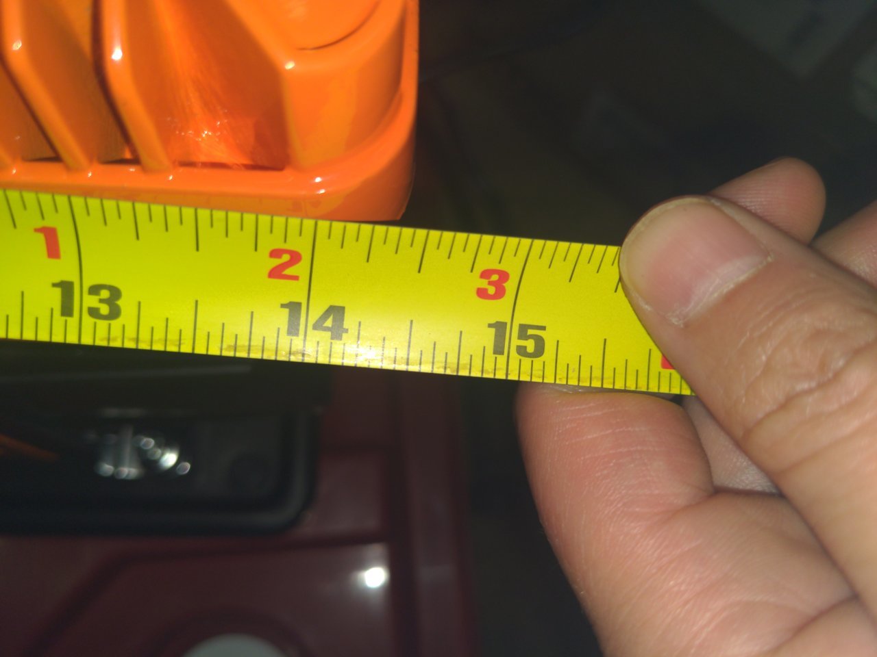

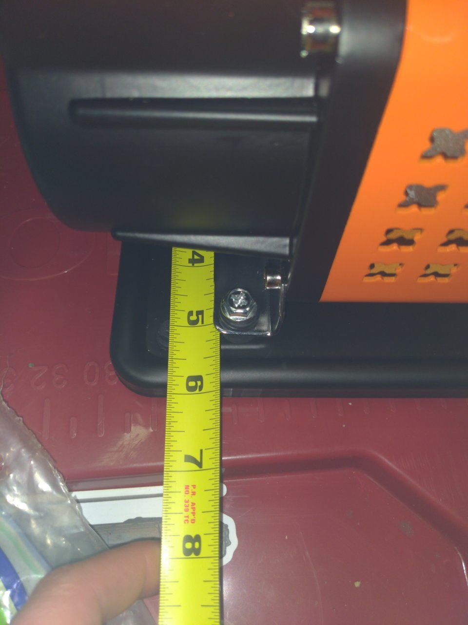

    What are the interior dimensions of the ARB bedside mounting box? I want to see if my new napa compressor will fit. It's about 14.5in x 6in.

    I'm in the same boat, curious if I can fit a Napa Maxi Trac compressor in this box, inner dimensions anyone? I would scrap the Maxi Trac base and save about an inch plus of needed depth

    16 1/8 x 10 1/8 x 5 1/8
