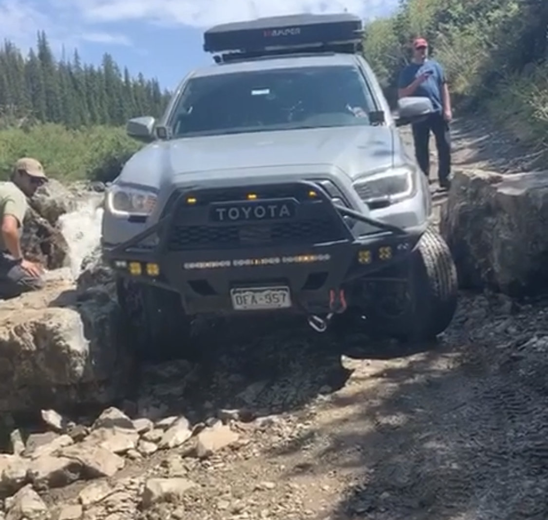

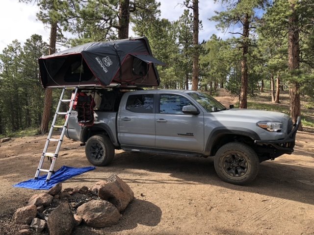

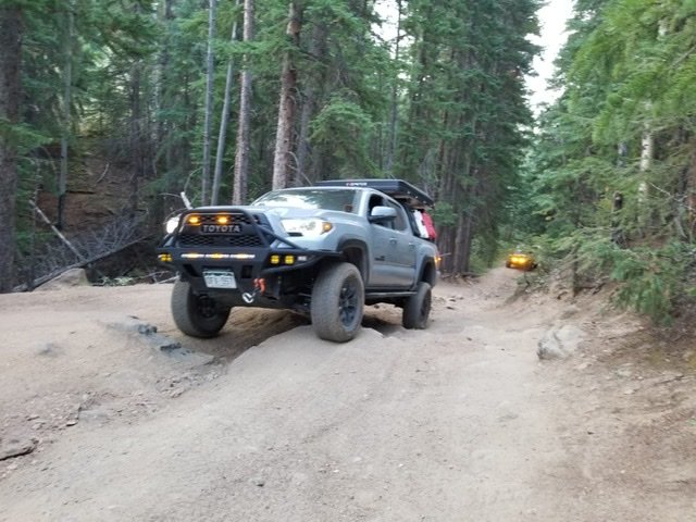

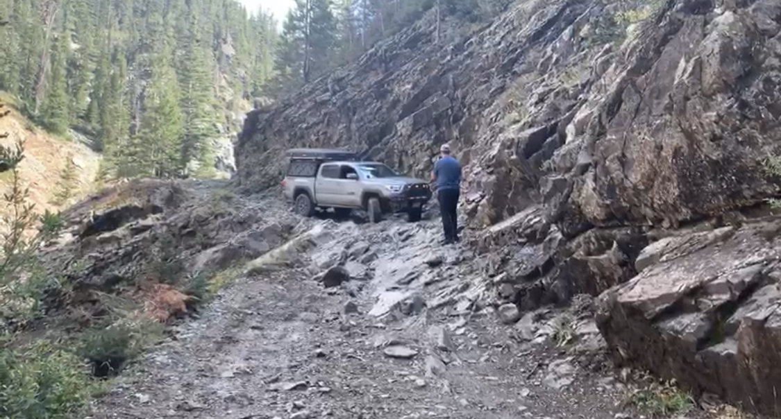

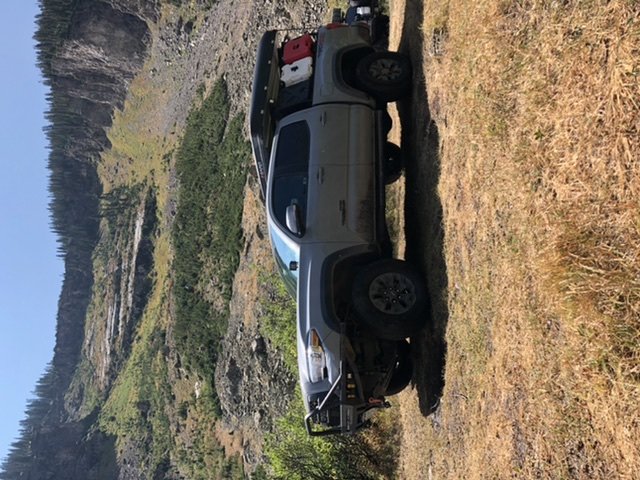

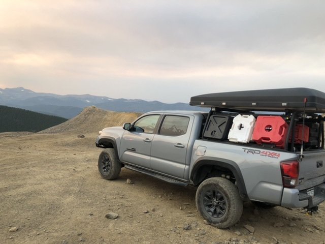

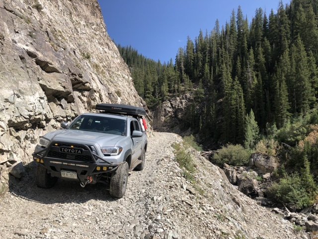

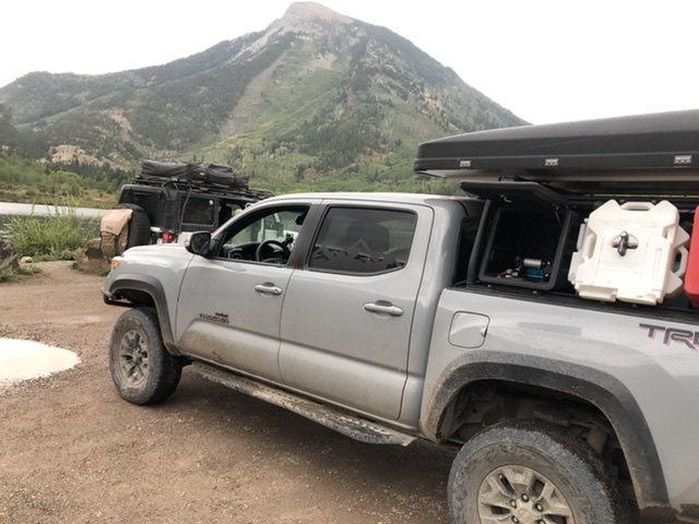

    I have put on 14k miles on my bp-51 setup.
    iKamper
    Leitner designs rack
    2 - 3 gallon gas rotopax
    2 - 2 gallon water rotopax
    1 - xl pod
    1 - single pod / arb single Piston air compressor in it
    C4 hybrid front bumper
    12k smitty winch
    RCI - rock sliders
    Decked USA deck system
    So I’m loaded down.. plus all the camping gear.
    been down some pretty crazy trails, off-road pretty heavy, minimal rock crawling but I’ve done it.
    overlanding for 5 days - awesome.
    I don’t have another suspension system to compare, but I am very happy.
    I wouldn’t mind about 1 more inch but I may add a leaf and adjust my preload.
    I’m about to add 285/70r17s to my truck from the stock tires and wheels (wife approval - finally)
    I was told these are bomb proof for overlanding but not the best for rock crawling / off-roading. But I’m more into overlanding and off-roading when needed (which has been great)
    if I had it over to do again, I would kee
    With the bp-51s
    I haven’t done much adjusting, but I may make them softer while on dirt roads and make them a little harder when on large rocks and off-roading.

    Actually - the stock tires have been great, snow Wheel’n etc.. until... off camber - rocky ledge : schofield pass...
    slid all over the place - now - wife approved larger tires and wheels

    schofield ain’t for the faint of heart… it one of those trails where you’re praying no ones coming up from the other direction.
