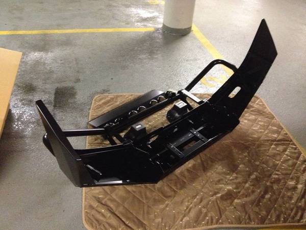

    So, I couldn't find a really good ARB bull bar installation thread and it made me nervous to take it on by myself, but it turned out fine. Use these pictures to help make sense of the terrible ARB instructions. I would have felt more comfortable if I had seen some more pictures, so this is my way of giving back to the wonderful TW community.
    Some said it is absolutely a two person job, others said they did it themselves. I will say, it is possible with one person (and I did it by myself), but it will be easier to level our with a friend.
    Follow the bumper removal thread on TW to remove the cap and aluminum plate. It is also important to remove the two bolts below the frame studs as the receiver won't fit with them still installed.

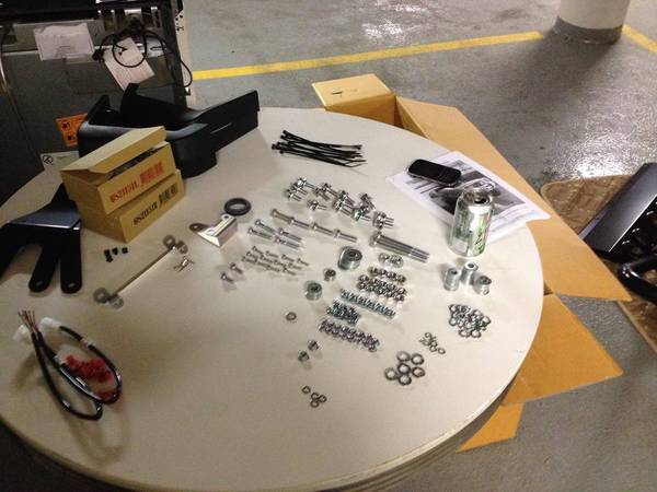

    Next, completely organize your hardware. It takes a long time, but it really pays off.
    This was the most time consuming part, making sure all the bolts, nuts, washers and spring washers had a place on the receiver. Again, stay organized and take your time.

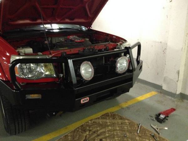

    picture of the bumper set in place, but not bolted. Again, this was very time consuming to get it correctly positioned. I ended up being about an inch off-center, but I can fix it later. I would have noticed it if I had someone there checking that with me while I adjusted the 6 receiver bolts.
    After that, just attach the rock guard and you are done.

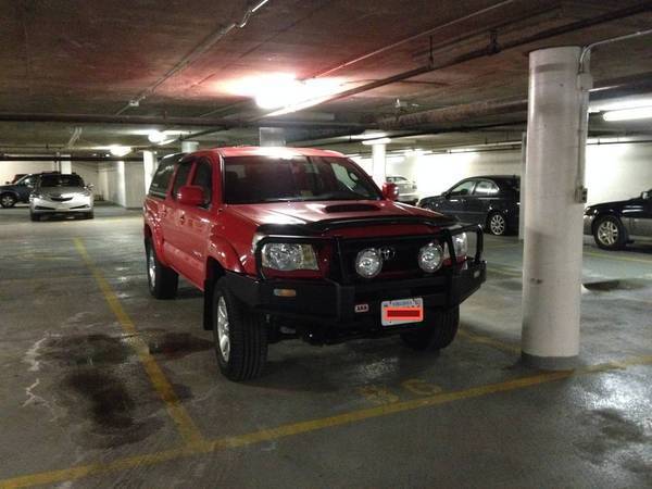

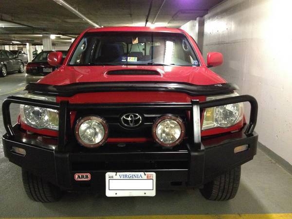

    Finished with the grill reattached. I still haven't wired the turn signals or HIDs, but it should be a quick weekend project.
