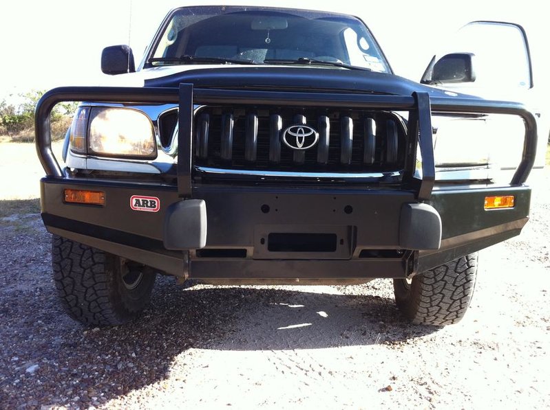

    The splash plate mounts on the bottom of the bumper, between the skid plate and the front of the bumper. I think its to cover up the winch and keep it from the elements. I never put mine on.
    It would be pretty obvious if it doesn't have provisions for a winch. As long as it has the recess for the fairlead you should be good to go.
    Does it look like this from the front:

    Yup, my bumper looks just like that.
    And here's a pic of the back.
    I'm guessing the splash plate is missing.
    Thanks for the explanation on how the winch mounts to the bumper. I guess I just had a hard time picturing it.

    Your little rubber USA compliant bumper dealy bobs are on upside-down and opposite sides...

    No the ones on your bumper are correct. Travis.diller was talking about the other photo that was put up. Yours look like mine, which are the correct orientation.

    Thanks, but that's not my truck, I just pulled the picture off google images because it showed the recessed area for the fairlead mounting.
