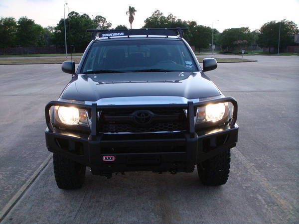

    You would have to agree that when they designed the bumper, they did not have lifts and larger tires in mind.
    A bumper built to match the fender flares will eventually cause problems, when after market wheels and tires are added. When the sway bar is removed the additional up travel will also cause problems for the flare and bumper.
    That is how the ARB should look.

    ^Yes.
    285s don't work with this bumper well. Even 265x75R16s get sliced to hell full stuff.

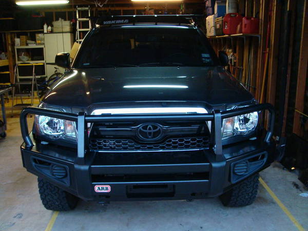

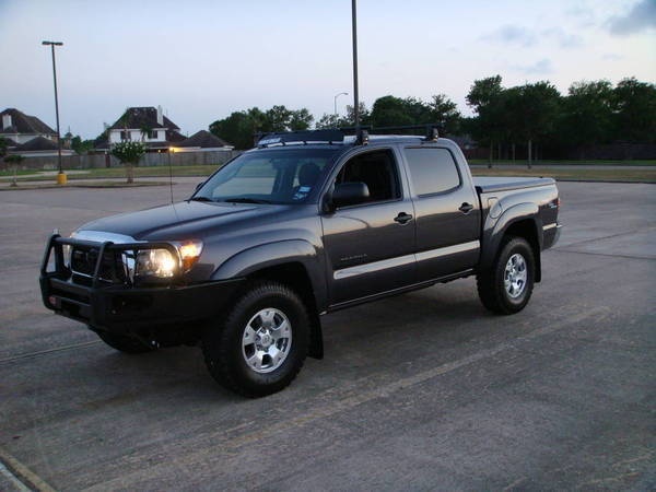

    here's a finished install on my ARB bumper. it took me about 3 days. I did a little bit here and there, that's why it took me so long. If i were to do it again, it'll probably take me about 4 hours straight. The most tedious part of the install was trying to align the fender line. The spec say to have it between 15mm to 20mm, personally i think that's too wide, so i adjusted to 10mm. I'm very happy and proud of my install and i also want to give my sincere thank you to all TW members who helped me with my install and questions. I will be picking up my foglights tomorrow and installing them soon. My next project would be my suspension and winch work (that should be a lot of fun). If anybody have any suggestions or comments about what suspension set up i should go with, I would appreciate it. here's a few pic

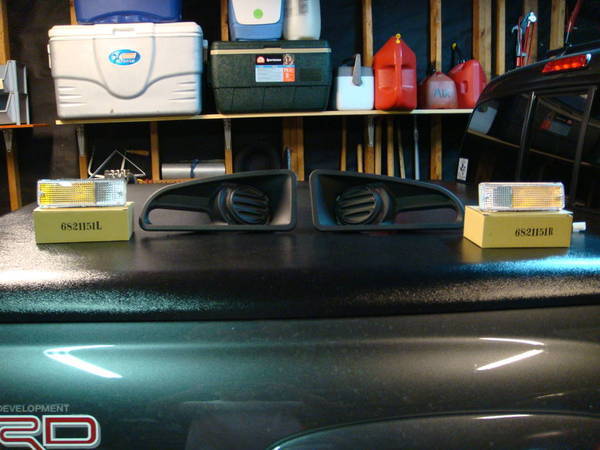

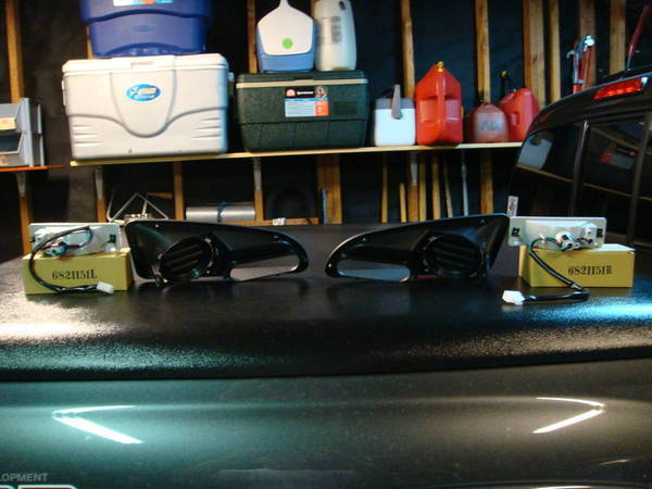

    One more thing. I think they shipped me the wrong lights that goes next to the foglights. there were no instructions with it but i tried every different way and angle but i couldn't get it to fit in the black casing. here's the pics.
