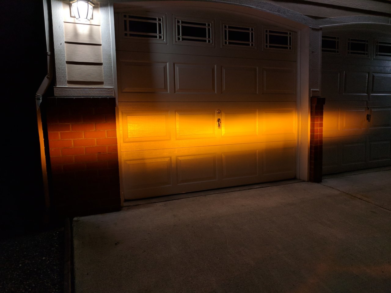

    I like my KC fogs, but I did not know about the Paranoid Fab brackets until after I completed the retrofit. The KC lights are dot approved and are very amber-colored. If I were to do it again I would prefer the yellow Baja designs lights even though they are not dot approved.

    Yeah, I am not a fan of the color/temp of the light that the KC's throw. I have been running PIAA IonPlasma for 15+ years in multiple vehicles and love the color they throw in dust and inclement weather. Because of this, I will most likely be running the BD in amber.
