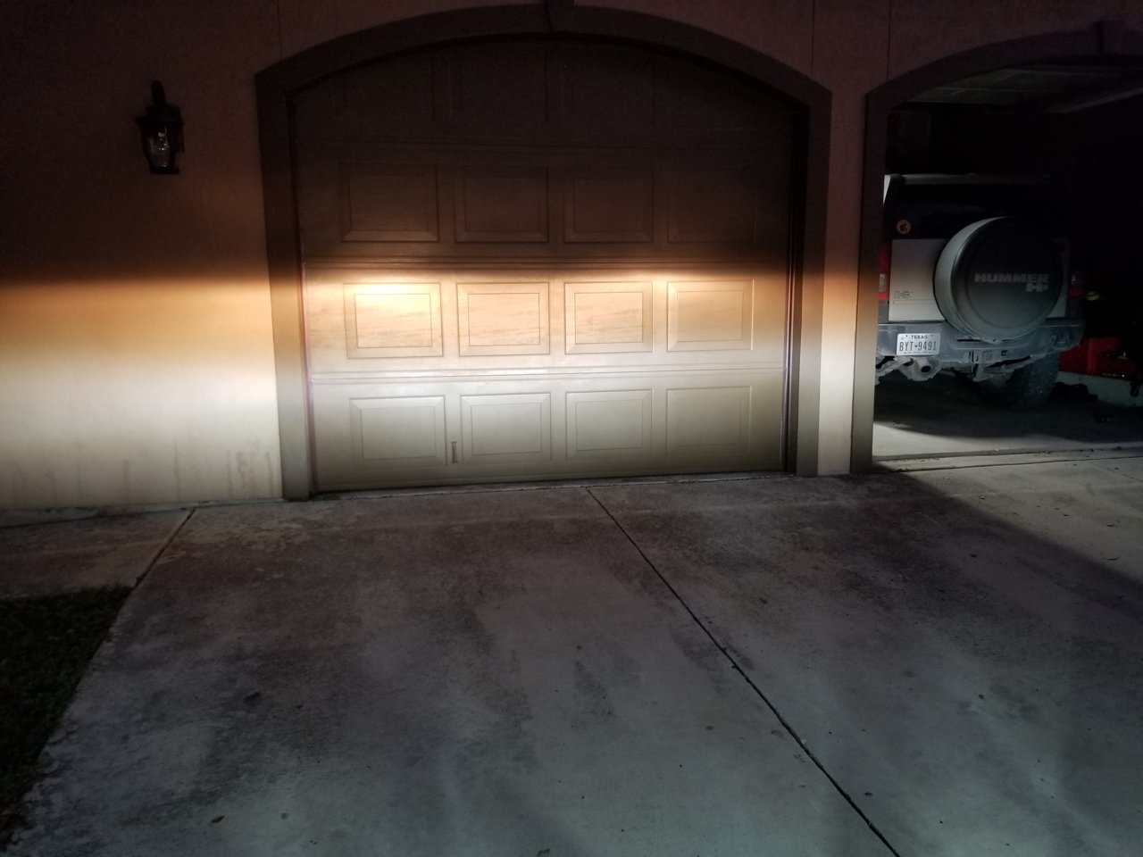

    I have a set of Stedi lights. I like them so far. I put them on around Jan. I haven't gotten around to hooking up the daytime running light halos yet, but the main lights work great for my needs. In the pic you can see the color vs my factory headlights w/ factory bulbs. They probably cost me a little more than going the ARB route, but not too much more. The exchange rate on the Aus dollar vs ours helps. Shipping took a little while, but mine got delayed due to extended Christmas holiday in Aus. I'm happy with them .. no regrets. Good light and super easy install.
