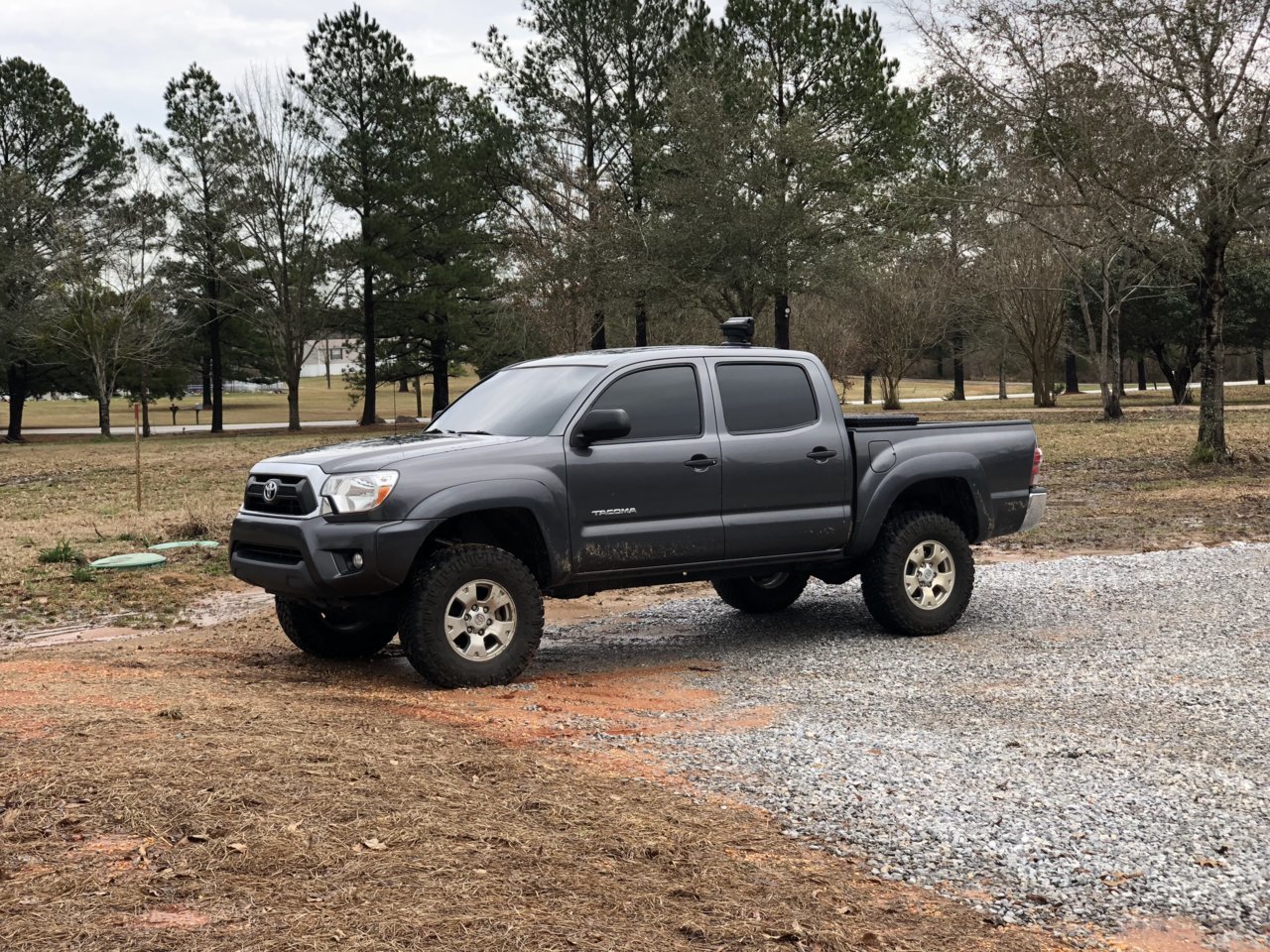

    Hi everybody this is my 2014 DCSB, I have the billies at 2.5 up front with stock coils and a 1.5 AAL in the rear.. it sits pretty much level right now and I like how it sits in a few months I want to get the arb diluxe bumper with a winch on it and that’ll add I would say 170# (110-120 on the bumper and 60 on the winch) My thing is I do not want it to sag at all and I want to keep my height where it is, what do I need to do? Can I just upgrade to heavier duty coils ( like the 886 coils)? Or do I need to get a bigger lift say a 3inch so it’ll sag back down to 2.5 with the added weight? Thanks for the help in advanced.

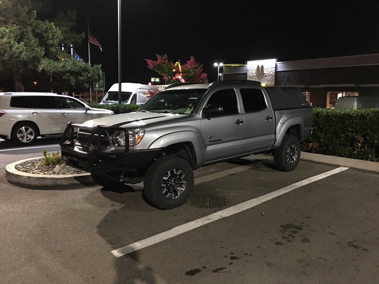

    Jon
    Olympia
    886, no winch yet, and OME firm struts. But x4 on the above statements.
    Pic so you can get an idea of what it’ll look like.
