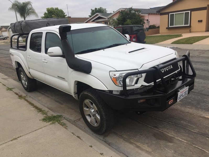

    looks like poop lol
    heres mine as i havent cut it yet, trying to get it setup more correctly for my 1" body lift before i go cutting my bumper.

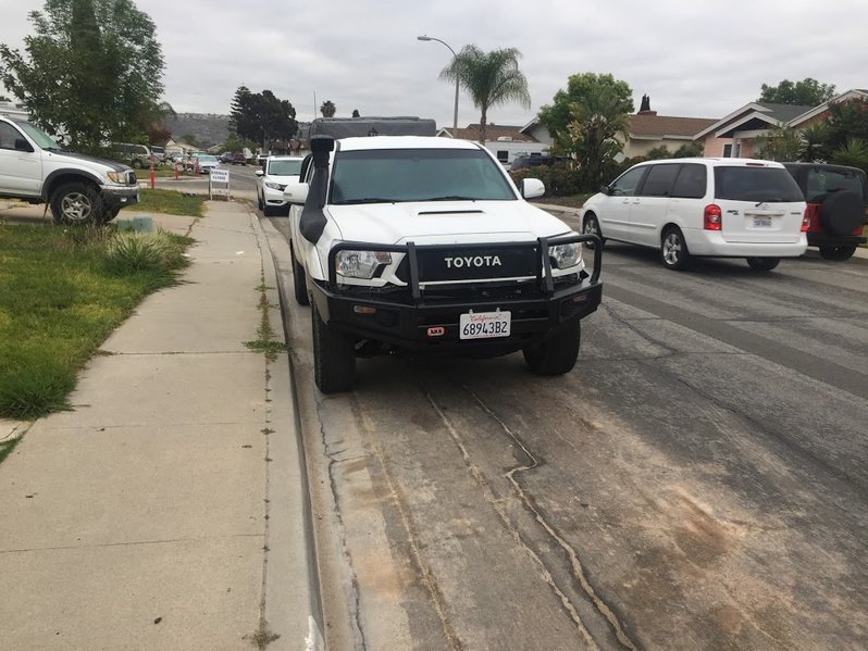

    I've seen the 05-11 ARB fit on a 12-15 front end more snug without cutting the bumper.
    Bad pic but here's a 05 on a 12. You can see the gap is a lot smaller.

    @sr5vic OK, that looks really nice. That's the way they should all look. I'm not sure that I can make mine look the same, but I'm willing to give it a shot. I bought the 12 - 15 model not the 05 - 11. So now I need to figure out how to make it more snug.

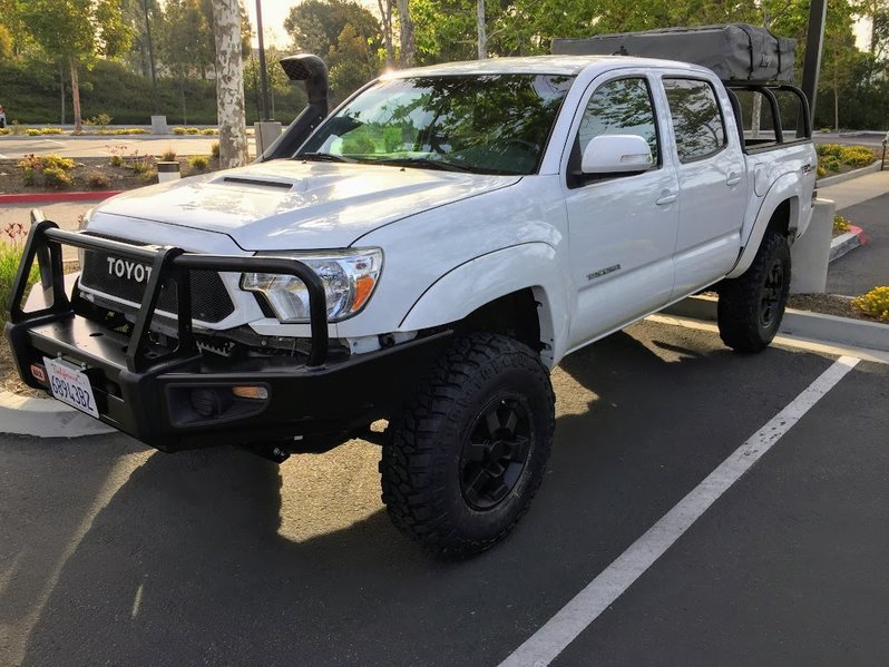

    Unfortunately, I don't have too many good closeups, but I used Duplicolor bumper coating paint which gave it a matte / satin black look and it blended in quite well. You should have the same luck with a dark green truck.

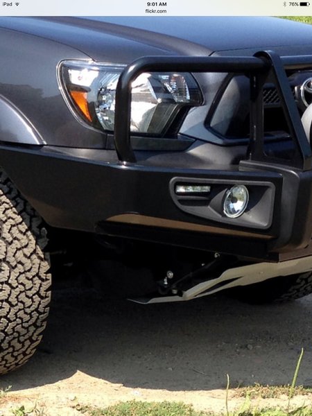

    @MikeyMcFly I zoomed in on your truck picture. Did you tuck the plastic under the steel bumper? Here is the closeup view.IMG_0006.jpg
    BTW, it looks really good.

    It fit inside the opening. All I did was take ARB's measurements and simply added about an inch of extra length allowing it to tuck a bit more inside the gap. I figured you can remove material if it doesn't fit but not add more if there is a gap.
    The aftermarket bumper cost me approximately $95 and was well worth it imho.
    EDIT : The lead pic you used has the bumper set WAY low. You can adjust the bumper to flare gap a bit but that one looks huge. I set mine enough that it can flex but not enough it looks ill-fitting.

    They installed it wrong. Per ARB the piece goes inside the metal of the bumper like in my photo. Look on ARB's site of their truck.
    I'd go back and have them reinstall it correctly.

    That's exactly how I did mine. Cut edge was hidden by the bumper.
    EDIT : To answer your question, I had a 12-15 bumper on my '13.
    There is a height adjustment in the bumper so I suspect they sat it lower to allow for the plastic to be up above.
