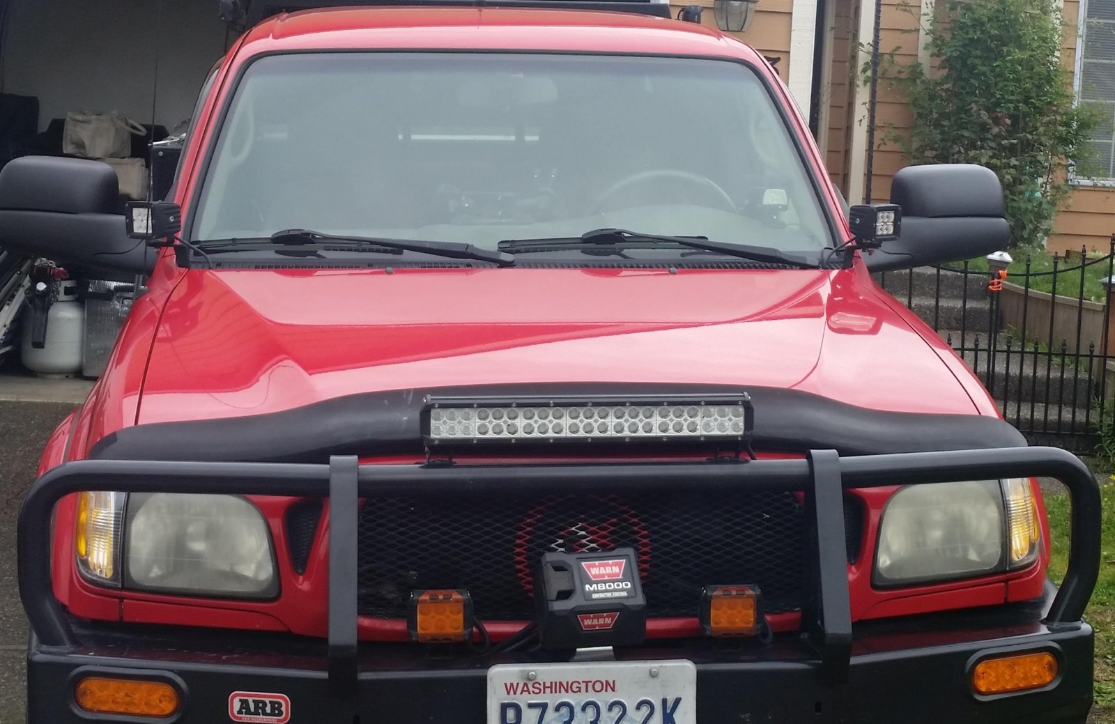

    I have a pair of cubes on the bumper, and a 20" bar up on top.
    The cubes in the pic have since been replaced with a pair of SAE fogs in a similar cube form.
    The one on the bar really doesn't stick up any farther than the bug guard, and I don't notice it driving down the road.20190521_160026.jpg

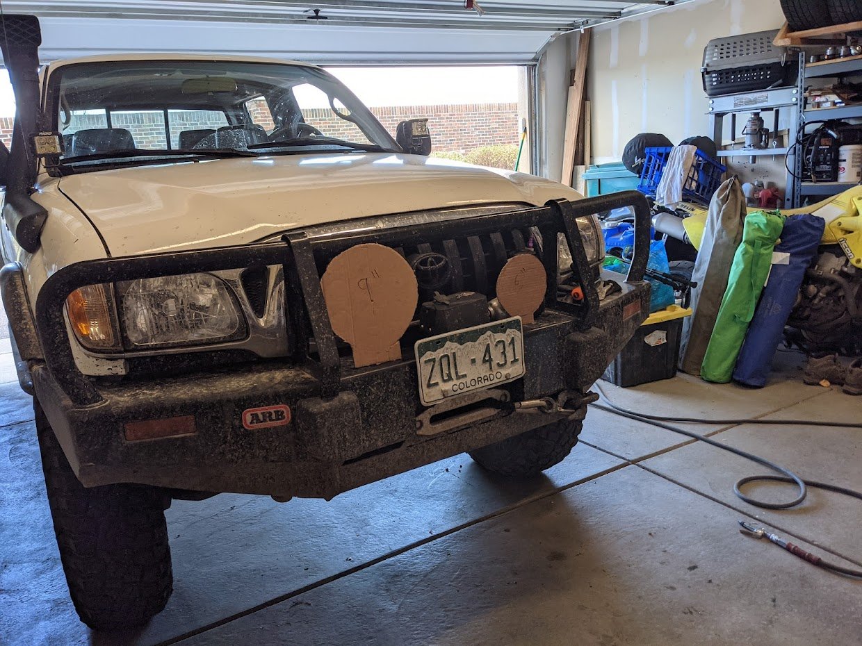

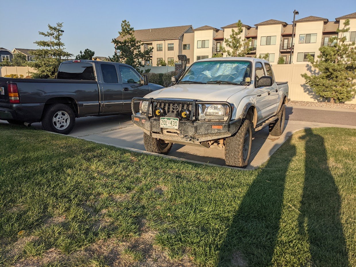

    Recommend some round ~6" LED lights, I think they look best with design of the rest of the truck. KC has some really nice options available.

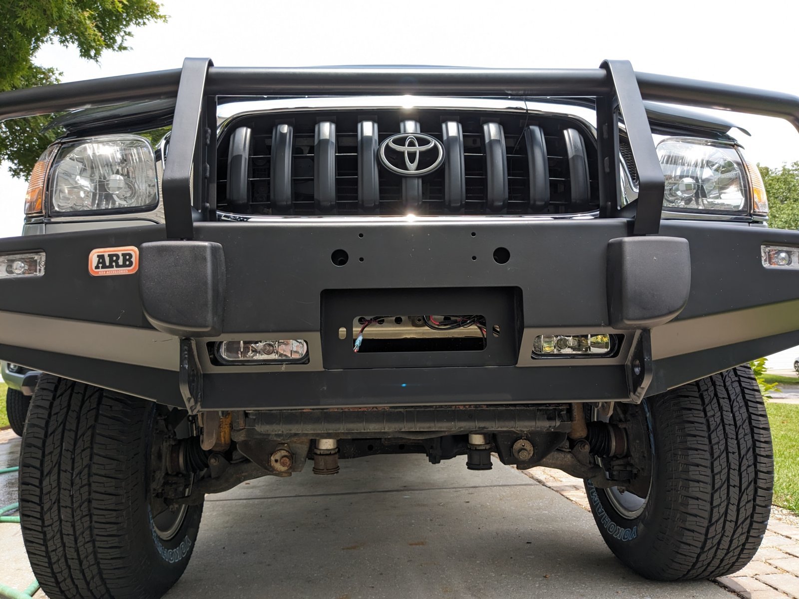

    Update to this since I said I would get pictures after I got the car back from the shop. Here you are:
    I used a Nilight wiring harness since the Hella one was basically a relay, a spool of wire and a "have fun". They're 55 watt and throw out pretty far. They're a little bit shallow probably due to the tabs of the bumper blocking some of the light on the left and right sides, but I don't really mind. These are great if you're concerned about getting pulled over for the lights being mounted too high up or don't want to cover them up when using them on public roads. My state has a height requirement - 12-30 inches off the ground max - otherwise they have to be covered up unless you're using them offroad which is why I mounted them where I did. Mounting in front of the grille would be over the 30" mark.
