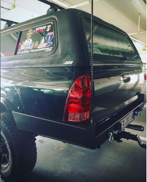

    Here's a pic of my high clearance bumper I got built by some Italian's out here. They took two months though. Two months without my truck was painful.
