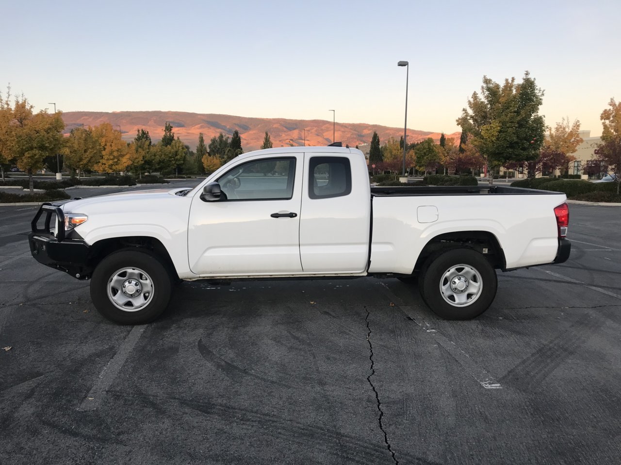

    It was on the truck when i bought it. Only reason i keep it is because i dodge deer all the time and am sure to hit one and hope it helps.

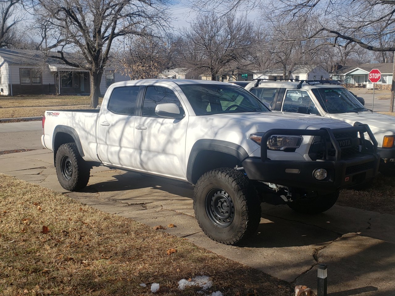

    Love ARB bumper but this install was a pita theres alot of trimming

    absolutely a perfect truck in my opinion. Well done! I like how yours doesn’t look like there’s quite as big of a gap between the bumper and the flare. Not sure why some have such a big gap there?

    The mount bolts have slots where you have some adjustments. Final assembly is that you would drill 2 holes per side to lock it in. Before i drilled those locked holes I push it up and back against the flare as possible to eliminate the huge gap.

    ahhh gotcha. Well it turned out amazing. Love it.
