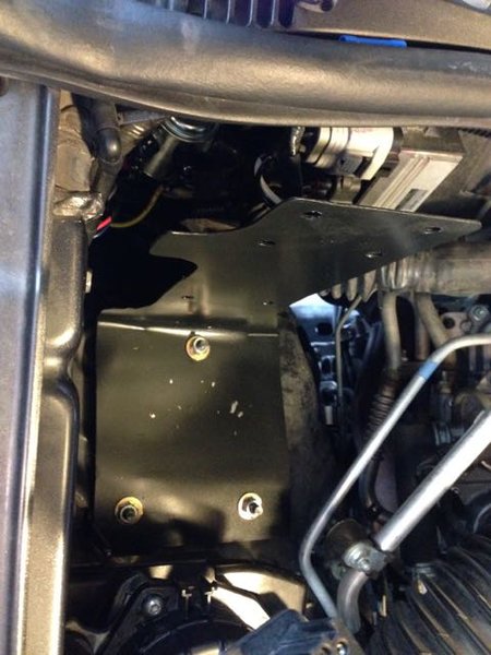

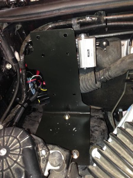

    I mocked up the bracket with a piece of cardboard first using the mounting diagram that came with compressor. Then I bought a piece of pretty stiff sheet metal from Home Depot. (sorry I don't remember the gauge). I cut the sheet metal with a cut off wheel on my Dremel, and then used a vise and a rubber mallet to "bend" the metal.
    Once that was complete, I just drilled the holes for mounting the compressor. (again the diagram in the instructions helps here) and drilled the holes for mounting the bracket on the top of the fender. Luckily the bolts were already on top of the fender, so I was able to reuse them. It's really pretty easy you should be able to do it without any problems.
    One other nice thing about where it is mounted, is the factory cables that go to the battery are the perfect length.

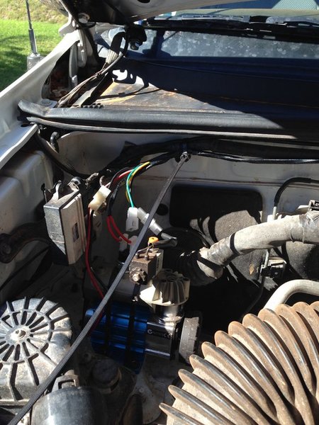

    Mine works great in that location

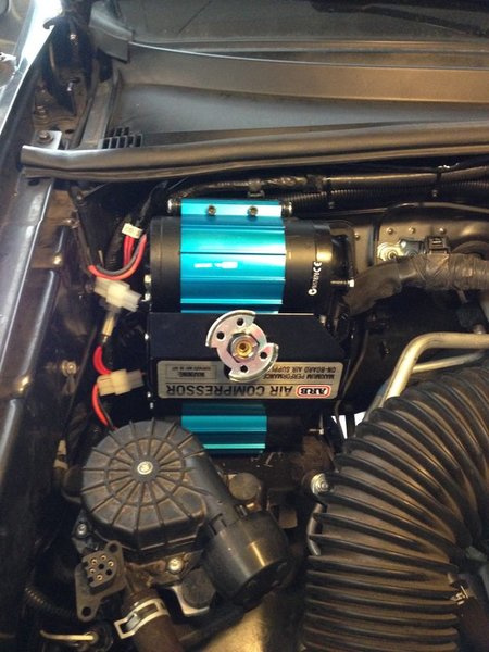

    So far there have been no issues. I haven't had any problems with rattling/vibrations. Here's the installed pict.

    Looks real good. Glad to hear no vibrations!
