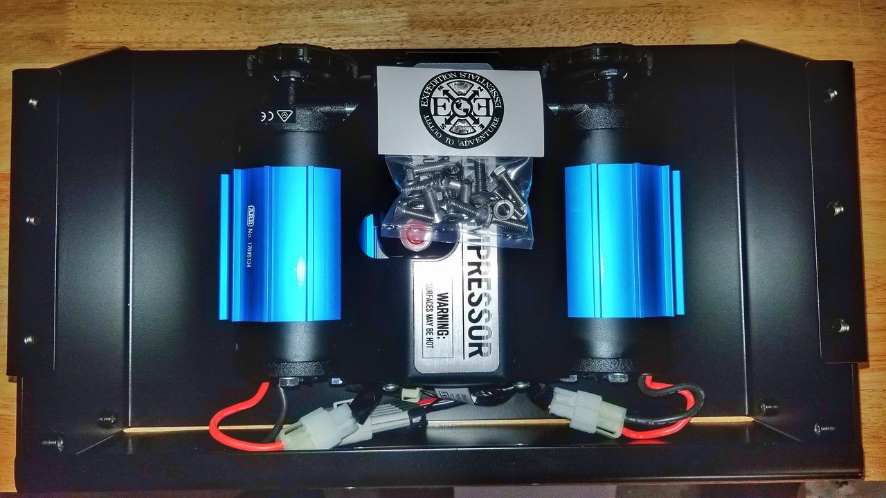

    17" Method NV w/BFG KO2 CVT Rainier RCI bed rack Empyre Off Road grille Cali Raised bumper light bar/fogs
    No. The air inlets are at the top of the compressor, and the box is pretty stout and makes a great splash shield. You'd have to basically submerge your rear end to be enough water that high.

    I used (i think slee) mount. super easy setup.

    This is what I use. I like it because it's closer to the battery.

    Stuff and things
    What did you do to extend and route the wiring to the engine bay?

    Soldered wires and ran them up. Expedition Essentials just started making plug and play harnesses though.

    Thinking about doing the same thing also. Did you just lock it down with nuts and bolts? I'm a little worried due to it being plastic.

    tacomapros.com mounting bracket. 05-up mounts behind dc rear drivers seat, I have one
