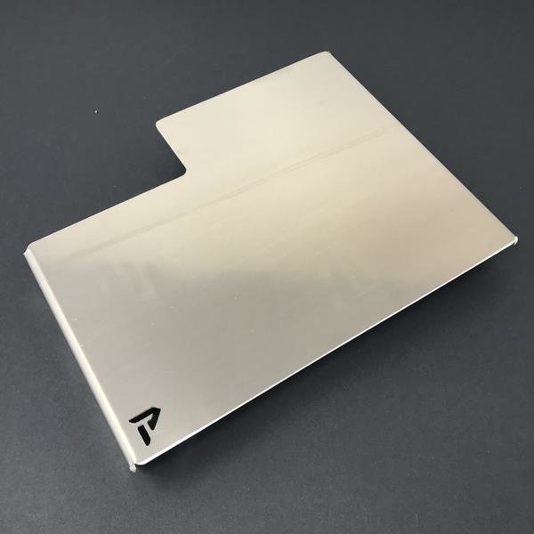

    I mounted my single ARB compressor on a Power Tray. Fit perfectly between the fuse box and reservoir on my 2nd gen. Sorry no pictures. I’m out of the country.
    https://www.powertrays.com/products/1-blank-powertray

    I was going to say that I’d be surprised that you’d find the room for the tank, but after seeing your install I’m convinced you’ll find it. I mounted my single ARB comp on a PowerTray behind the fuse box horizontally, but you maximized the use of the space very well!
