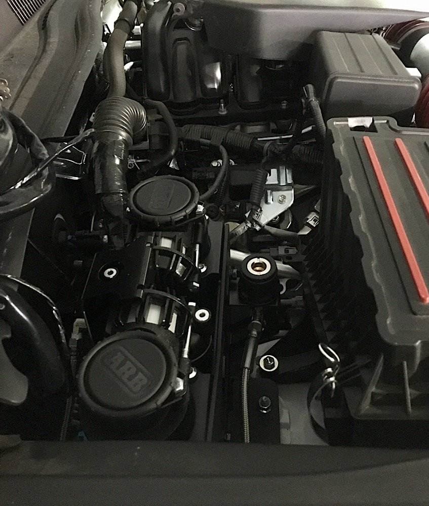

    Hi all,

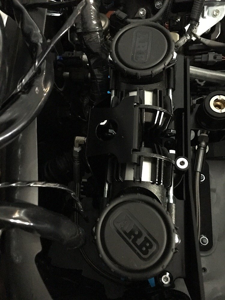

    I’m installing a dual compressor in the engine bay in the space where people often install a second battery. You know the spot. Anyhow, the CBI mount that I am using seems to push the compressor up against the main wiring harness that goes through the firewall right there. (See pics).
    Does this compressor get really hot during use? Do you think the harness will be okay right up against the compressor like this?
    Thanks

    I would find a way to secure the wires out of the way. I wouldn't want that much heat against the wires.

    It will get quite warm, I agree that securing the harness back out of the way would be the safest bet to prevent any melting or damage.

    Also not a fan of mixing vibes with wires.
    I'd try and figure something out.

    Thanks Gents. Moving this harness could be difficult. It's rather formidable. Hmm. I'll uninstall the compressor and see what I can do.
    I hadn't thought about vibrations. I agree. I don't like that either.

    I'm planning to add a Four Wheel Camper at some point, so bedside cubby will be no go for me.
    If I can't muscle this harness suitably out of the way, I'll likely end up paying someone to modify this bracket to move the compressor away from the firewall a bit. I do really like this install location, I just wish this bracket was plug-and-play for a 2018 Taco. It's almost as if this wiring harness wasn't in the truck that cbi used to develop the mount. I'll probably give them a shout to let them know of the issue.
    My backup, backup plan is to use a mounting bracket I bought that will mount it between the radiator and grill. I had hoped to use this spot for something else, but it may need to happen otherwise.

    In your case, I'd just try to isolate the compressor in the place you have it. Might be a little modification to how that wiring harness mounts but a few zip-ties and some bending will go a long way. The location you have is great, on the passenger side (prevents taco lean) and at the top of the engine bay.

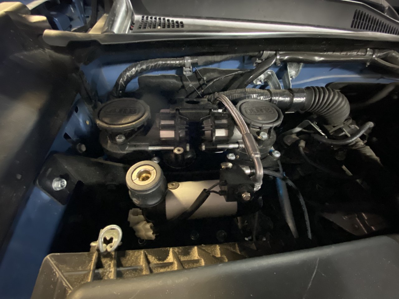

    EDBC0A95-F27F-4478-B7AE-80DEF5A41759.jpg So far so good.
