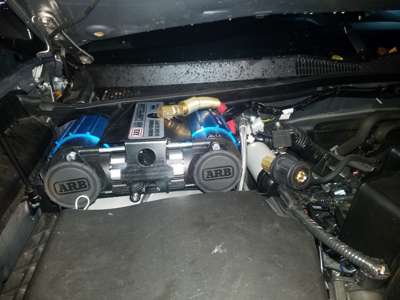

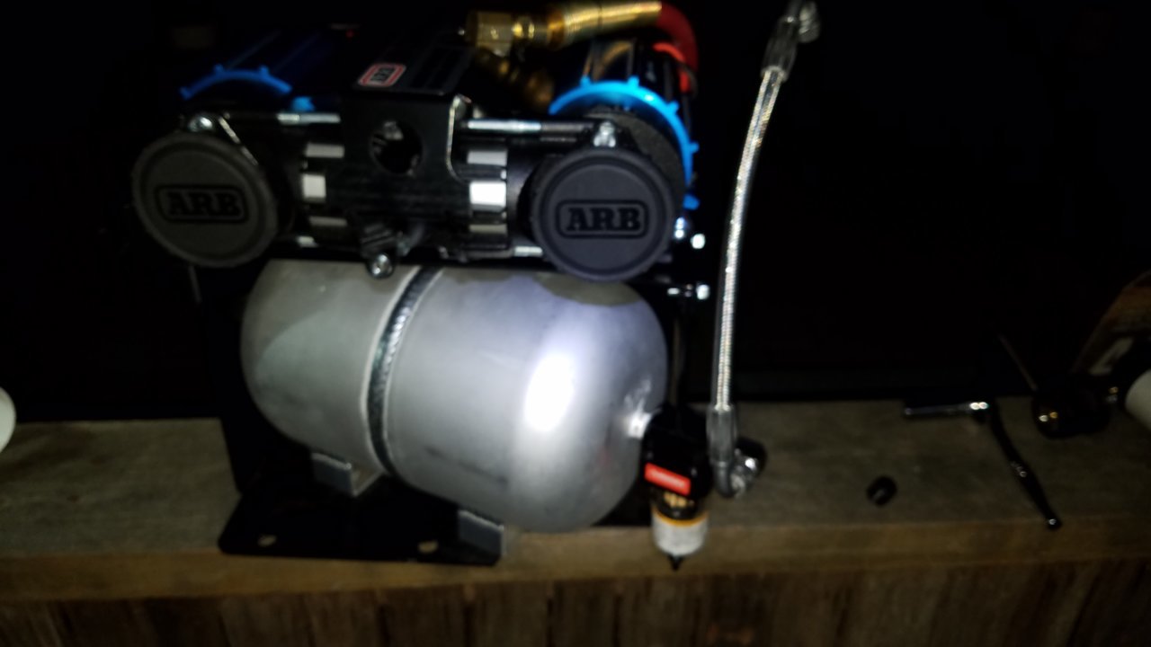

    Yup! I noticed they'll bundle if you order the tank too. Or try the code LETSCRAWL. The fittings weren't plug and play. Definitely took some figuring out.

    Looks good. I have a feeling I'm going to mount that external manifold at some point, unless I run lines to each side of the truck... ah decisions

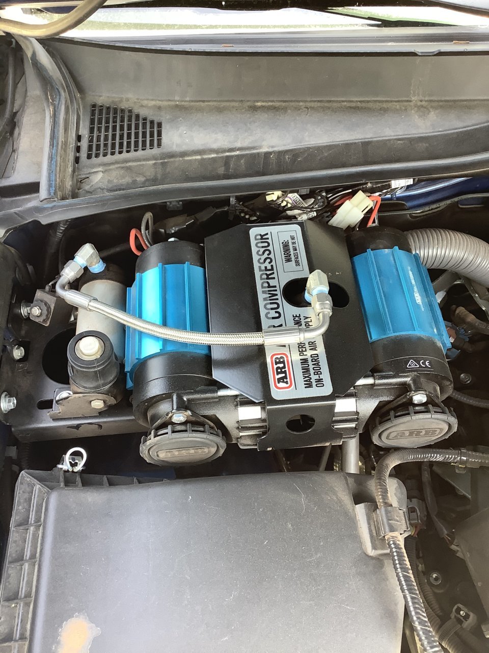

    I paid $490 for my twin ARB and mounting bracket from a dealer off eBay. Don’t recall who makes 7BD650E2-2C42-4932-98F1-BF3FDD4DBABA.jpg the bracket but it’s identical to the Slee bracket I’ve purchased previously.

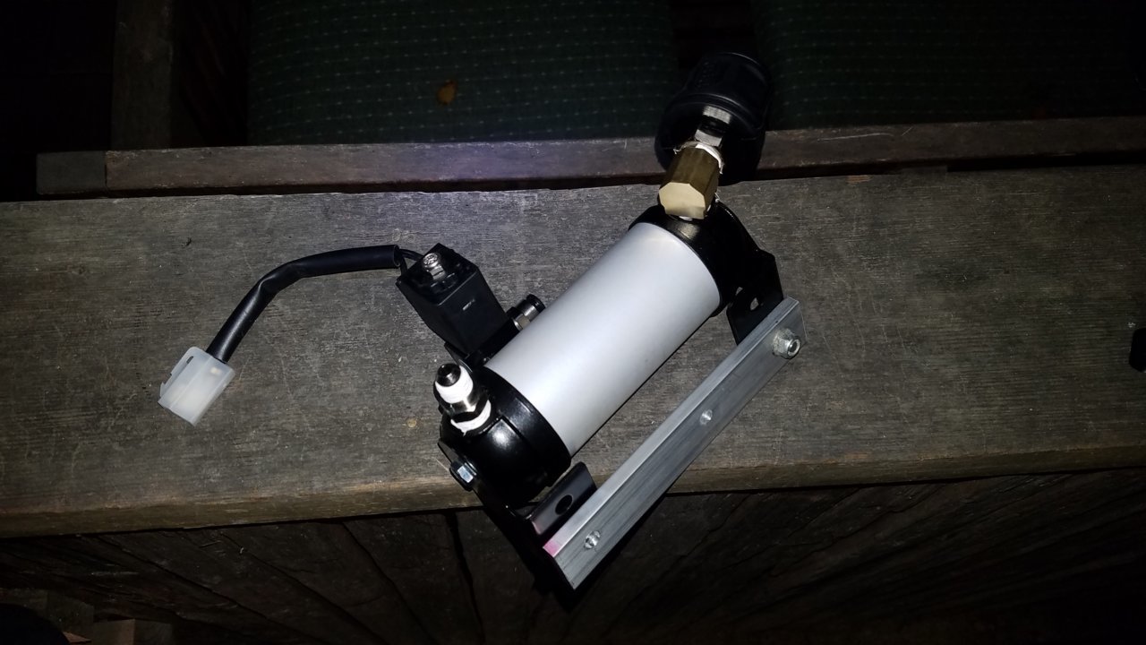

    I'd like to remove one of the extra caps on the manifold, and route an additional line to the rear, so I have front and rear quick connects.
    I go into detail on some parts here:
    https://www.tacomaworld.com/threads/arb-locker-arb-compressor.666716/#post-23383262
    But I believe the only other parts needed, besides the ones listed in the above post, were a couple 90 degree fittings to go into the tank and out of the manifold.
    A picture of the manifold, with custom aluminum bracket bolted to the mount, can be seen below with additional pictures here:
