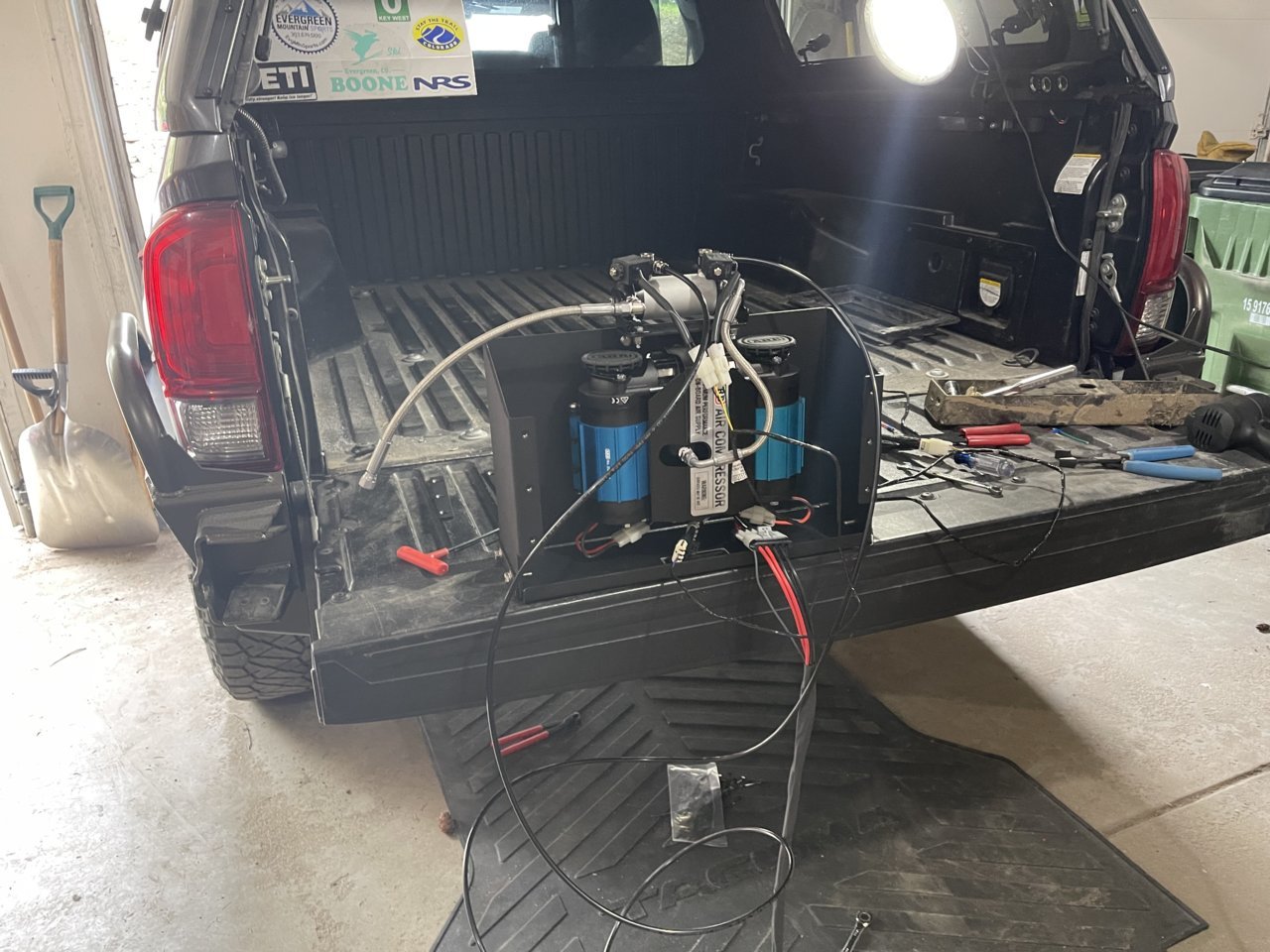

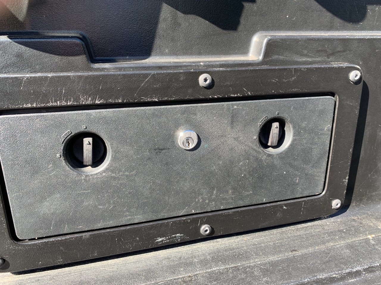

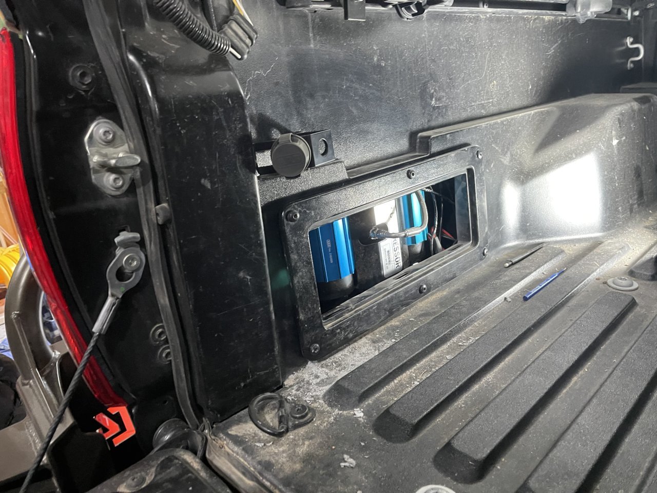

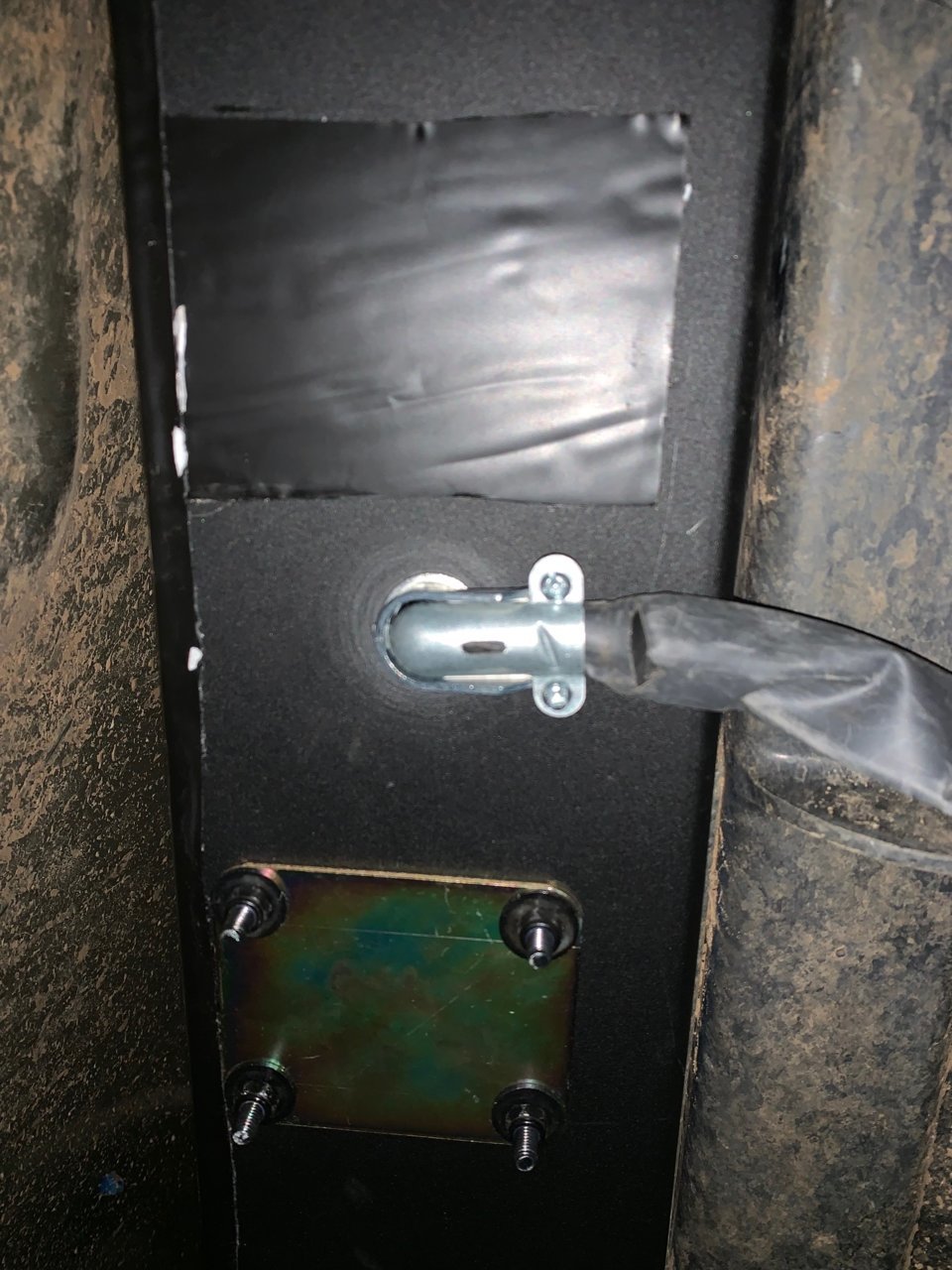

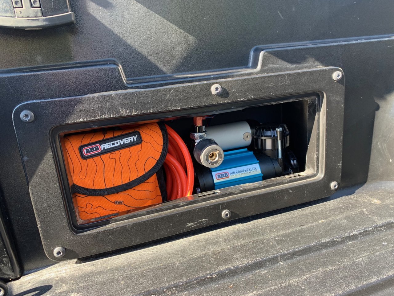

    I used the Expedition Essential cubby mount on the driver's side cubby as well. Very happy with it. If you do, consider sealing the box as much as possible due to dirt/dust getting in there. I ran the supplied extension cable to the bottom of the box and used a 90deg conduit connector to feed it through. I added a lock to the cubby door as well.

    This looks like a very clean install. How did you run the extension cable up to the front of the truck?

    That was probably the most PITA part of the install. I ran it down the engine bay (under the brake master) and away from the hot parts and then along the frame. The length of the cable from the factory was just about perfect meaning not a lot extra length so make sure you don't leave a lot of slack anywhere or you might not have enough at the end. If you enter the box at the forward end you will have more cable by I wanted to enter from the bottom so I could mount the compressor as far forward as possible for storage of hose, etc. in the box.
