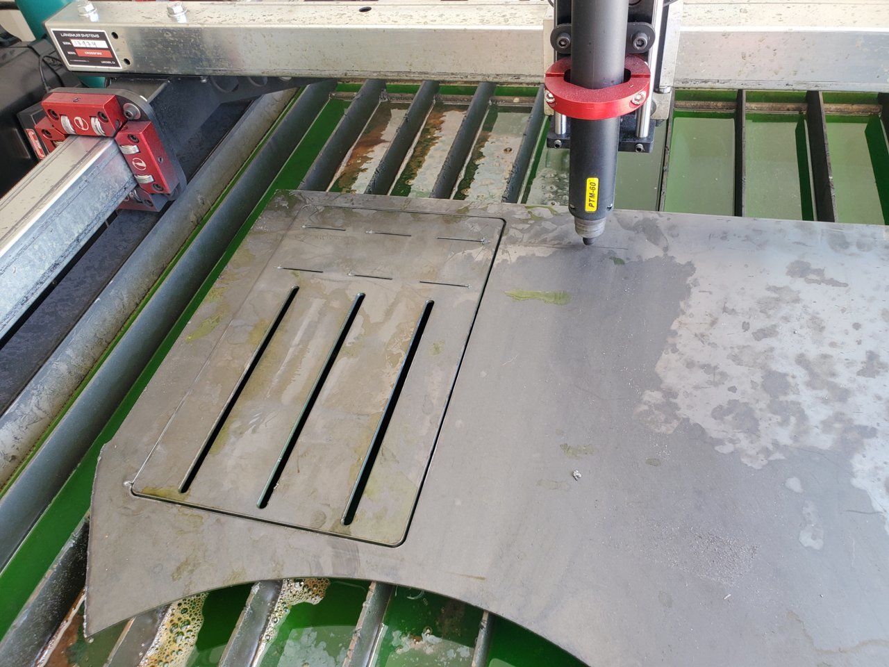

    Wish I had a machine to do it with! I just bought a small sheet of steel at home depot and used my angle grinder to carve out the design.

    Oh it's how I did things at my first fab shop; I'm too cranky to work like a Neanderthal anymore :rofl:
    But yeah angle grinder with the right wheels can get a lot done!

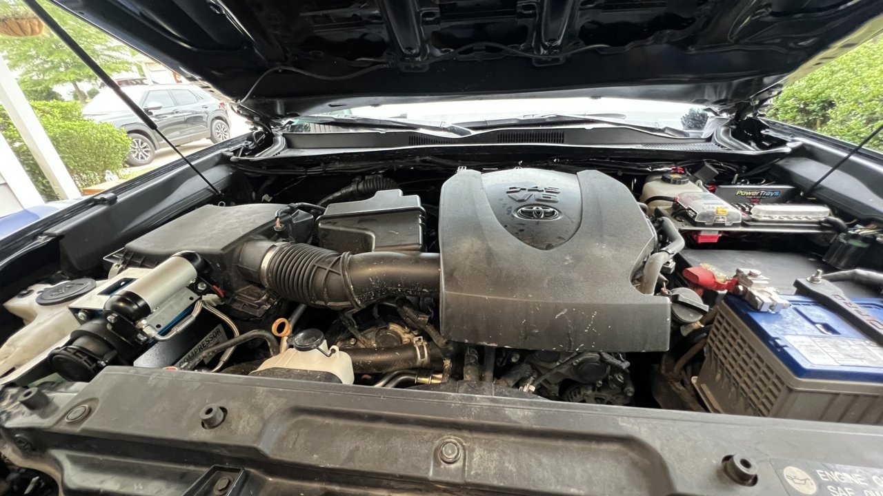

    SOB…wish they had that a few years back!
    I used the 2nd Gen mount (which works) but tight af to get both my hands in there

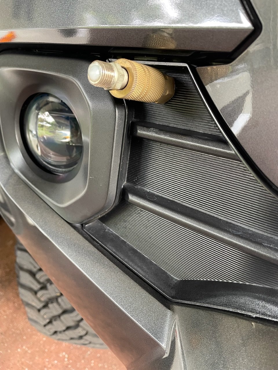

    On the bright side, that external fitting looks awesome.
