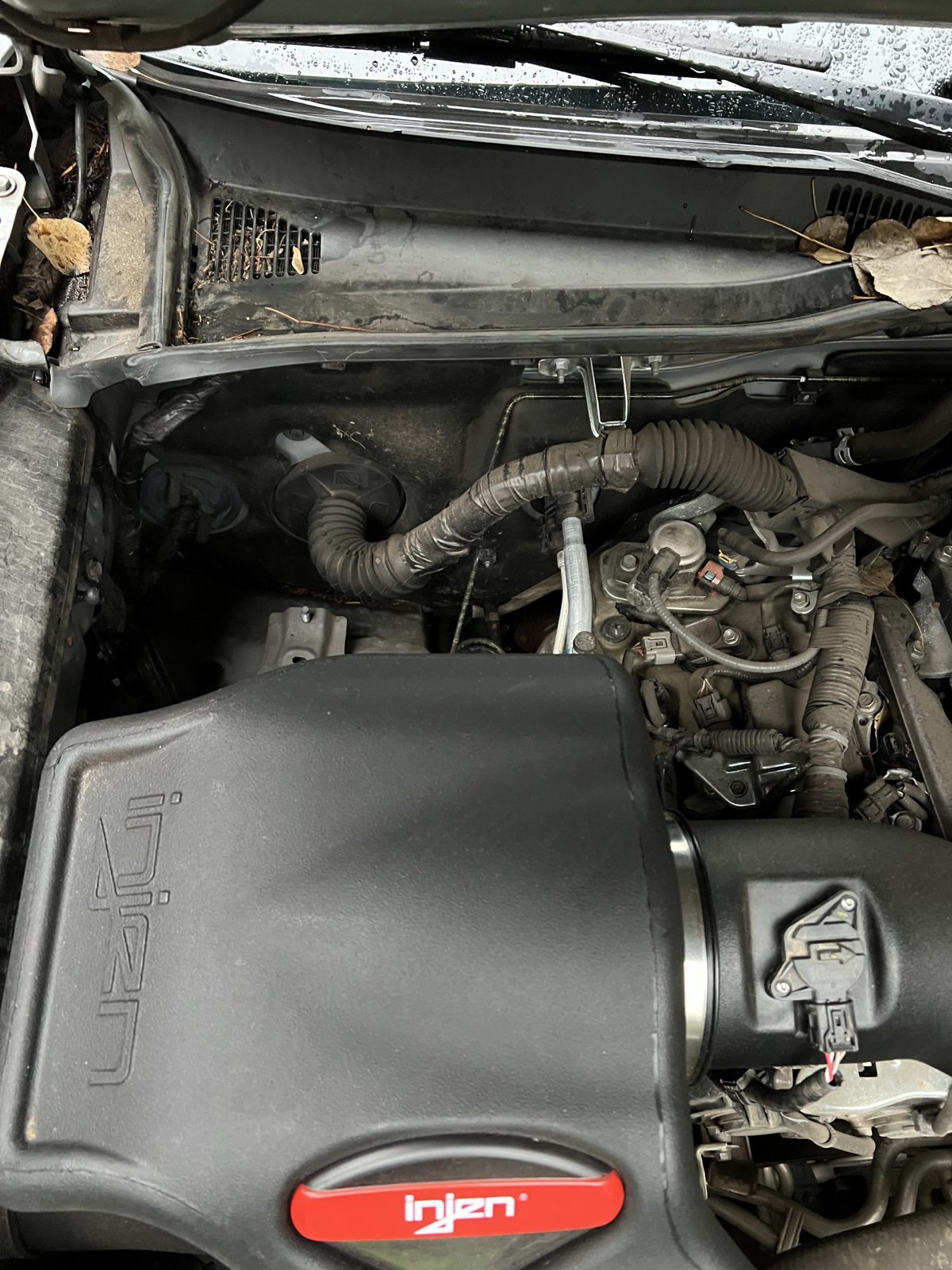

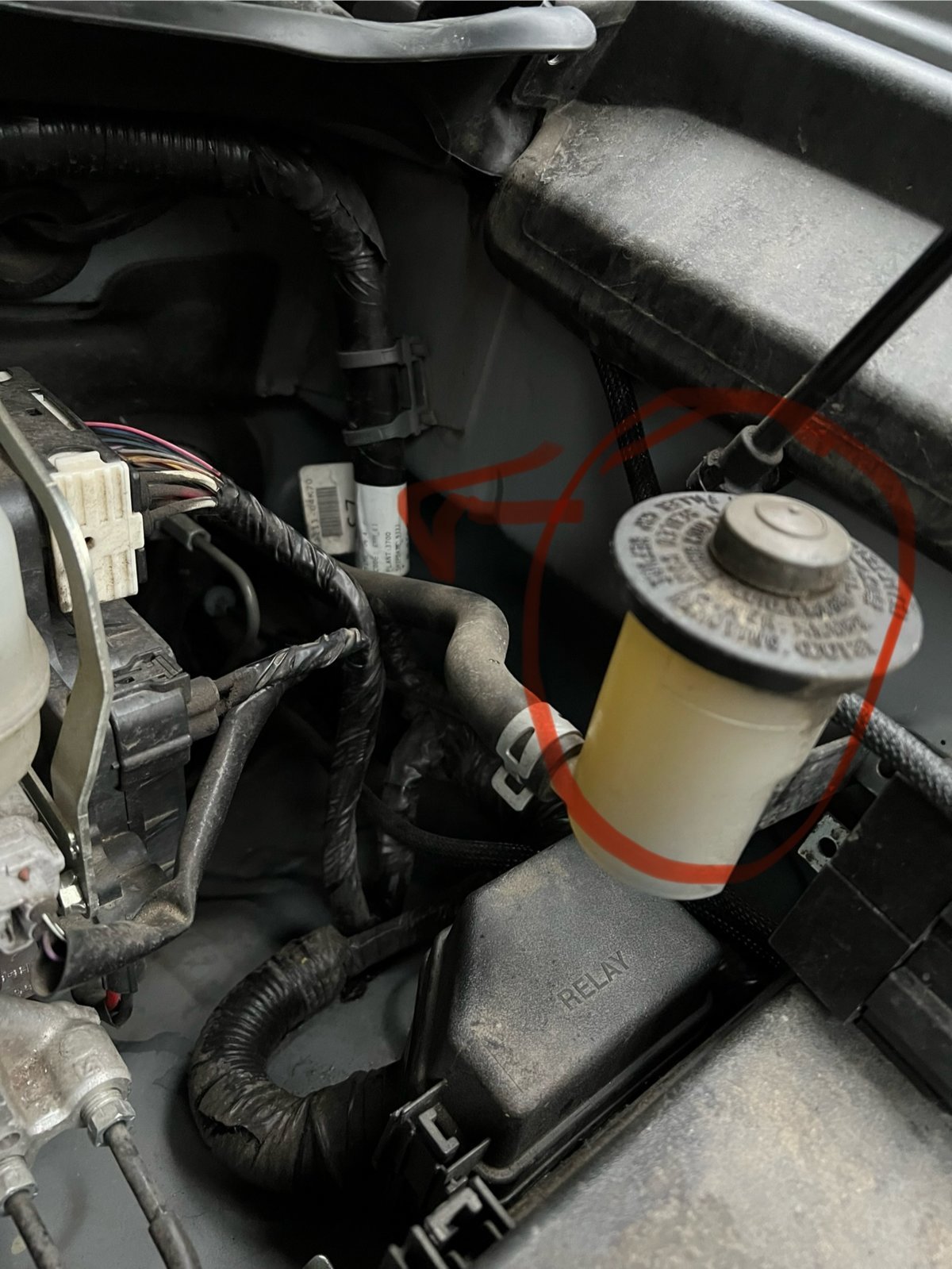

    I have the ARB twin compressor i am getting ready to mount and I have both the Rago and MORE under hood brackets. The issue I am having with each of the brackets is, the Rago is not compatible with the manual trucks, and the MORE appears it’s going to be too tight with the Injen cold air intake box. I was wondering if anyone has had success moving the brake booster resi (I think that’s what it is) that would seemingly allow me to run the Rago mount. Given the options I have, that seems like the path of least resistance. I was wondered if there is anyone else has any ideas.

    You mean clutch fluid reservoir?

    I noticed it was dot fluid and assumed it was brake related. I feel like I have seen it listed as both a brake booster and a clutch fluid reservoir. Either way I could move it down and back, I think, shortening the line and opening up the area for the Rago mount.
    I had not see the Slee mount, though the situation looks the same as the More mount, behind the intake box, which the Injen I have is larger than stock, further reducing that space.

    These are the challenges I’m up against.

    That's the clutch reservoir.

    Copy. Is the clutch reservoir able to be moved towards the firewall, simply shortening the hose and moving where the bracket is mounted?

    Yes.

    You can move the clutch reservoir as needed. Moving the bracket may entail drilling new holes in the inner fender and putting in rivnuts.

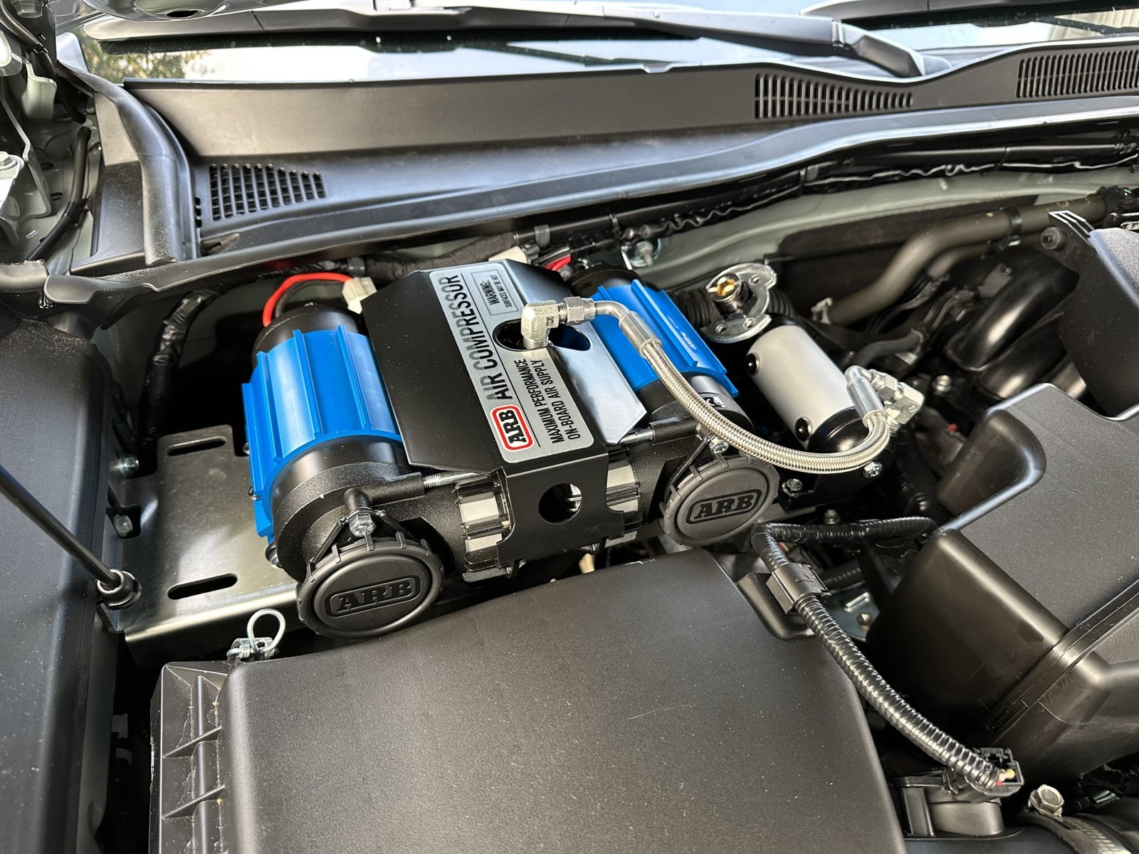

    One of my favorite and most used mods... works a treat. Having used a cheap portable pump, I won't go back.

    That looks good in there!

    You could remove the clutch fluid reservoir entirely by going to the combination brake / clutch reservoir found in the Sport. Having a Sport, I did the opposite by installing a separate clutch reservoir.
