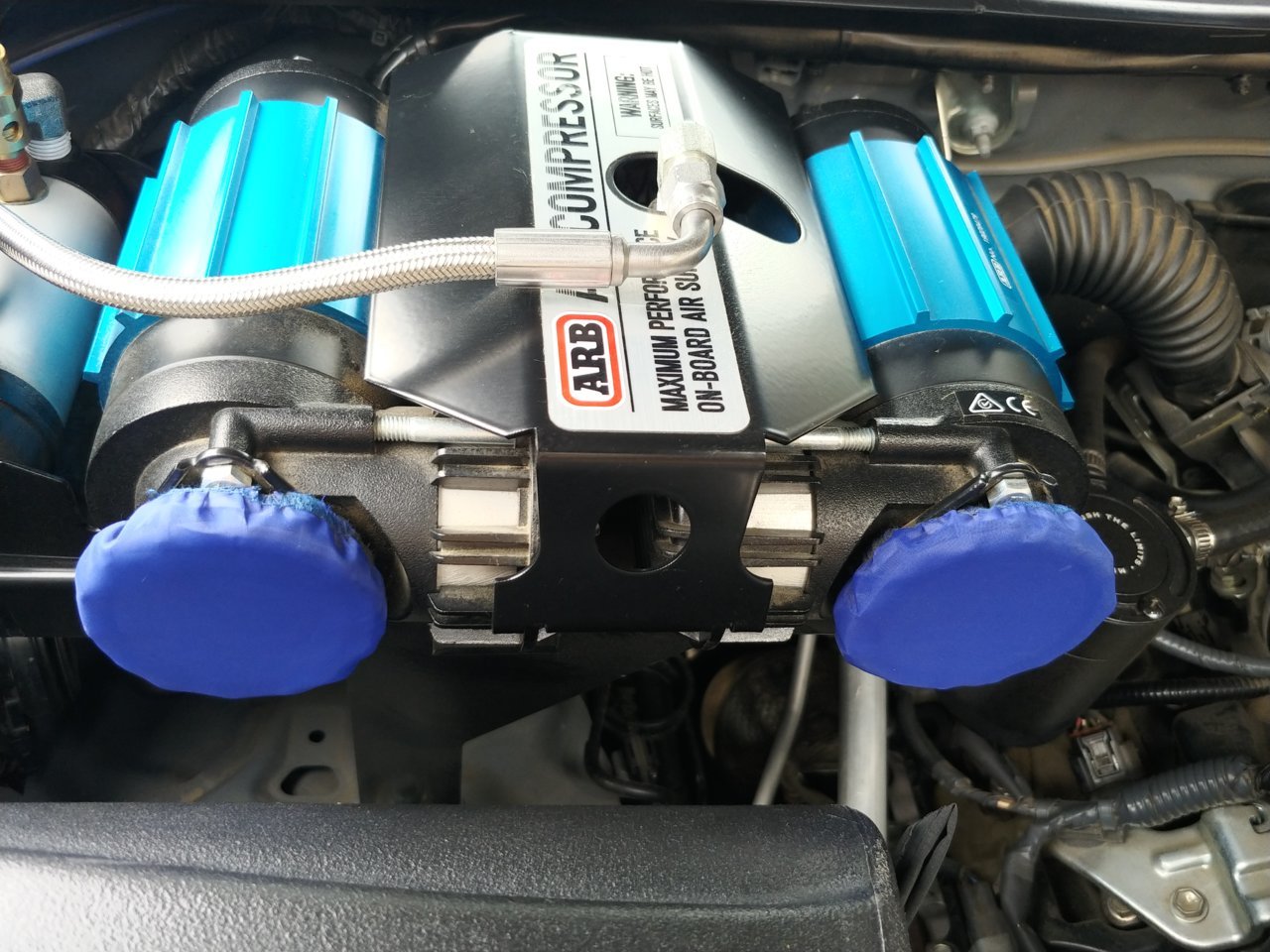

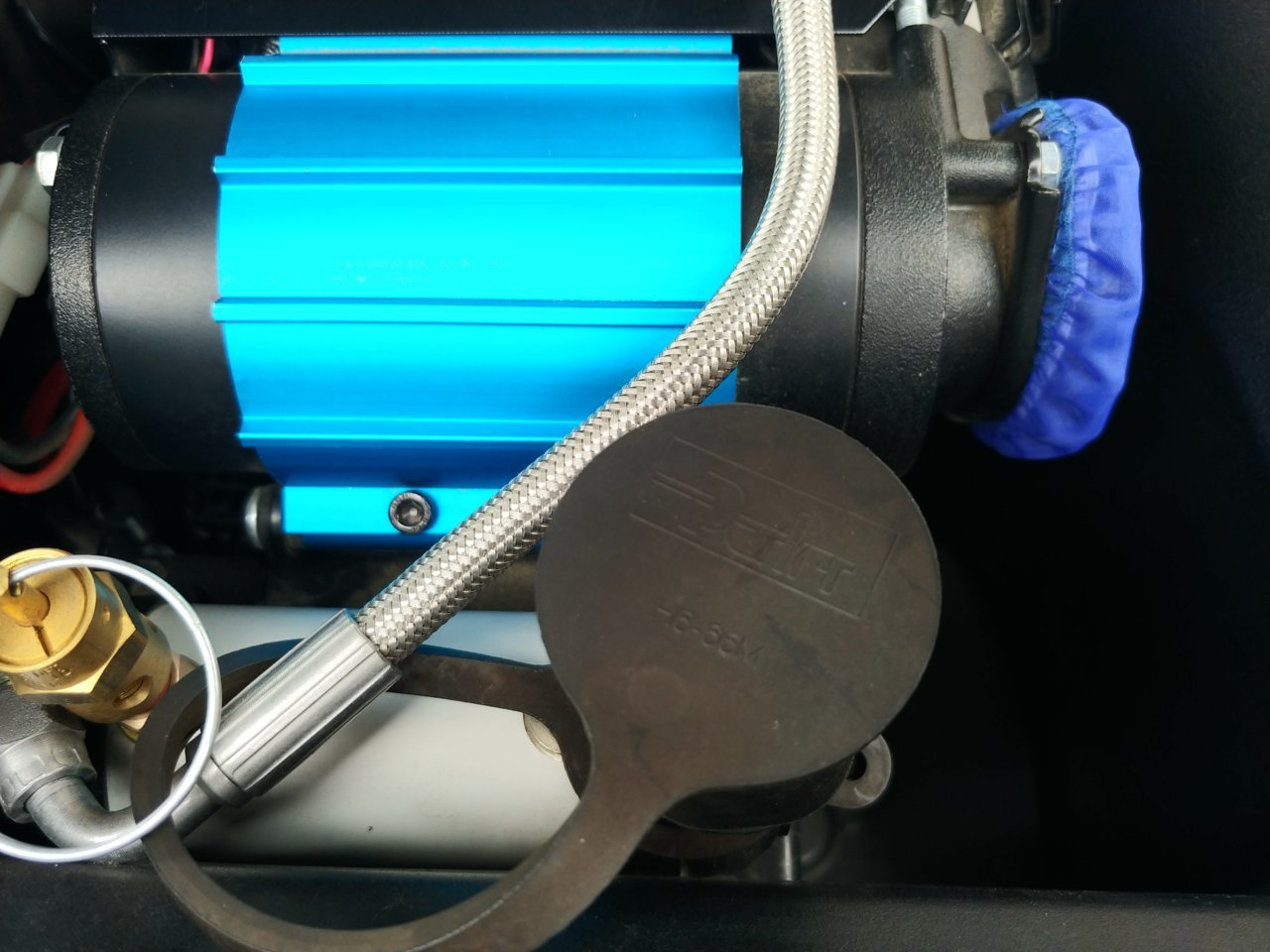

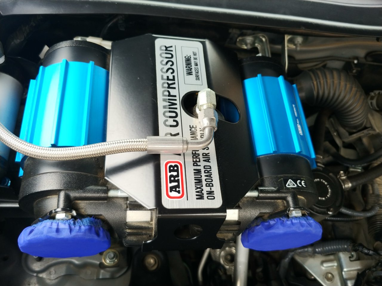

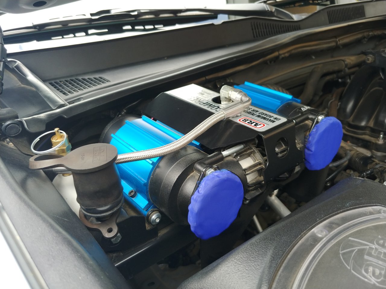

    Just thought I'd share this with anyone that has an ARB Twin or Single compressor, I found these filters that fit perfectly over the stock filters. I've been using them for over a year now and they're great, easy to clean and comes in an assortment of colors, they're also water resistant so they'll keep water out of the comp if water splashes up there or if you're crossing a stream.
    Filters are from Outerwears, buy the 4 pack as they're the same price as 2 individual ones. You can keep the extra 2 as spares or split the cost between a buddy.
    Part number for the 4 pack is: 20-1425 BOOTIE
    Link to part: https://www.outerwears.com/proddetail.asp?prod=23451
    Also the cover over the ARB coupler is from Parker. Part number: H6-66M
    I picked mine locally from Grainger for $8. A lot cheaper than the ARB one and IMO, does a better job of keeping dirt and crud out.
    https://www.grainger.com/product/31...d0c679462f15e4e5e05ecb77401251e4a3439cca65522
