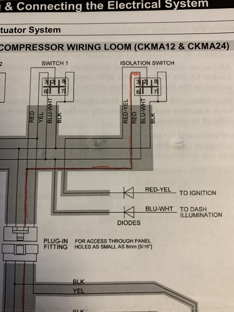

    That’s not a good thing to do when it comes to climate control stuff. If you really wanted to tap into power there, you should be looking at the schematic. I’m gonna take a wild guess that you tapped into the white/blue wire, which is the ground circuit for the blower motor. The low voltage you got was after it went through the blower motor. It would be much safer to use an add a fuse in the fuse box.

    I ordered an add a fuse last night and will be running it over to the fuse panel under the dash

    So not exactly sure what the initial issue was but added the add a fuse today and all is fixed. Meant to take a photo of the wire I had tapped into but forgot to. Thanks for all the input.
