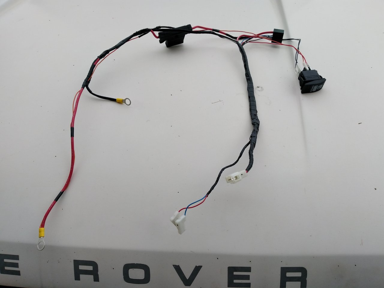

    I need some help figuring out how to wire my the ARB compressor I just installed. The supplied harness is great if I wanted to hook up the compressor and locker solenoids with all the integrated switches, but I don't. I am only using it for tire inflation and don't want to run wiring into the cab and cut the dash up to mount a switch. I have to pop the hood to hook the air hose up anyway so it just makes life simple to have the switch there as well. The easy way is just simple positive/negative connections to the compressor with a switch, but I want to keep the pressure switch working.
    Would I wire an on/off switch between the thin black wire from the battery and the red wire running to the pressure switch? That would allow the Dk. Blu wire to trigger the relay and activate the compressor?

    Since this is a prewired harness does it tell you anyplace just which pins on the relay are the coil and which are the contacts .
    A wrong guess will cause some interesting fireworks
    Where do you plan to mount your switch?? under the hood ??
    I would just build what I need and not use this harness .
    If I did not need to run off to work I would draw it out to make it easy

    I don't believe that it'll be that simple. I understand what your trying to achieve, but the switch needs to complete the circuit and "ground" the relay in order for the compressor to turn on. Notice how the thin blk wire is spliced completely into all grounds?
    When I worked my switch up, the compressor wouldn't fire until I tapped into the lighting circuit for the illumination. I'm assuming because it's all integrated somehow through the switch.
    I would treat my on/off switch as the isolation switch and illuminate/integrate the red-yel, blu-white wires somehow. Honestly it would be difficult to make your own harness as the ARB one is very well assembled with the fuse and relay in line.
    Why not utilize the ARB switch mounted to a nice looking panel under the hood and just find an illumination source at the fuse block instead?

    That's an option but I'd prefer not to have 20ft of wiring bundled up where only 4ft is needed. I could cut and splice it all down to an appropriate length but I'd still be left running a bunch of wires for an unnecessary illuminated switch.

    I ended up trimming about 30 linear feet of wire from the harness to get what I needed working for me. The blue-white wire for illumination is deleted as well as all the wiring for the two air locker solenoids. The red-yellow wire was connected to the battery instead of a switched source. I tidied it up a bit after this picture but that's the general idea.
