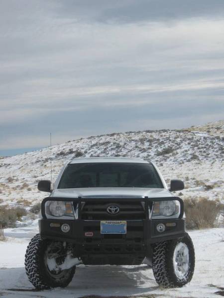

    1. Maybe. There are many options out there (only a few are mentions often here), they all cost similarly.
    2. Not to my knowledge.
    3. Yes, you will only need to drop the skid plate and muscle it into place. 8000 - 9500 should be perfect. Non integrated solenoid.
    The ARB with a winch is a heavy combo you should consider upgrading the front coils if you want to maintain your current ride height.
    ARB
    Relentless
    CBI
    Demello
    Allpro
    Shrockworks
    Road Armor
    Elite Off Road
    I'm pretty sure there are more I can't think of but...
    Find the ones with the lines you like best and go for it.
    I really like my ARB...
