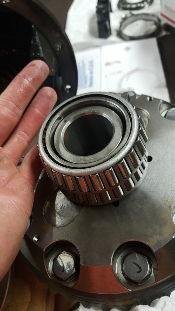

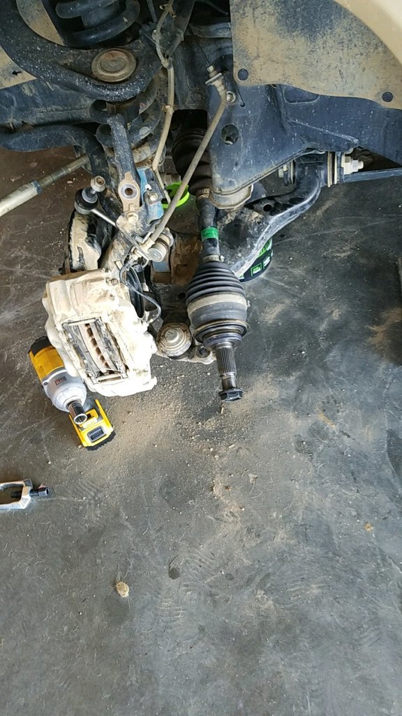

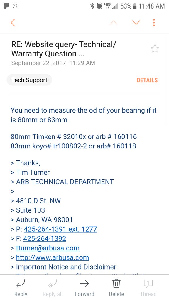

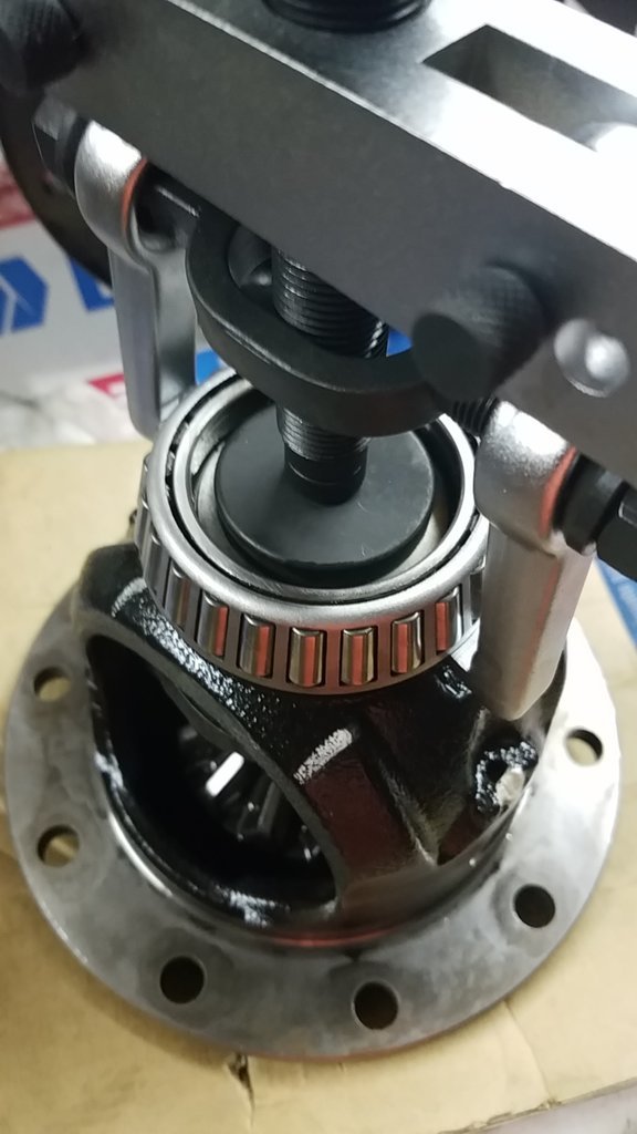

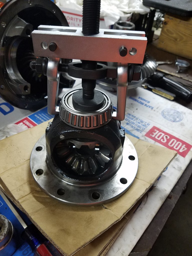

    Finally ARB locker install time.
    Had to order some OTC tools to pull a side diff bearing that doesn't even fit the ARB RD132 :rolleyes:
    Btw, OEM carrier bearings on an automatic no elocker is ID 53mm / OD 83mm. The bearing size you need is ID 50mm / OD 83mm.
    The Koyo bearing can't be found easily, but best bet is Marlin Crawler or ECGS. I got mine from ECGS $90 shipped.
    So now ordering parts for rear I guess and pulling clamshell.

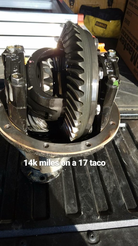

    I realize I didn't post this in the build thread and only in the BS thread soooooo
    How many of you have saw a clamshell outside the truck. They're kinda weird fr.
    Just doing hood rat stuff with my friends..
    Backlash was .004"
    Talked to ECGS today, Koyo bearings for the rear should be here tomorrow.
