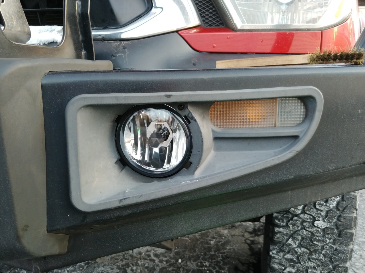

    One of my ARB fog lights burnt out on me last night after 4+ years. Of course the one with a cracked lens full of water is still going strong :rofl:
    Looking at pics online it seems like a sealed unit. No choice to replace just the bulb, must replace the entire thing at the tune of $121 for the set. Has anyone ever come across a way to swap just the bulb? I swear I read about someone doing that but cant for life of me find anything on it

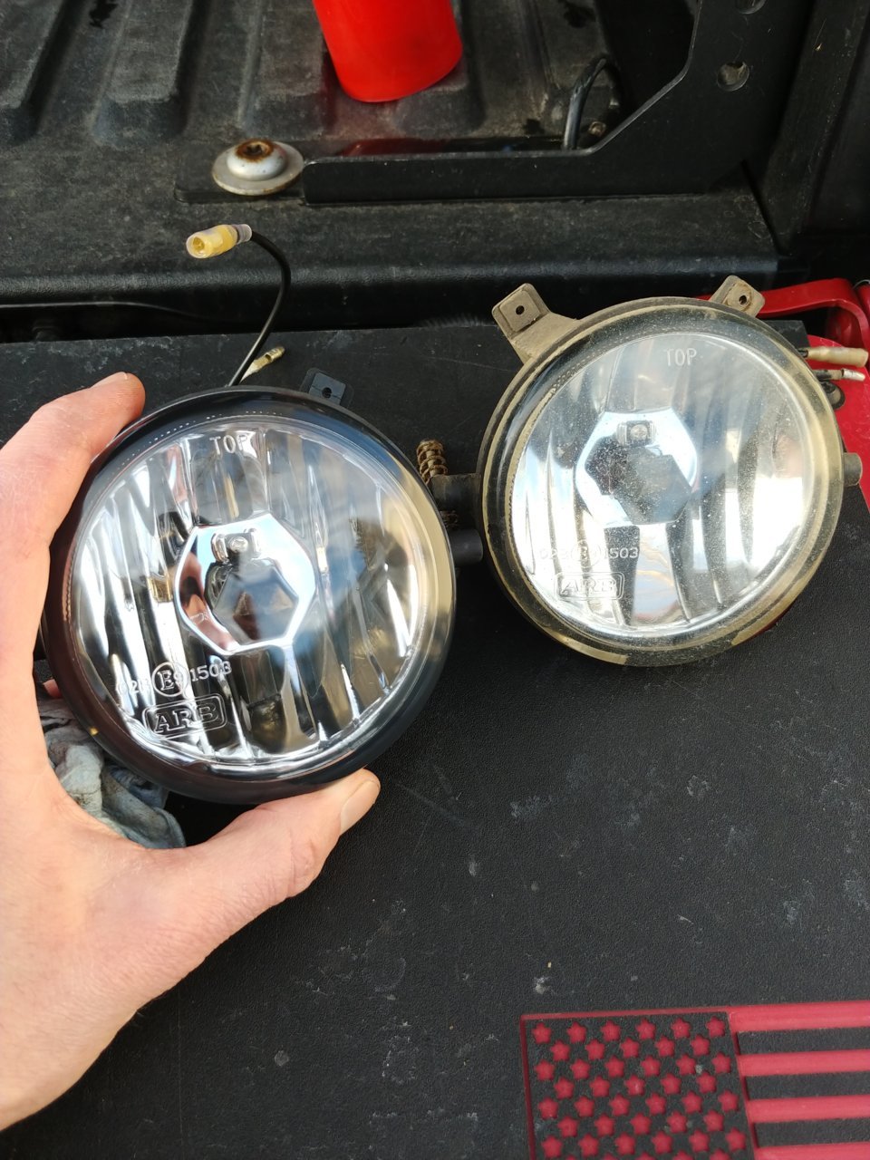

    Out with the old in with the new. A lot of that in the picture is just road grime not pitting of the lens, but its still amazing what a difference in brightness there is with the new ones
