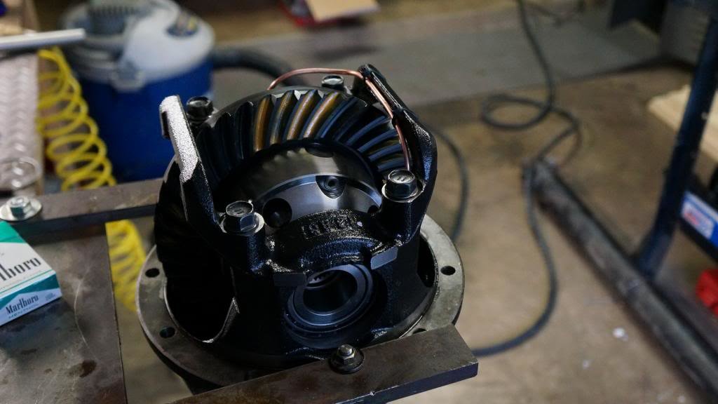

    I recently did mines, front and rear lockers with regear. For the front, if you don't want to do the install yourself, I highly recommend at least removing the diff and just taking that to a shop. I was quoted $500 to bring in the front diff for locker install. I ended up doing it myself though. With your truck being a little older, I would recommend regearing if you plan to, and to get new bearings. Check or east coast gear supply. I spent about 3g for all my parts from them.
