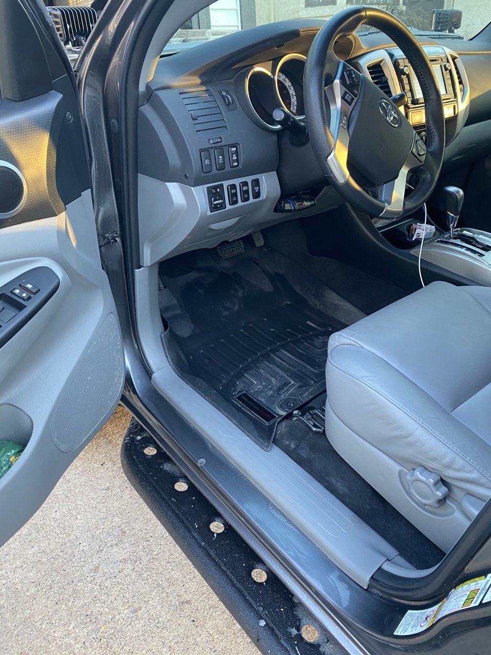

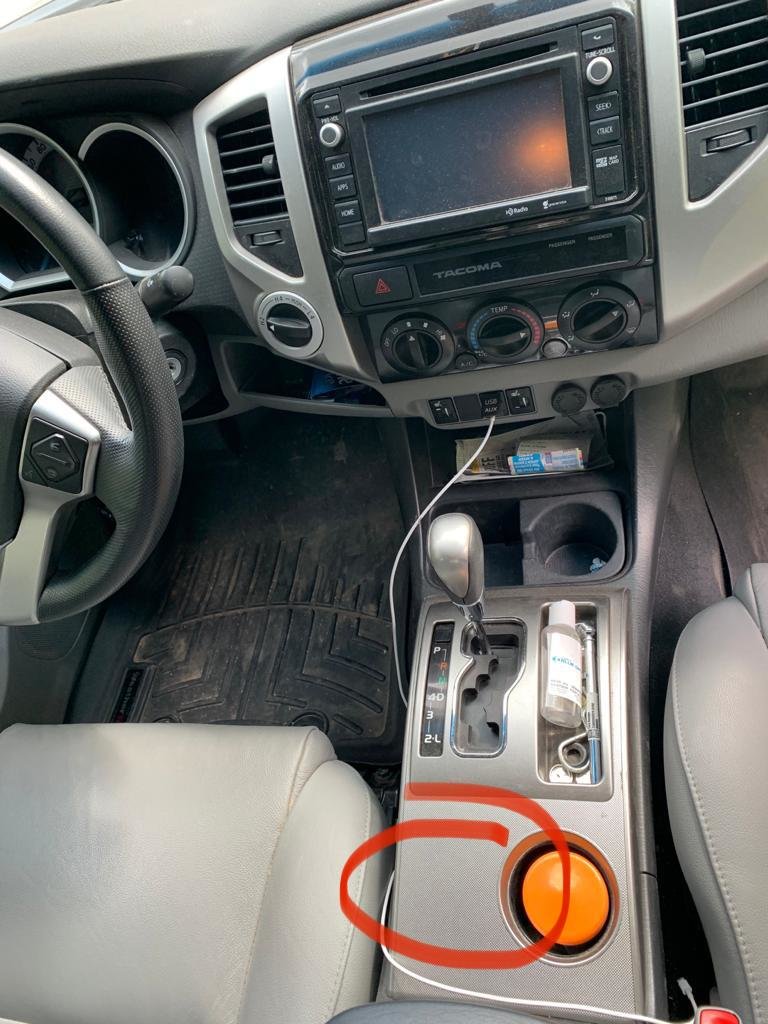

    im going ahead with front and rear. I have 2 questions. Where are you gonna have your switches for the air and lockers? I don’t have anymore blanks and I’d like to avoid going with a switch pro if possible.

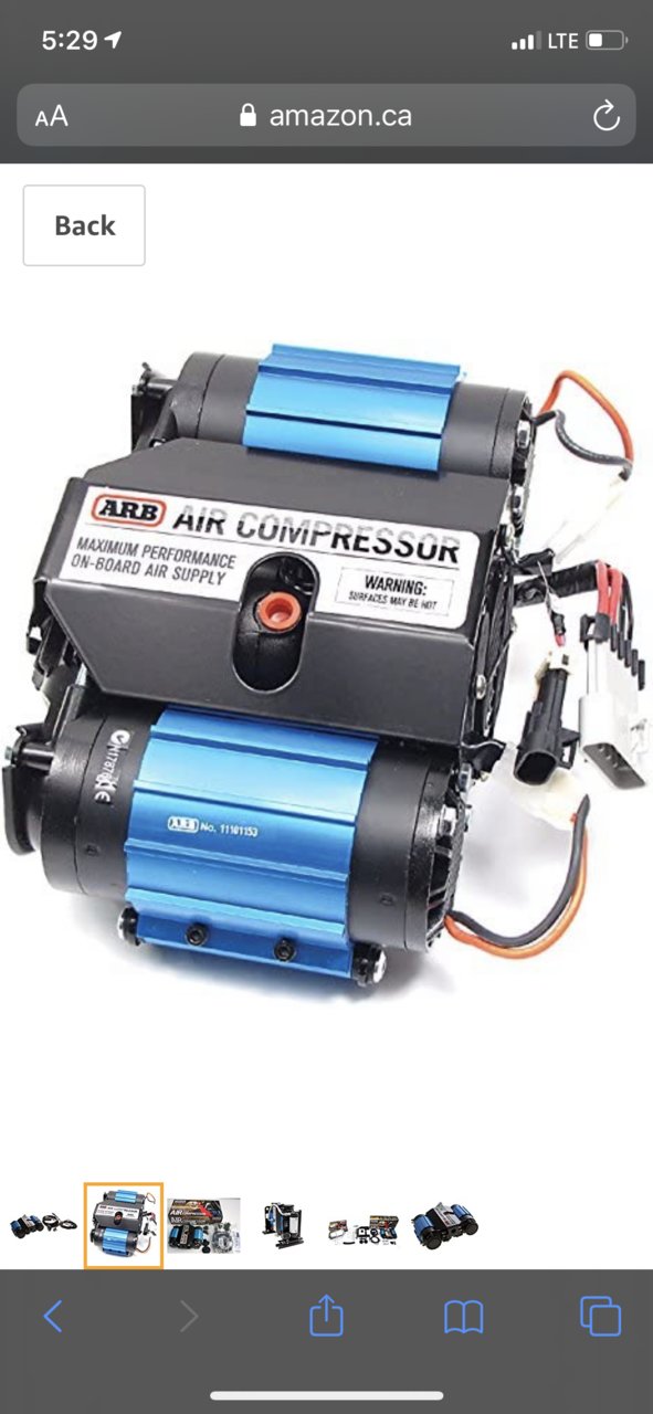

    Also where are you mounting the air compressor? I’m going with the arb twin compressor and it will be hidden inside the fender on the rear driver side. The quick connect will be inside the cubby storage area inside the bed on the driver side.

    I have an 06 with less OEM switches than you and was able to install all 3 next to each other in the stock blanks to the left of the steering wheel. Also have my compressor mounted where you have the air injection pump or whatever it’s called for the newer trucks.

    I have light switches installed in the 2 blank spots to the left of the steering wheel. No more real estate there. I have 1 blank left under the climate controls but that doesn’t help. I’m thinking to the left of the cup holder behind the shifter.

    I too have the switches on my 07 in the three blanks to the left of the steering wheel. My compressor is mounted on the passenger side near the washer reservoir, I built a bracket to hold it because I wasn't impressed with the aftermarket options.

    Who has a twin arb compressor installed in the newer models that have a smog pump? I mean besides the engine bay where else can it go?

    It can really go anywhere, there’s bed cubby mounts, some people mount them inside the cab. It’s up to you and how much work you want to do

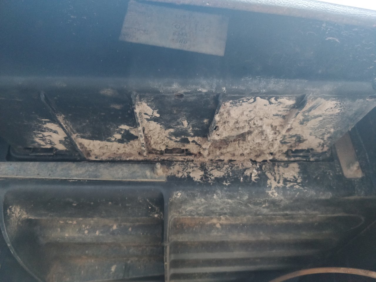

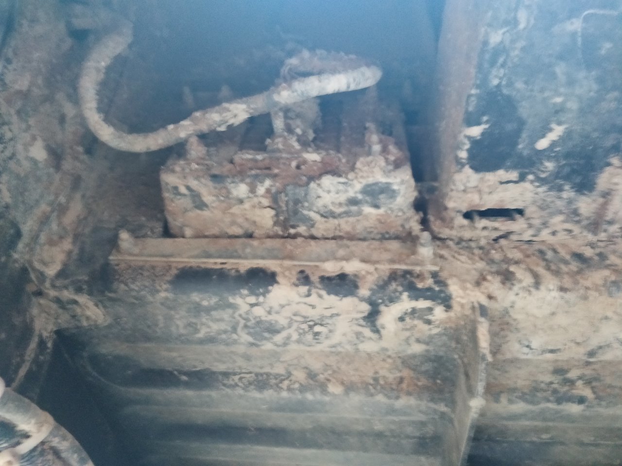

    I'd go with the Slee mount rather than the rear cubby mount. The compressor will be subject to much more dust, mud and water in the bedside than in the engine compartment. The Slee mount uses otherwise worthless space and saves you from having to buy an expensive harness to power it.
    My rear cubbies during a recent maintenance job
    The mud was also on top of the cubbies which means it would be on the compressor if I used that style mount
    shmabs likes this.
